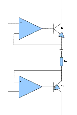

You want alternating current to flow though the load resistor. That means current must be able to flow in both directions through it. The problem is that current can only flow in one direction through a transistor.Be specific.
For example: the bottom of RL is connected to T2, so T2 can pull the voltage on that end of RL down, but there is nothing in the circuit that can pull that voltage up.
Similarly, T1 can put current into the top of the capacitor and lift it's voltage up, but there is nothing to drain current out of the top of the capacitor and pull it's voltage down.

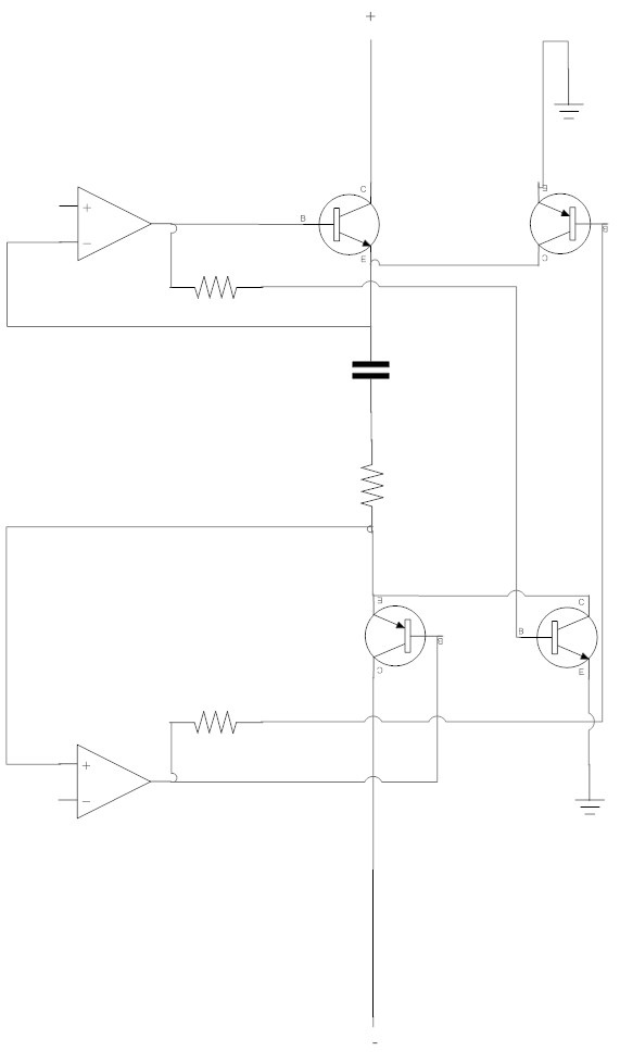

remind me then of the purpose of this thread? did you just 'invent' the differential power output stage?I do not want to do the effort just for fun
you really should... oh and btw i really dont appreciate being linked to your page full of advertisements and unending wall of text. i would suggest you have a look around the site, but it seems you are not interested in improving your knowledge of high quality audio systems application, yet i'm not quite sure what it is you ARE interested in doing here.cant read comments, there may be mistakes in the above post, i'm not sure, i will check when i have time.
I really think if you arent just 'doing this for fun' you ought to check if you are wasting your and other's time.
Interesting design, Steven. Much new thinking in using class C output stage. The latest output topology will probably cause a fire and if not some blue smoke.
True. I got screwed. Excuse: Thinking a of differential and not of physical possibility. Second excuse: I have been saying here and there: "...if physically possible...". Third excuse: overlooked.
The reason why transistor symbols have arrows is to define the only direction for the current to fly. Same as diodes.
Remedy without thinking: resistor to + and resistor to -. Lowers the range. Possibility: transistor to + and transistor to -. Havn't thought. May be possible. May think in a while.
I haven't read what you have posted. Looks like you are trying to cover up. Thanks. No need, though. I screwed up. I am not sure what I have been thinking because I have been thinking a lot of other things related. Childish mistake. Put something in the reply as a recovery.
In case you want the truth: yes, I thought of this a few months ago and I disregarded this opssibility because of the stated reason. Then I forgot. I cannot prove this truth, though, so a screw up is a screw up. The interesting part would be whether I would be able to recover from this screw up.

I like your first reply. The load is tiny. However, the system may be able to get balanced.
An issue is the DC which, in theory, must not be present but, in practice, this can be made tiny.
Obviously, a capacitor will solve this problem. The trick is to avoid a capacitor.
In regards to your second answer: NO. I HAVE NOT TRIED THIS IN PRACTICE. The calculations are pretty basic. I may have made a mistake but the idea is the "thinking" behind the calculations.
OBVIOUSLY, YES: AN ERROR IS AN ERROR. Analysis may try to mitigate the understanding of the effect but will NOT correct the error.
When I was doing this schematic, I noticed the switch (I had known from before) but I DISREGARDED the error caused by this because I have never believed the operational amplifier would be so slow not to switch with a negligible error. In other words, I said: OK, there would be somethiontg. I believe negligible. Not worth thinking. Go on.
I have been forced to think by the responses in this forum. I have been resisting to think into this particular issue. Once the issue was directly put out, I have had no choice. So, I have been trying to do something to correct this error because this error irritates a lot of people.

Have you verified your calculations by any tests in real life?
I think I have discussed 2 resistors in the emitters and a load to ground. This decreases the range though. Also, as depends on the applications, these resistors must be high power. True low value.
