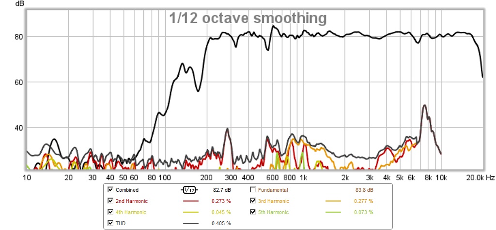

Here is combined response from the mid and AMT with EQ showing the HD - some of it from foamcore panel vibrations (can be reduced with second layer of foamcore bonded on with latex caulking):

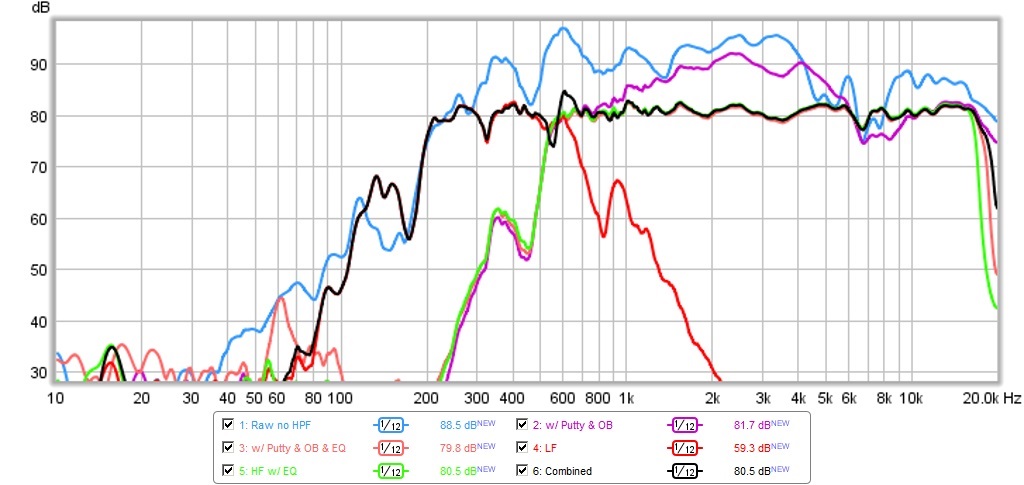

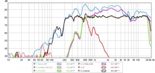

Here is the set of responses raw and with EQ etc, showing all the sahping required in DSP to get it flat. I try to only use attenuation filters, no boost (or if needed, very minor):
I think with careful throat design and improved injection slot ports etc, much of this can be smoothed out. As a quick and dirty demo with DSP, it works very well. Still the best speaker I have heard.

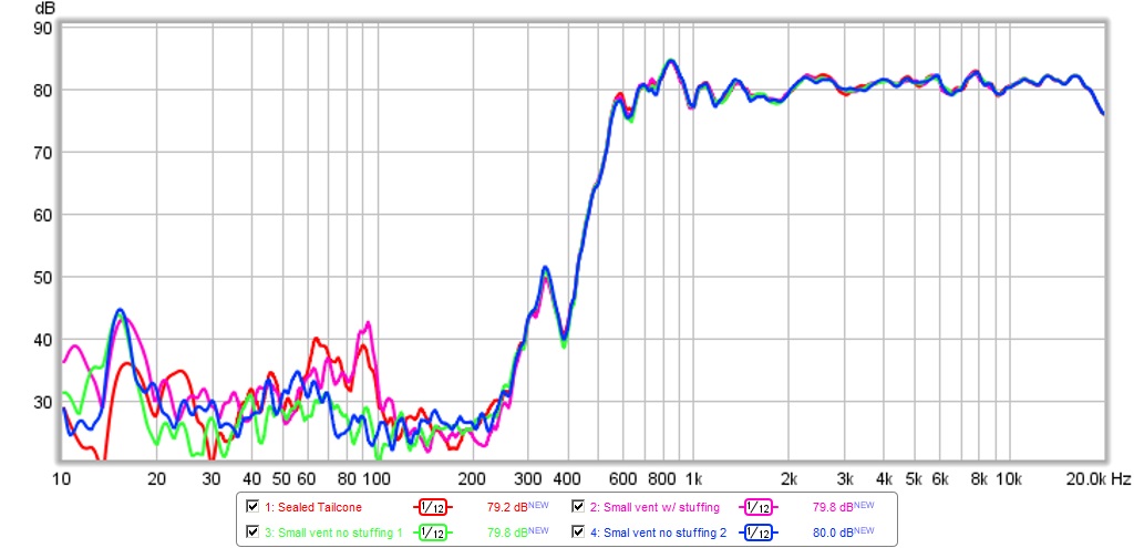

I also looked at the effect of the tailcone or Dagger on the rear wave of the AMT, and in the end went with sealed and stuffed as it reduced the phase wrap:
Thanks for sharing the plots.
Based on what you said, OB might work if there's a large enough barrier for the mids and the driver has a powerful enough magnet to fire into the port effectively.
I agree with eq being used largely for attenuation. I understand that even audio mastering (where there is no mechanical consequence for eq boost) uses the same principle.
