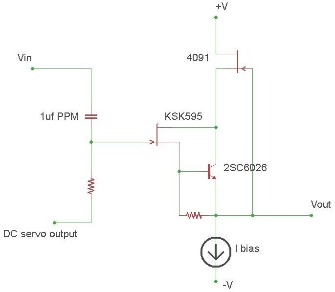

Here is a very simple SS buffer I use. It allows me to use 1uf polypropylene input cap. 1uf PPM cap is reasonably sized to fit onto a PCB and not act as an antenna. "I-bias" is simply a Jfet bias Idss (Vgs=0V), a few mA or so. 4091 is like a J111 and has realitivily high conductance and Vgs is about 6-8V at a few mA.
Thanks for the posting! This is what I 've waited to know! 🙂 The concept used, although not the form, is exactly the same i've used in my buffer! 🙂.
Piercarlo
Piercarlo
Good circuit but require the use (and even a coarse selection) of two JFET, a device which is progressively fading from the market, at least in other form than the SMD format, Even more require an addictional servo with its own circuitry.

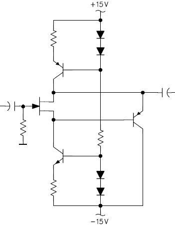

Scott Wurcer published this circuit a while ago
Not well refined (a bit cervellotic instead and even circuitally inconsisent: pheraps because is likely to be just a sketch to be evolved further🙂 as those reported by you before.
