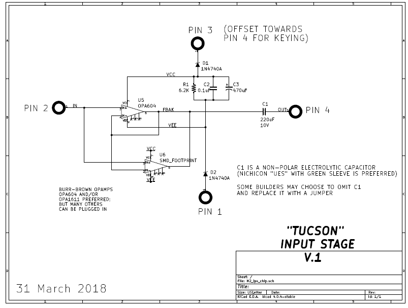

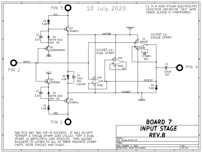

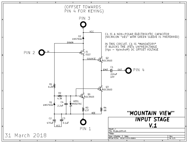

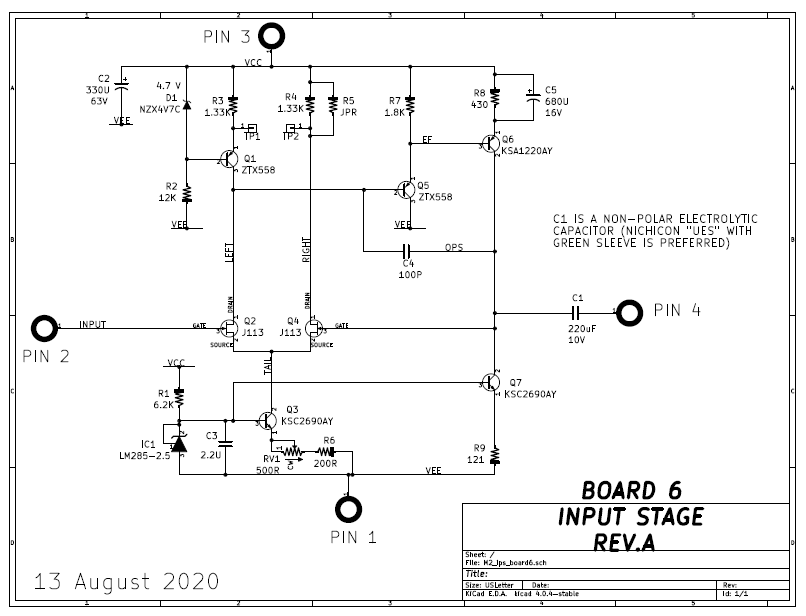

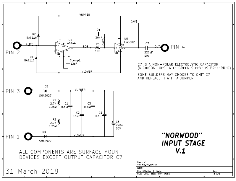

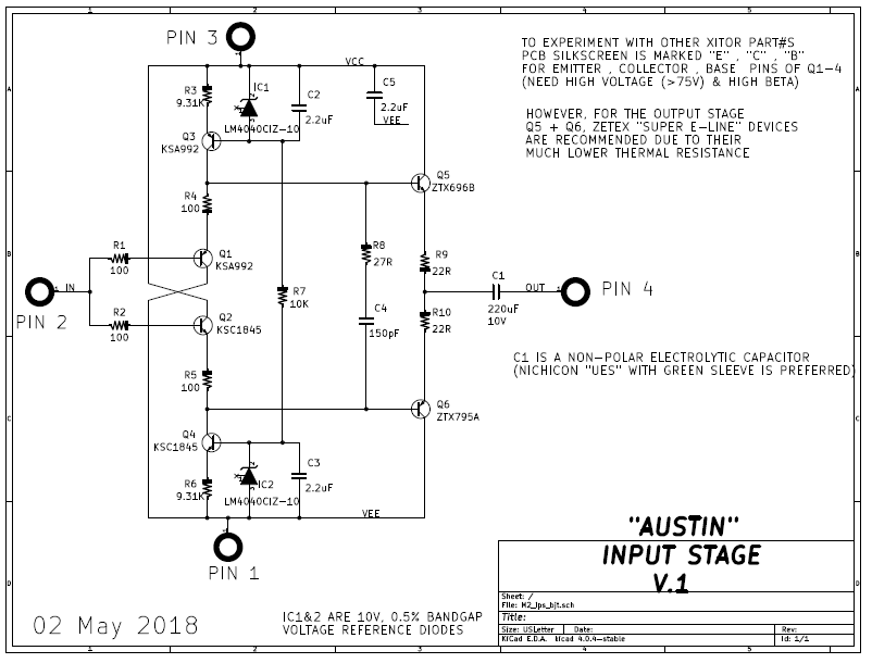

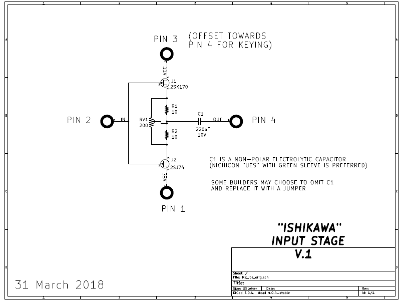

Here are some unity gain noninverting buffers which many diyAudio members have built and enjoyed.
Each one has exactly four I/O terminals: +22Vdc , Input , -22Vdc , Output . There is no connection to "ground". None at all.
You can adapt them to different supply voltages fairly easily; "Tucson" and "IPS7" demonstrate two possible approaches.

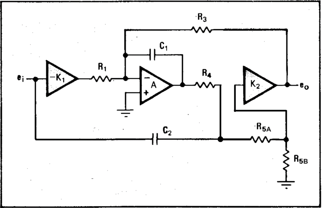

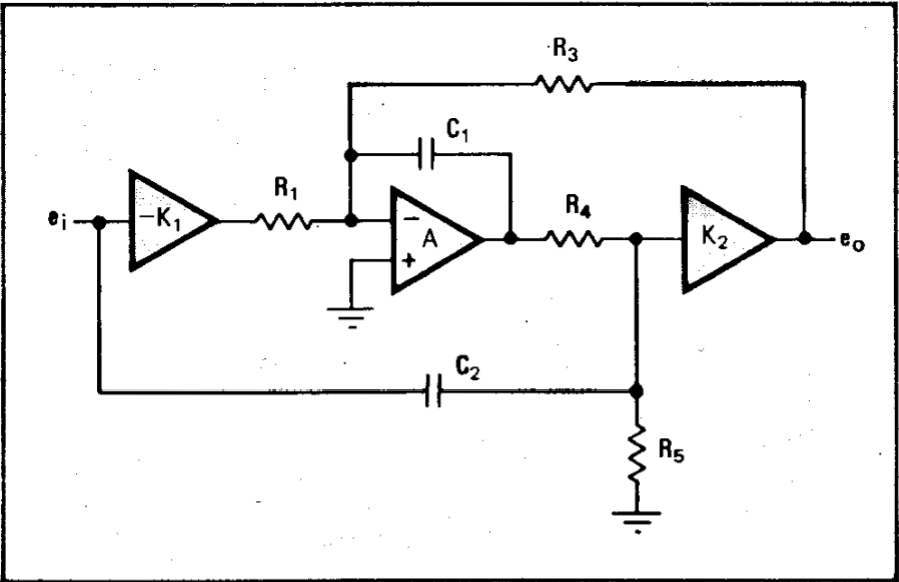

So here is the circuit I am working with. It's the Bainter notch - see attached. Amplifier K1 is an inverting stage of arbitrary gain, and K2 is a non-inverting amplifier (the details of these are not shown). The notches are not the usual symmetric form - they are the lowpass and highpass forms. See Figure 4 of this AD app note for more info:
https://www.analog.com/media/en/training-seminars/tutorials/MT-210.pdf
The application consists of 2-4 of these notch filters per HP or LP filter, the HP and LP being used in pairs (for a loudspeaker crossover). The issue is that in order to get DC unity gain in the LP form of the crossover file the gain for K2 must be less than one, which is impossible for a non-inverting op-amp based amplifier.
To get around this I came up with the modification in the image "MOD 1". I simple tapped into R5 midway to ground, to create R5A and R5B. In this way I can use a non-inverting voltage follower (gain=1) for K2. This can work just fine I guess, so it's still possibility. It's why I was asking about a simple unity gain buffer. This would leave 2 op-amps for the other amplifiers, making a nice round number per Bainter notch.

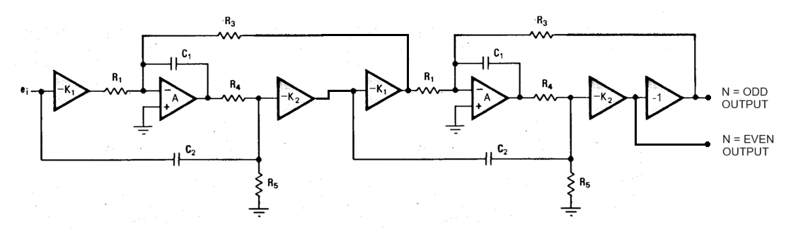

Now let's move on to the larger circuit shown in the image MOD 2, which is two notches in series with some new changes. I realized that for my application I will use N of these notch filters in series. Recall that K1 is just an inverting amplifier, so it's output is proportional to the input. I realized I could change K2 in the first notch circuit into the inverting configuration to give me gains of less than 1. But then the polarity for the feedback circuit containing R3 (from K2 to A) would be the wrong polarity. But if I move where the loop begins to the K1 output of notch circuit 2, the polarity will be corrected. But if the gain of that K2 is not unity I will also have to scale R3 proportionally to that gain so that the current is correct. Does this make sense to the reader? This modification of the R3 feedback loop would continue onwards as additional notch circuits are added in series. The last one requires an inverting amplifier to restore the correct polarity (I show this with gain of -1 but the gain is arbitrary as long as R3 is scaled to match). This would be another place where a simple voltage follower could be used.
There is another thing I realized about this circuit. The RMS voltage of the signal after amplifier A can be up to 5 times greater than for the input due to how the circuit works. This means I need 5 times the voltage headroom for A, but not for K1 or K2 amplifiers. For this reason I am considering bootstrapping this amplifier, or using one that can handle +/-24V rails, which should just be enough to work with input signal levels of a couple of volts RMS.
These circuits with N notch filters in series are used in pairs, one for the HP filter and one for the corresponding LP filter so there will always be 2N amplifiers used in the crossover. I could use dual-amplifier packages to handle the "A" amplifiers, for example, no matter the number of notch circuits that will be used in series.
