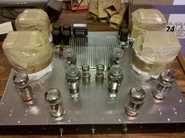

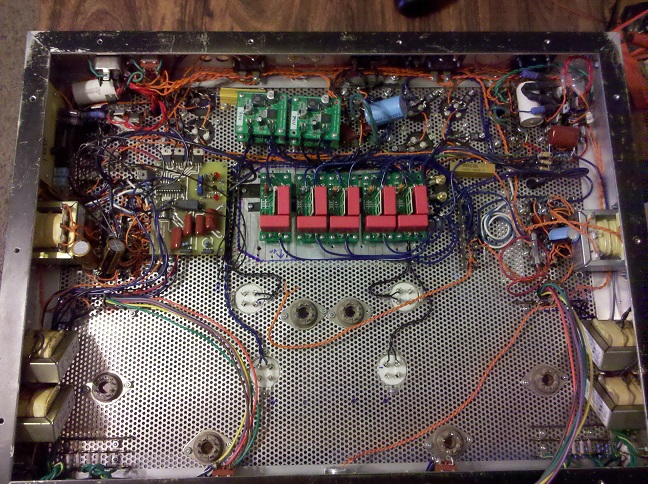

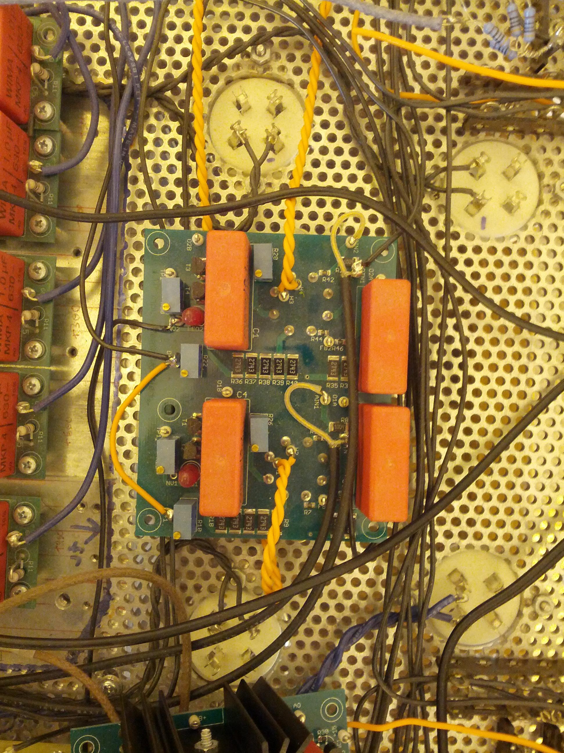

I designed and built an autobias board (around the "Broskie auto bias" curcuit, see this thread) for this amp. I have yet to wire it up and test it.
I also build a board for the output tubes that includes the source follower grid driver and mosfet-follower based screen regulator (since it needs four individual floating regulators for this amp). I implemented current limiting on the screen regulator since it was only an extra couple of resistors and a BJT. Now if I drive the tubes into saturation the screen voltage will just sag instead of making the screens glow.
I will be posting some pics and test results as they come.

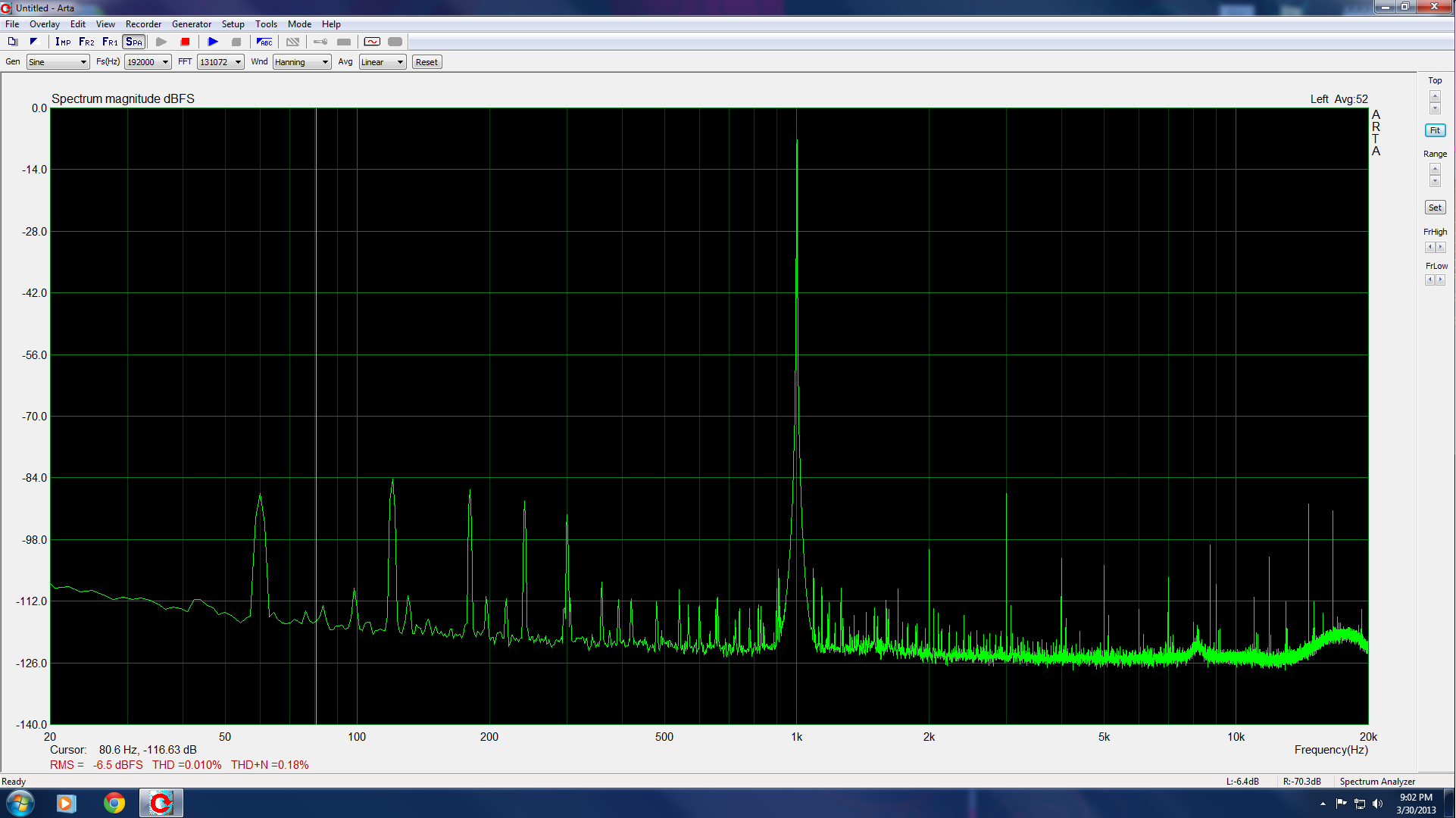

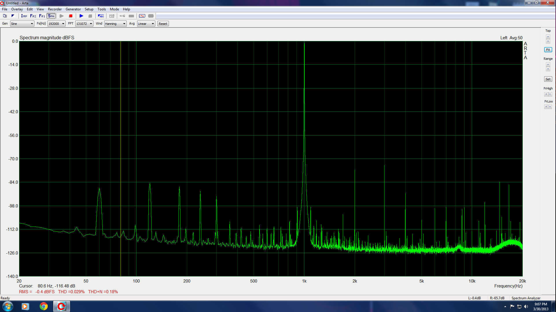

I finally got the input board for my amp installed and tested a bit. My sound card is kind of crappy. These measurements were taken at the output of one plate, they are not differential measurements.
I was surprised at how the 3rd harmonic was dominant. I expected 2nd to dominate. Are these good results for a first stage? I have no basis for comparison as this is my first amp.
Edit: First picture is 1Vrms in, 9Vrms out. Second is 2Vrms in, 18Vrms out. Third is ground for reference.

I would not worry about 3rd and 2nd harmonics at this level. They are so small and in a well made PP the even harmonics are going to cancel anyway.....
I would rather see the effect of those supply harmonics at the output as function of Pout. They can be small at low output (or at the input stage as in your case) but increase quickly as the Pout increases. This because the IMD harmonics are multipied by a term which increases with the power given by the harmonic itself (i.e. 2nd harmonic increases with the square of its "gain" coefficient, 3rd harmonic increases with the cube etc...). So a very small intermodulation product can become important (or even dominant) at higher output level. The IMD 3rd harmonic is usually the nasty one.
Thanks for the thoughts, 45. I realized that I had never measured the output of the cheap DVD player I am using as a generator. It seems like the majority of the higher order crap and a significant amount of the lower order stuff comes from the source...
