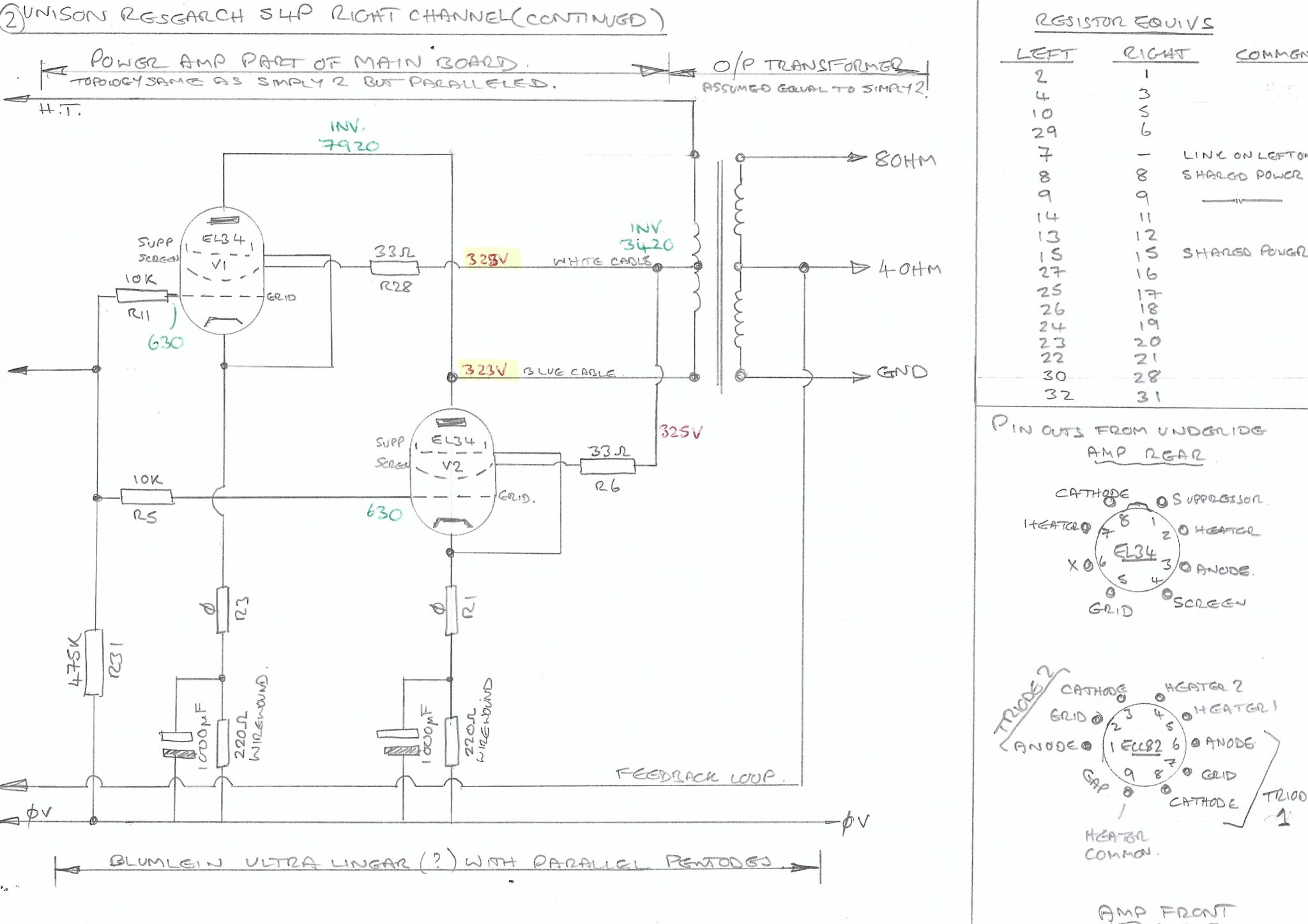

I can't contribute much here but I did find on the forum an official schematic for a Unison research Simply 2 so thought it worth showing my schematic for a Simply 4 Pentode (S4P), reverse engineered from my amplifier. I have worked on electronics over the years but not for some years and have little formal training. I've just dug out my Valve Amplifier book by Morgan and will try to understand this better. The schematic may help someone else in the future so I'm putting it here but, I made it really just for my understanding. I believe it's correct but am very happy to be corrected in any parts of my understanding as it's been a while since I've looked at these things. The S2 schematic helped me to get started but it isn't the same.

First half of the schematic shows the PSU and pre-amp stage.
After replacing the resistor, I measured the DC voltages and they are shown.
I also ran a small sine wave signal (1KHz and 10mV at the input to V6) in to check stability of the signal with the scope - values in green
The PSU seems clear to me - I didn't look into the mains transformer.
V6 is (as I recall) a standard cathode bias topology (only triode 2 shown here for the right).
V5 triodes are in (I think) a Shunt regulated Push Pull configuration. There is a feedback loop here.
The second half of the schematic shows the HT, signal, feedback loop and ground from the first sheet.
The EL34s are in parallel and I believe this is an ultralinear (Blumlein) configuration. This is the same topology as the Simply 2 but with paralleled valves.
On the right are my resistor equivalents and my notes on the valve pin-outs (as I say, it's been a long time).
Any comments and corrections would be gratefully received. It's been interesting to go back and try to understand this after so many years but I'm not expecting much feedback. I just thought that the next time someone searches for this schematic, they will have a start.
