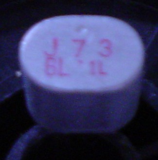

The so called 'diamond differential' is something that we also developed as an alternative to full differential, back in the mid '70's. In those days, like once again today, p channel devices were not as good as n channel devices, especially as duals, and they were much noisier. The 'diamond differential' topology could also be implemented as an all fet design as well. This is how I did it, back then.
As low noise p channel jfets became available, first from Hitachi, then Toshiba, with the 2sj73, it became easy to make preamps and power amps with a true complementary differential jfet input stage, and Hafler, Krell, and just about everybody else, followed the early Levinson lead.
A few years later, these parts became nearly impossible to purchase, so many manufacturers went back to bipolar parts, strictly for practical, commercial reasons, where they remain today. It is almost impossible to second source a Toshiba jfet, especially the p complement. Therefore, it is impractical for many large manufacturers to use Toshiba jfets.
Parasound has used Toshiba jfets for at least 15 years straight, but we are running out of them as well. We will have to wait and see if there is a good solution, in future.
