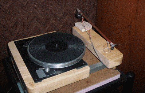

hello folks, I'll "weigh in" here...
sreten...seems we frequent similar pages and topics...are you my long lost "twin"?😉 .I may no jack about electronics, but I do understand mechanical things pretty well.
First, EC8010, your unipivot is quite beautifully done. The headshell and arm tube are things of beauty and you should be proud of them (I hope you are).
I've built a few tonearms, non of which are what I would call "stellar, but are refinements to Charles Altmann's DIY tonearm. They have all sounded great.
My considerations in terms of centre of gravity, pivot location, etc are pretty "straight"(sorry for the pun) forward. I locate the pivot on the "top" portion of the arm tube (above the centre of the arm tube). This places it above the plane of the record when playing. I hang the rear weigh so that it is slightly below the plane of the record, to ensure some stability. Because the CofG is lower than the pivot it is quite stable.
An addition could be to hang some sort of "outrigger" weight at or near the headshell. That can provide some lateral stability and help with adjusting azmuth as well (somebody else's idea , Dynaco? Hafler?). it increase the inertia required to upset the headshell while playing.
attached is a picture of a re-plinth of a Sugden Conny, with my tonearm on it. It looks crude but makes some pretty beautiful noise. 12" effective length...
stew

Hello Nanook,
yes, I'm pleased with my arm; making that headshell was a lot of work. Yes, I seem to remember outrigger weights either side of the headshell too. However, having found that even a finger lift rings, I'm not wild about deliberately adding something resonant. Where's your picture?
