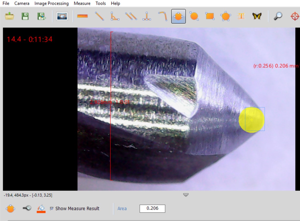

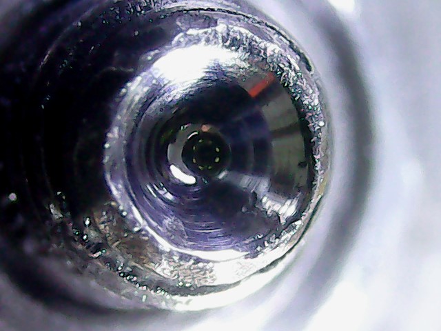

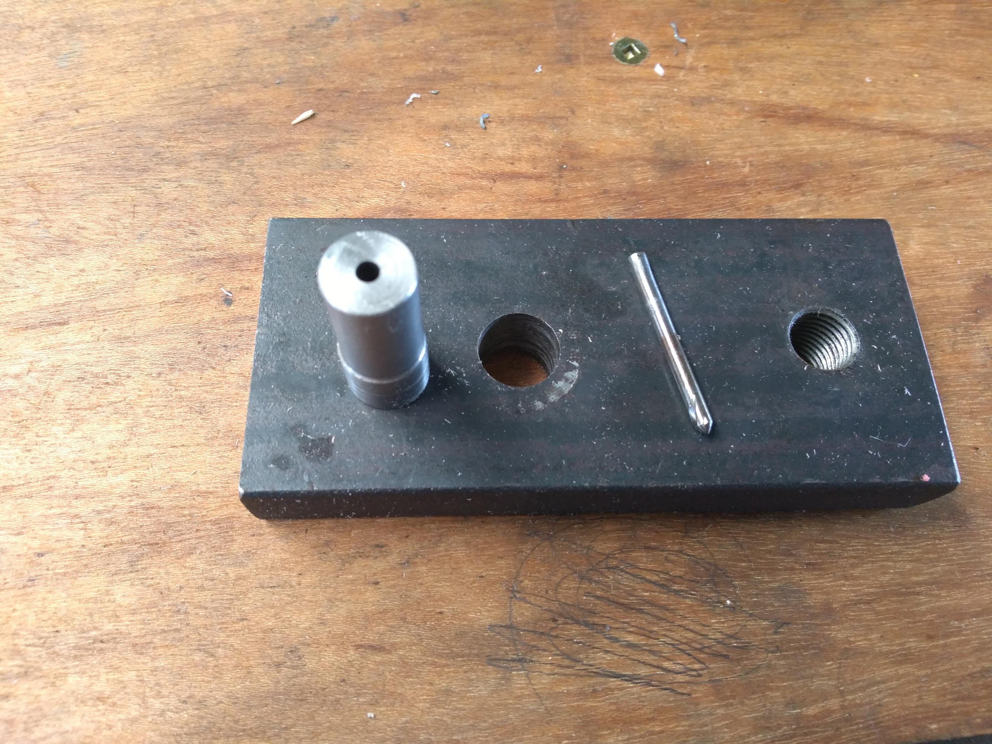

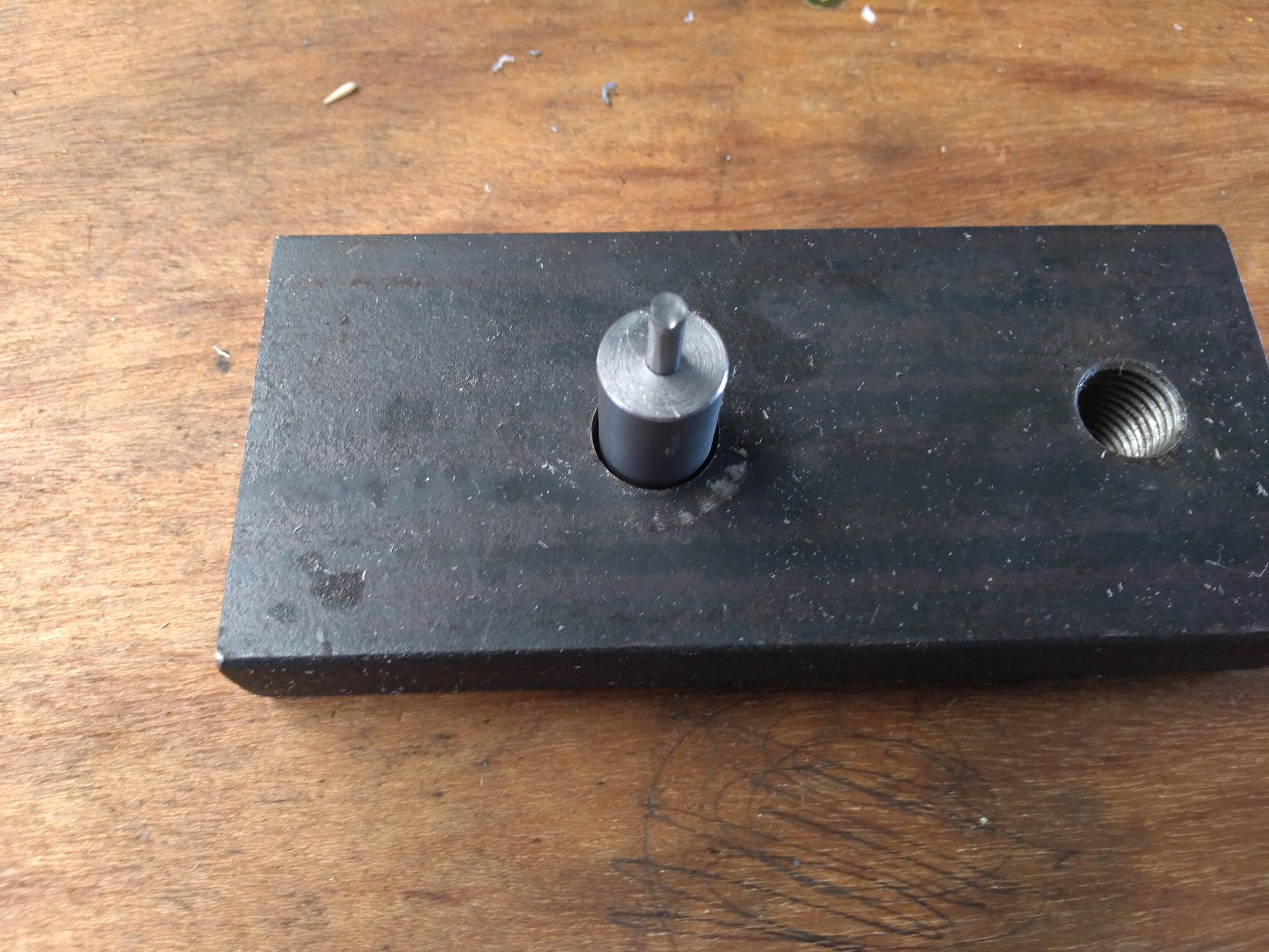

The setscrew idea will work. I used M3 setscrews as the pivots for LTA carriage. These were grade 12.9 so already hardened.
To make the radius I used an old drill bit and cut off most of the flute. I then radiused the end to use as a forge. The M3 setscrew screws into the bottom of the shaft, put the jig on the vice and hit the end of the drill with a hammer.
This forges the radius in the setscrew hardening it further. I then used a tooth pick in a hand drill and diamond paste to polish the radius.
Photos in order. Drill forge with 0.2 radius, forge jig and drill, forge ready to hit, pic of the polished radius in the setscrew, its so highly polished you can see the reflection of the microscope in it.
Keep in mind if you use the ball point pen as a pivot pin you need to make the setscrew radius 3 times the radius of the ball.

S/s - silver steel or stainless? There's stainless and stainless, some hard ( I've got some work hardening stainless at work, interesting to machine....but ideal for a uni-pivot ) and some is soft, like really cheap cutlery - possibly some lead in the mix. How long is it going to be? - sometime I'll get around to making a 14" duel uni-pivot.
Thank God ylu included pictures, I was so lost! But now seeing them it makes perfect sense. Actually wonder if I took a threaded thumb screw, used my drill press to start a drill hole, only go in say 3/16", use your hammer technique, then I'd have a thumb screw VTA adjustment!The setscrew idea will work. I used M3 setscrews as the pivots for LTA carriage. These were grade 12.9 so already hardened.

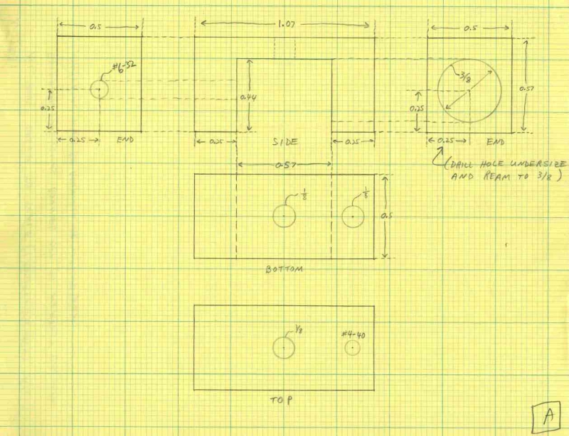

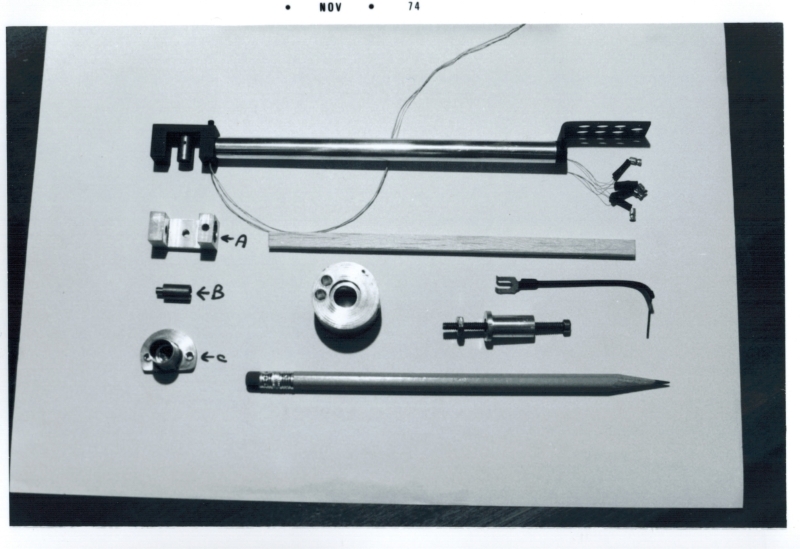

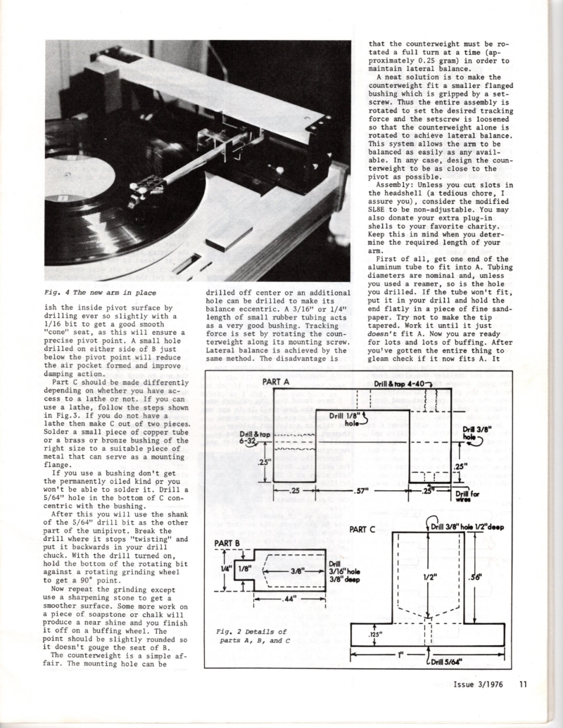

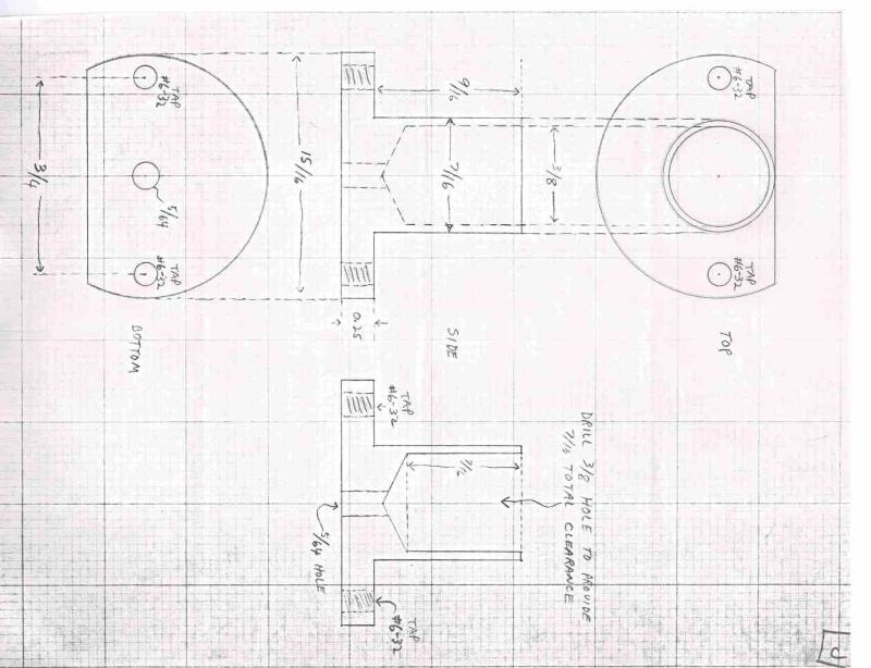

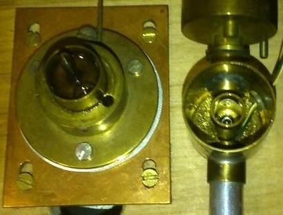

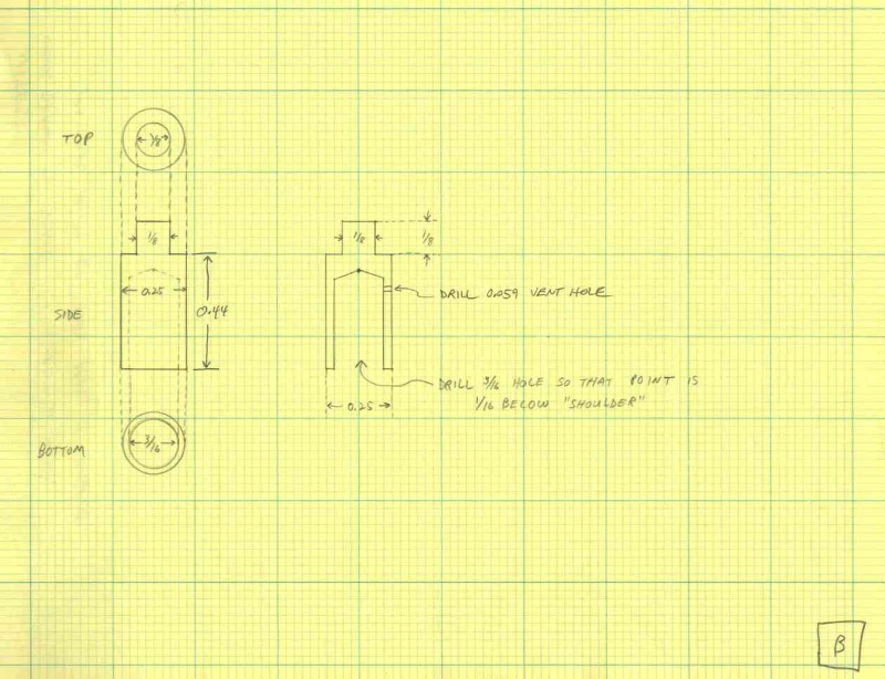

My apologies for being late to the party. I built my current unipivot back in the 70’s and it has worked so well I’ve found no reason to revise the design. It remains my primary arm to this day. I opted for the “hard/soft” bearing combination and used a high speed steel drill blank (hard) for the spike and brass (soft) for the bearing cup. I ground the drill blank to a point and polished it. The idea came from a Decca International unipivot tonearm that I had. The Decca bearing was a great design and it performed well for me. The Decca arm incorporated a judicious amount of viscous damping, which I found to be very desirable to have, especially in a unipivot.
I don’t have a good photo of my bearing but found this one on the internet that uses the same design concept as mine:
The base is a cylindrical metal cup with the spike press-fit into a hole in the bottom. The upper brass bearing cup is drilled/machined as a cylinder which sits inverted on top of the spike, and the arm assembly is attached to the top of the bearing cup. The base cup is filled with silicone oil so that the bearing cup cylinder sits in an oil bath. Movement of the arm causes the inverted bearing cup to ‘slosh’ around in the oil and that provides viscous damping.
My arm design was published as a construction article in 3/76 issue of The Audio Amateur magazine. I agree with @cracked case that this type of project is difficult to finesse without access to a lathe. I suppose the inverted bearing cup could be done with a grub screw that could double as a VTA adjuster, but changing VTA that way will also shift the center of gravity, and COG is important when designing unipivots. I’m very happy with my “hard/soft” bearing combination but if I had to do it all over again today I would seriously consider @moray james’ recommendation of using Nanook’s 219 ball point pen bearing. There are lots of good construction ideas in Nanook’s 219 thread.
I attached the TAA construction article along with my design sketches in case you might find some useful ideas there.
Ray K
All Parts:
Part A – Yoke:
Part B – Bearing Cup:
Part C - Bearing Base [spike]:
