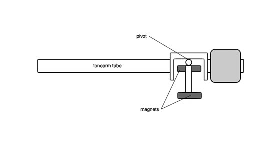

For awhile now I've been planning out a DIY tonearm. So far, a unipivot has seemed the best choice given my limited access to machining tools. However, the instability of unipivots has always bothered me. The standard ways that most manufacturers get around this, throwing a really low counterweight on, and giving the arm a high center of gravity, feel like sloppy workarounds.
So I've been dreaming about building an arm with a relatively high center of gravity, which would pretty much be free to tilt in any direction, and using magnets in some way to stabilize its movement. Graham does this with his newest tonearm, and its supposed to work very well. I think Grahams approach is out of my league right now given the tools I have, and copying his idea isnt in the spirit of DIY.

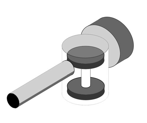

Recently, I stumbled upon an old patent in which a tonearm uses 2 opposing magnets to float arong a central shaft. While I don't want to copy this idea exactly, it inspired me to see if I cold use part of the idea. I've done a few drawings to show you what I mean:
The idea is to use 2 opposing magnets, and a normal unipivot. These magnets will be too weak to float the tonearm, but will provide a bit of damping suspension, and make the tonearm want to stay perpendicular to the record. The unipivot will be a downward facing jewel ball and cup. This way, the tonearm is still "grounded" so that vibrations have a pathway out.
I can think of 1 arm that uses a similar concept already, the Decca International tonearm, but it floats/damps the whole bearing shaft, not the tonearm itself. So the real question is, does anyone think that this will not work? I'm concerned that the magnets will not provide the stable support that I'm looking for, that the tonearm may wobble/oscillate, or that I'll still have to use weights or something else to help stabilize it, what do others think? I'm assuming there's a reason that this hasnt been tried before. If noone has any objections, I'll try to build a prototype to test out the idea.

Here's the fly in your ointment:
If the magnet arrangement is symmetrical about the Z axis then restriction of rocking motion will equally restrict movement around the (required) horizontal axis.
In theory you could arrange the magnets so that they were not symmetrical about the Z axis but you would have to be very, very careful to ensure that this did not mean that the damping changed as the arm moved across the record.

Interesting comments Mark Kelly, let me see if I understand you correctly. You're suggesting that if I make the magnets symmetical that the arm will want to remain stationary. And if I were to make them non symmetrical, then damping might be irregular, would this be caused by subtle changes in azimuth across the length of the disc?
woodturner-fran, I suppose this is supposed to be my "better" tonearm, I've already built a few, all of them sounded good, but I found the unipivot "wobble" and some small issues with azimuth to really bother me. So this is the 1st time I'm considering adding some sort of damping to rein them in. And building a gimbal arm is more or less out of the question...
