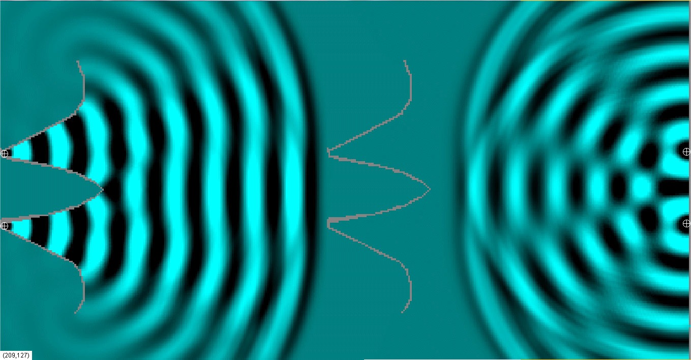

What do you think of this. The horns may not be ideal and maybe this helps in a not so good way, but does it make a point? (I wouldn't use this to design a horn, at least not the start of one).

The system design vertical directivity is limited so should you be concerned with nulls outside this?
Wouldn't it be better to increase vertical spacing toward this limit and use it to produce a waveguide that performs better?
You have to remember that this effect happens only over a very narrow bandwidth right at the crossover. You can't use it to "produce a waveguide that performs better".
The question is are the nulls wide enough so as to not be a problem. The lower the crossover the less of a problem it will be, but then the larger the waveguide needs to be. A smaller vertical dimension of the waveguide makes the crossover have to move higher and the narrower the nulls are for a given spacing. If you decrease the vertical dimension but do not raise the crossover then the device narrows (it doesn't widen until much lower in frequency) making the main beam narrower. This is simply not a problem for which there is a good solution, although, if you defeat the floor and ceiling reflection s like I do then it is not an issue (unless the beam gets very narrow, which need not be the case in a proper design.)
