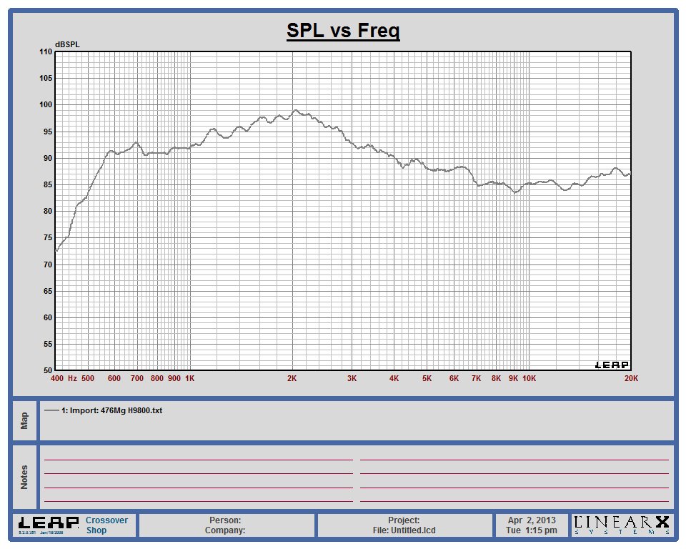

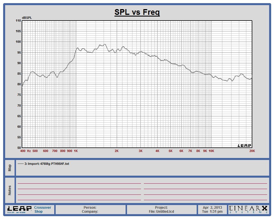

I am well aware of all the issues you raised and have tried CTC too. On paper it certainly seems the best "one seat" solution if the recording itself allows.
Yes but in my comparison the PT waveguide had a much smoother response, whereas the H9800 needed a lot of EQ (its off axis response was also much more ragged...). But yet, once everything was equalized the H9800 seemed to sound more "dynamic", whatever that means...
You're right - That was not the best comparison.
I was mainly focused on your suggestion that equalization didn't solve everything. I agree with that statement, and commented about it. But I think you're right that the comparison didn't work because the PT waveguide is a fairly smooth device. See the attached response file, for example. Its peaks and dips down low aren't too bad, pretty much done by 2kHz, and need no tank circuits to "tame." In truth, I like most of the PT waveguides, most behave pretty well.
But then again, the H9800 is pretty smooth too. I've attached its response curve - using the same compression driver - for comparison. I wouldn't characterize it as having jagged response. I'd say it is, in fact, slightly smoother than the PT waveguide. It probably presents a better acoustic load towards the low end.
Each has a slightly different response, so the response shaping circuits might be different, but both show a general trend of mass rolloff. The H9800 has a little more up high, showing it has begun to beam more in the top octave. But it has better acoustic loading down low, which is demonstrated by the reduced ripple below about 3kHz. I think most would be tempted to deal with its output at 2kHz with a broad filter of some sort, but it doesn't appear resonant. Looks more like increased efficiency before mass rolloff.
Anyway, that's all a digression. The point is while you can equalize out all the ripple of a peaky device, that doesn't make it sound good. Equalization doesn't solve everything. The examples you've used - a JBL PT waveguide verses the H9800 horn - is an example where both are actually pretty good.
I understand your point that you liked the sound of the H9800 better, but we're still talking about two horns with pretty smooth response. I think it would be an even starker difference if we were comparing a resonant horn with a lot of periodic ripple to a smoother non-resonant horn. In that case, I find the qualitative differences are even greater.
There are some waveguides out there with response ripple all the way through the passband, and adopters usually use notch filters well up past the crossover frequency, basically through the whole band. That kind of thing goes more to the point.

Nice measurements Wayne!But then again, the H9800 is pretty smooth too. I've attached its response curve - using the same compression driver - for comparison. I wouldn't characterize it as having jagged response. I'd say it is, in fact, slightly smoother than the PT waveguide. It probably presents a better acoustic load towards the low end.

Regarding the PT, mine is the rectangular version (PTF95HF), with not as good a vertical directivity control, but quite a bit shallower than the square version.
My measurements do not have the same resolution as your down low (I have to use gating, so I start to loose resolution under 1.5kHz) and did not show what you are showing here.
The main grip I have with the H9800 is its strange "ultra-wide" directivity behavior in the 3kHz-8kHz range. Did you measure it?
I found that putting layers of foam on the sides of the horn (not around, but actually *inside* the horn, along the lateral walls!) did improve on that, but I did not pursue...
Those weren't my measurements, those were from Audio Heritage. Tons of charts over there for JBL gear, and plenty of 'em are of PT waveguides and H9800 horns using various drivers. Most show general agreement with other charts, with differences between compression drivers, of course. I was reasonably comfortable dredging up those particular charts because they showed general agreement with others and because they showed a PT waveguide and an H9800 horn measured using the same compression driver and same measurement system. Passed the "sniff test."
