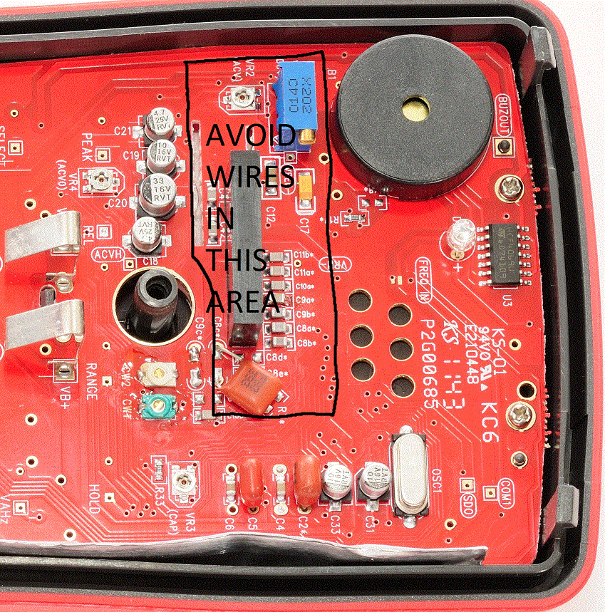

This mod based on ability ES51922 chip (the brain of UT61 series DMM's) to control backlight of display.
Here you can to see how it working UNI-T UT61E DMM Backlight via sensor control - YouTube
Now if you are going to built this project, the several important points:
1. Strictly avoid any wires placed near sensitive input components. See picture.
2. Clean up you sensor chip assembly from any flux residues. Even no-clean flux not allowed to stay here.
3. Resistor R2. This should be adjusted to supply your LED's with proper amount of current. The value shown (33ohm) in couple with AMS1117 LDO will give 18mA through LEDs.
4. Photocuplers. Used to decouple DMM circuit from noise coming from sensor chip. Try to get LTV-817B, LTV-817C or LTV-817D.
5. Chip U3 on schematic is AMS1117-5.0, but any 5V output LDO can be used.
6. For wiring or PCB layout of sensor controller please follow all recommendations given in datasheet.

Hi Tolik.
Great mod!
I'm planning on doing it in a similar way but I have some questions:
You're using the photo coupler to separate the touch sensor from the chip but it's still connected to 9V. Isn't it bad to have the noise generated by the touch sensor on the meter's voltage supply?
Why use the ES95022 at all? You can use the 9V to drive both your touch sensor and the LED's so there is no need to use the chip. The only difference is that it beeps when you switch on/off the backlight.
Hope you can answer my questions.
Hello Nisei,
My circuit takes voltage from the battery terminals, so noise of the sensor IC is held maximally far from the sensitive loops. Of course you can to add either inductors or even LC network to be an over confident. But my DMM, with that mod, as is, working well.
From the other side, UNI-T will never be like Fluke or Amprobe ...
It native controls the LEDs ON time, and ON/OFF functions.
