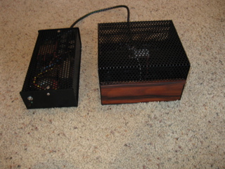

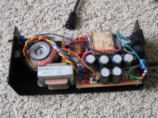

Final note on the chassis. The 3A5, being a DHT with a very thin filament, is microphonic. So it requires some isolation from vibration. The anodized aluminum frame that holds the tubes and regulators is like an inverted T bar. It sits on two reticulated foam rails, about 2x2x10cm. You can see these (grey) in post 19 and 20 if you look closely. Other methods, such as suspending the tube chassis, would work fine too, as will other dampening materials. I have felt feet on the body of the outer chassis. This combination seems to eliminate microphonic noise, unless I tap directly on the chassis. Even then, the ringing is quickly damped.

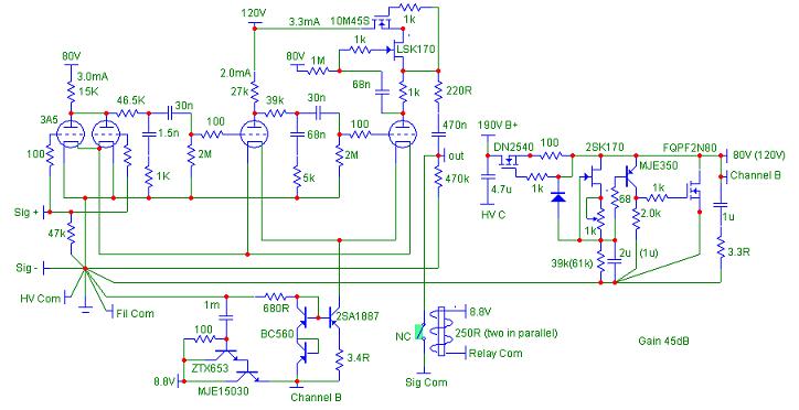

How much standing current the depletion CCS runs in the reg for Rs=200R?
Actually, I forgot to change that. It's 100R now, and about 30mA standing current.
Sheldon
Also noticed another change. I no longer have any caps in the cathode circuit. Found I didn't need them with the filament reg.
Does it leave about 20mA to the reg after it feeds what it feeds? Must be arranged to leave at least so to work good.
Each channel takes about 5mA, total 10mA for both. So about 20mA shunted.

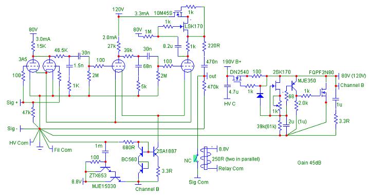

Updated Schematic:

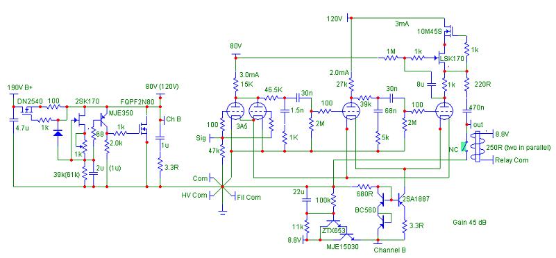

Another change to the schematic, one minor, one significant. I don't think I've missed any others, so this is current.
The significant change is the value of the bootstrap cap for the gyrator load on the output plate. I started with 8.2uf organic electrolytic. Then, looking at the resistor values, decided to try a much lower value film cap. That gave a much higher low frequency corner. Should have realized that, but I hadn't taken into account that the plate conduction is loading the circuit. The cap needs to be sized to account for the plate resistance (about 8k), and keep the plate at the same voltage as the FET gate. So, back to 8.2u, as there are already three low frequency corners (two internal coupling caps, and the output cap). I wanted to keep this corner low.
Minor change was to the current set resistor for the filament CCS. I decided to up the current so that the filaments are only slightly lower than spec. It's now at about 2.6V, vs. the 2.8V design center.

Wrong. Missed a big one. The cap multiplier in front of the filament CCS wouldn't be very useful as shown. It's actually as shown in this corrected version.

The microphonics are not a big issue, or I should say that they are pretty easy to manage. You do have to have a separate sub chassis for the tube section. And it should be isolated from vibration. My sub chassis just sits on some foam pieces, with no hard connection to its outer chassis - only the wires - and that works fine. You can hear it if you tap on the chassis or the stand that it's on, but it doesn't ring. If the tubes have a rigid connection to the outside world, it can go into feedback mode if the music is loud enough.
My guess is that larger tubes, because they have a larger filament, could be a little more sensitive to vibration. Fact is, I think this gives DHT's some of their charm.
If I turn it up and listen closely, I can hear little clinking noises at the speaker while the tubes warm up. Kinda interesting, actually. Sounds like you are hearing right into the tube. The clinks are not obtrusive (have to be right up to hear them), and become more infrequent as the amp warms up. After a half hour or so, they are gone.
You will want to select tubes, especially for the input tube, as some are a little noisier than others. But they are cheap, and I've found a pretty good percentage of good matches and low noise tubes.
