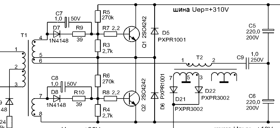

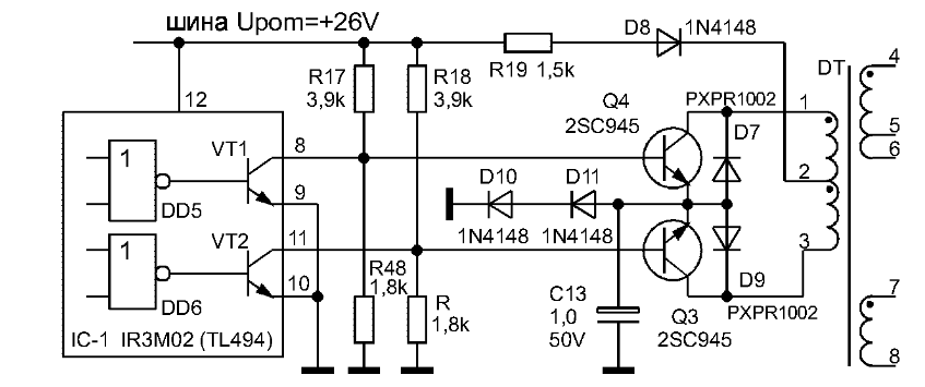

After the power keys in the power supply burn out, most often there are malfunctions in the key control circuit.
It is very important that the capacity of the capacitor C13 is stable. Diodes D10 D11 often break down, they are also important, transistors Q3 Q4 also break down and sometimes transistors inside TL494 break down. If diodes D10 D11 are broken down or the capacity of capacitor C13 is low, then the miracles that you see will also happen.
C7 C8 D7 D8 and also create the miracles that you observe.

All the diodes are perfectly ok.After the power keys in the power supply burn out, most often there are malfunctions in the key control circuit.

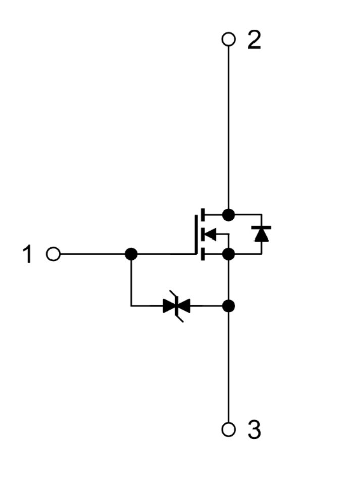

That would be for excess gate/source voltage protection. If the drive voltage is below the FET's G/S breakdown limits it shouldn't be an issue but I think you did mention transformer coupling for the gates... that could throw up some surprises so again you need to scope the drive to see what the amplitude and quality is like.
Remember the primary side will not be isolated from the mains so that makes using a scope more difficult unless you use isolation transformers.
