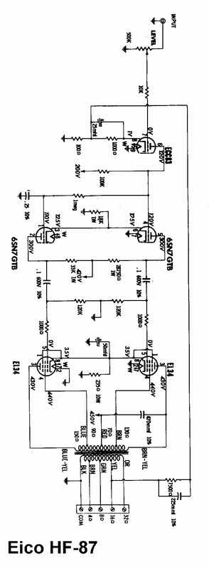

Actually, this is very common in a lot of classic iron where the two sides are not wound bifilar. The side of the CT which is farther from the core will have a higher DC resistance for the same number of turns. If the AC balance at bass and midband is OK, I wouldn't sweat it.
At worst, you might have to do a bit of compensation on one side to stabilize feedback, generally a small cap between the CT and the lower resistance end. Check out the Eico HF87 schematic for an example of this. Dynaco used a cap (iirc, 390 pf) from the screen tap on that side back to the input stage.

I doubt if anything is faulty with the transformer. There are two ways of achieving balanced resistances (ideal). Either you wind bifilar, or you use vertical sectioning, rather than horizontal, which means using a split bobbin, so that each PP section is identical. A short-circuited turn will be immediately apparent on an AC test as extremely poor performance.
No, I wasn't clear, sorry. The output ratio may very well be fine. I was merely explaining why the DCRs might be different in a perfectly sound transformer. Which yours may well be; EC8010 summed up better than I could. My other suggestions were for ways of doing compensation for a lack of perfect AC balance at the extreme top end due to the winding method, not for fixing a faulty transformer.

Take a gander at the Eico HF87 that I mentioned; the schematic from Photofacts is up on the web somewhere. And there's that unbalanced feedback cap in the ST-70 (the Dyna circuit); it's HF unbalance, not midband that's being compensated by the cap in both these commercial examples. The midband imbalances only seem to get taken care of in amateur designs, usually doing something like deliberately unbalancing the operating points of the output tubes, or in commercial amps with adjustable AC balance.

here is the schematic of the eico amp if someone is interested.
Todah rabah!
The 470pF cap is the one I was talking about. Note the unbalance in the DCR. That notwithstanding, these output tranformers work superbly (I think they were sourced from Brooks).

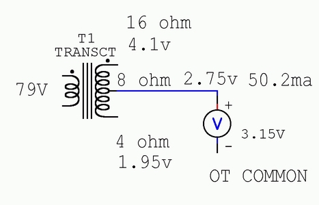

i did the test from <http://www.geofex.com/ampdbug/outtrans.htm> and got this results for the 50w 2xel34 OT: (i didn't had the neon and connected the circuit like shown in the picture)
input voltage: no load 3.14v 50 hz from a 65 volt transformer with variac on its input(the minimum on my variac was 5v so i had to...)
when connected to the 8 ohm tap it drooped to 2.75v with 50.2ma (no current limiting resistor)
the voltage in the primary was 79v and divided symmetrical between the center and tips.
after calculation the primary impedance is approx 5k ohm.
the voltages in the other tips where:
4 ohm=1.95v
8 ohm=2.75v
16 ohm=4.1v
seems ok or is the OT dead?

i think the 100w 4xel34 has an internal shorts..
the input voltage drops from 3.14 to 2.94 with 37.3ma on the 8 ohm tap so far so good but!
with 3.14v input i get on the primary tap to tap only 30v..
after calculation i get that the input impedance is 750 ohm???
much to low...
maybe it has something to do with the 50hz frq? the higher the frq i should get higher impedance and higher voltage over it...
is this one dead or maybe just have a crocked spectrum response?
