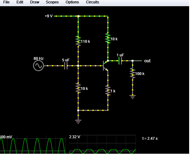

Transistor amplifier simulator
Not sure if this goes in 'tools and software' but since I ma thinking of building a transistor amplifier
http://www.diyaudio.com/forums/solid-state/291017-build-low-power-transistor-amplifier.html
I need to undertand the concepts - and this simulator seems to fit the bill.
Circuit Simulator Applet
From the circutis menu, navigate to:
Circuits > Transistors > Common Emitter Amplifier
I changed the Beta to 35 from 100. Next I change the voltage to 9 V what is available.
I get a clipped sine wave and its in negative territory. What next?

beta = 35? Seems a bit low.
The problem is twofold:
1. The output RC highpass (5µ/1meg) has a loooong time constant, and this simulator allows swapping out component values on the fly. Put in 1µ + 100k instead, and you should see DC-centered output after a while. (I recommend swapping out the other 5µ as well.)
2. This common emitter amplifier has too much gain (~10x) to support 500 mVp / 1 Vpp input on +9 V (1 Vpp x 10 = ?). Even if you optimize the bias resistors by e.g. swapping out the 110k for a 75k, you'll still get rounded tops. Things look better at 300 mVp.
Have you already done a bit of reading yet? Simulators are handy for playing around once you have grasped a few basic concepts.

I presume you mean the 5 uF capacitor and the 1Mega Ohm resistor on the right side of the diagram? OK. That did not do any harm, the output sine wave amplitude increased about threefold.
I simply do not understand this part - 500 mVp - millivolts ? p? In any case the AC input is set as 500Mv however for an actual input from a mini rca output such as from a phone or MP3 player how can I reduce the output?
I need to do more reading, but these electronics sites are confusing especially the circuit diagram with the infamous "ground". I really wold prefer if they showed two terminals.

So, why only 35 then? This particular circuit (with bias network = 75k/10k) draws about half a mA of quiescent current, so for most of the voltage swing beta should be above 75 and generally closer to 100. Plus you may have noticed that these are given as minimum values, and the graph of typical beta at normal temperatures is well above 100 even at 0.1 mA Ic.Beta for this transistor:

Be careful to avoid using transistors in areas of heavy beta droop, which is above about 200-400 mA in this case. This could lead to some nasty effects, not to mention that GBW (datasheet Fig. 10) is dropping like a rock and may be good for some nasty intermodulation distortion.

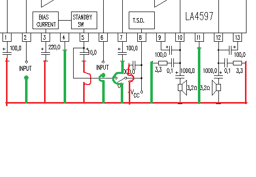

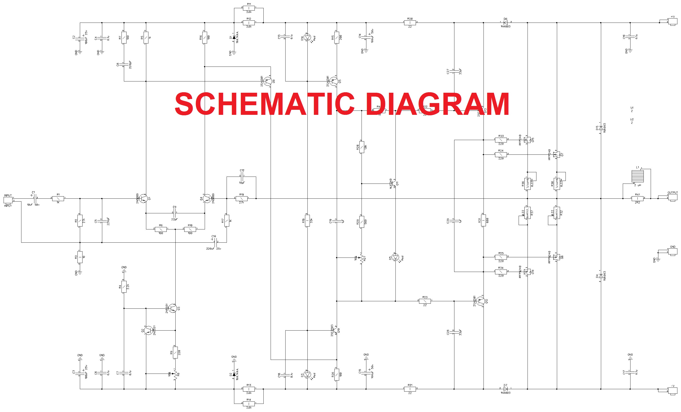

In fact, it's vice versa. Imagine, how many "unwanted" extra wires would be placed on the attached schematic, if the ground symbol would not be used.
The ground symbol makes the schematic more clean, more readable (picture 1).
Schematic never gives you any information "about wire lengths or how they are to be routed so as not to cause interference" - these things are only visible on the layout (pictures 2 and 3).
I remember the same thing, when I was a beginner. "Ground" or "earth" can be a confusing concept.As a beginner I find the earth symbol confusing.
There are applications where "earth" really IS used instead of a wire - and "earth" isn't even connected to earth. For example, almost every car is wired this way, with the metal body of the vehicle being used as "earth". You run a single wire from the battery positive to, say, a tail-light bulb; the other side of the bulb is "grounded" to the metal body nearby. There is no wire from the bulb back to the battery negative.
Since the tail-lights are easily 3 metres or more from the battery in most vehicles, you can imagine how much copper wire is saved by using this technique. Not to mention weight, complexity, et cetera.

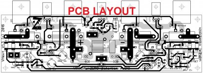

As you get further into electronics, you'll probably find other confusing areas. It's a complex field, and there is a lot to understand. The physics behind the behaviour of an ordinary silicon diode, for instance, requires years of study to understand (calculus, statistics, quantum mechanics, etc), which is why most hobbyists never do understand it.
Layout is another entire area to master. Simple audio circuits aren't hard. But modern RF circuits are something else entirely. It takes a lot of expertise to do that well, and most of us don't have it.

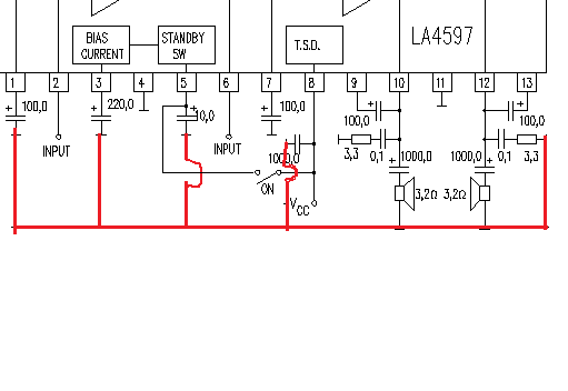

OK, let me try to explain.
The box in the middle is LA4597 IC. Its pin numbers are shown at the bottom side of the box (1 to 13). Don't pay attention to the drawing inside the box - it's gust showing the IC's internal principal arrangement (2 channels, standby circuit, etc.).
All the wires, ending with perpendicular line, are the ground symbols (example - the ground, connected to pins 4 and 11). All these symbols are connected with a common wire, going to the common terminal of the power supply - in this particular case, to "-" terminal of 9V or, say, 12V DC power supply.
Pins 2 and 6 are the inputs of channel 1 and channel 2 - they go the the "hot" pins of each input terminal. The "cold" pin of each input terminal is connected to the same common "ground" wire, where all the ground symbols are connected.
+Vcc is where the "+" terminal of the power supply is connected.
Speaker terminals are connected:
- "hot" pin goes to the negative pin of 1000.0 uF capacitor.
- "cold" pin goes to the common "ground" wire again.
All capacitor values are shown in uF (micro-farads), all resistor values are shown in ohms.
What else? Looks like that's it. This is a low power, rather low quality, but very simple stereo amplifier.
With regards to "machine made like computer system boards" - even though in the digital world automated PCB routing is used successfully, even there there is a lot of manual work.
In high-performance analog audio designs we use manual routing most of the time, as there are no automated routers, able to take in account all the factors, preserving the quality.
With the relatively high-power amplifiers, say, 50W and above, situation is even more complicated, as rather high currents are involved in the output stages, so traces must be shorter and wider than normal. We never rely on automatic routers in this case.
Hope this helps 😉

Any high powered HiFi amplifier will then have the hand-assembled boards? What about this one?
One thing that bothers me is connecting any side of the input signal or output signal to the same 'earth' that the power supply is connected to - doesn't the DC current affect the line in and out electronics like speakers and source components? I am sure the answer is obvious, but clearing up this little point will help me.
Yes it helps. I have drawn the ground wire connecting the various wires ending in ground, and it is 100% clearer to me. Maybe it wastes ink, but as a user interface, as recommended in the computer software industry, this one is better, I think.
For example in the circuit simulator at Circuit Simulator Applet the current is shown fluctuating at the earth terminals and the out terminals (first post).
If you look at the worldwide product categories for electronics, the most growth is in mobile devices, however, aduio-visual products and home appliances as well as econ-friendly, health care and security products seem to be areas where the large hand-assembled boards will dominate, but I may be wrong.
Electronics Market Spurred by Technology and Wearable Items: the Spring 2015 Hong Kong Electronics Fair Survey | HKTDC
You have left a few "grounds" unconnected - see my green additions. Just want to stress this point again - as soon as you get some experience reading the schematics, your mind will adapt to the "ground" concept and it will be really easier to understand the topology with the ground signs, than with all of them connected with a wire on the schematic. Believe me, I went through this experience... some 40 years ago 😱
Common ground is no problem, if it's arranged the right way inside the amplifier. There are some more complicated setups, like "lifted ground" for the inputs, allowing ground loops elimination, especially useful in multi-channel arrangements, or even completely insulated balanced inputs (3 wires), most popular in professional equipment - pre-amps, mixers, stage amplifiers - dealing with long interconnects and electrically "noisy" environments.
However, in many home audio systems, most likely, all the ground wires of all the devices will be connected to each other.

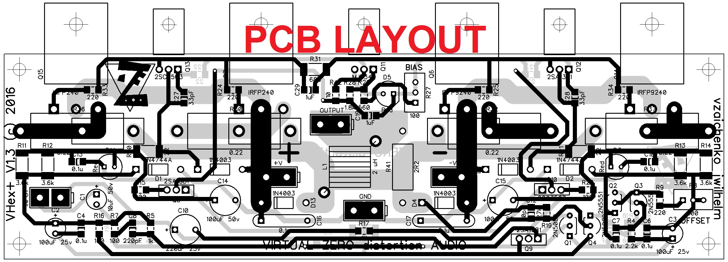

The boards... ok, we have to distinguish the manual routing (when we design the layout) and manual assembly (when we actually assemble and solder the board).
Assembly and soldering are automated in most cases (unless it's a DIY hand-made build). Even expensive equipment manufacturers, producing hand-crafted devices, use automated soldering - it's just a very mature high-quality technology.
Coming back to manual routing - yes, most of high-quality audio equipment BCBs are designed with manual routing. Well, PCB design software is used anyway, but engineers place the parts on the boards and route the traces manually. That's the way to ensure the quality. I personally, after gaining some experience in PCB design, use automated routing for digital boards only.

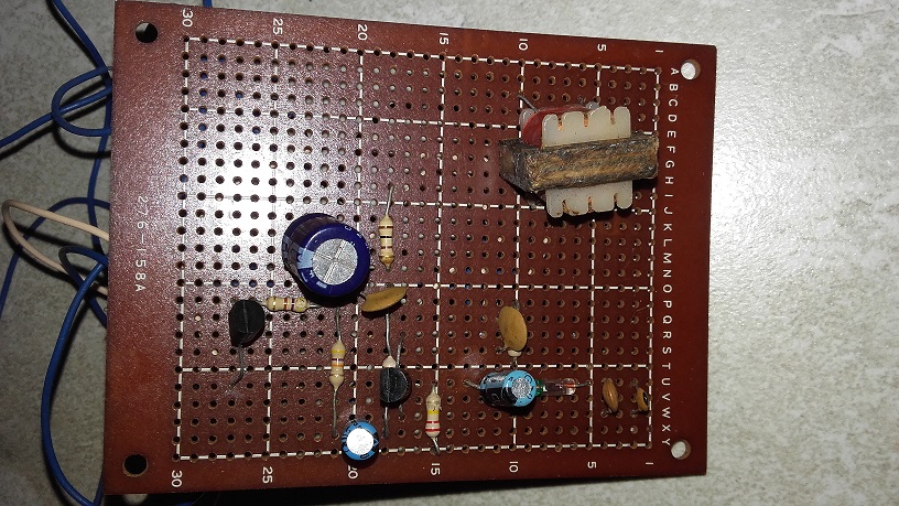

Transistor radio I built
Here in image of the remains of a breadboard transistor radio I built in 1993. It worked, I recall, however I was disappointed that it needed a 9V battery and I did not have a proper case for it.
I cannot recall the quality of the sound, but then I never imagined I could connect it to anything more than 2 inch speakers.
I am going to de-solder all the parts and try out a simple amplifier circuit.
