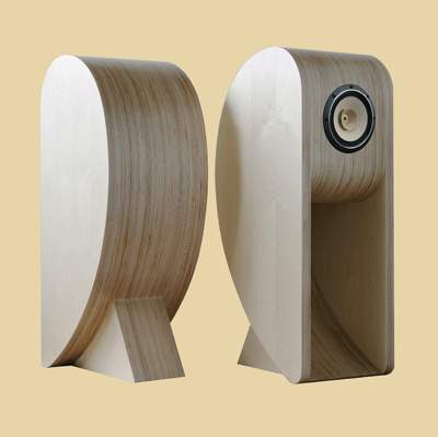

I open this new thread about the Replicon BLH speaker from Klangform Akustik, because I would like to understand theirs special BLH calculation method.
The Replikon is unique by having a BIG pressure chamber behind the driver and a relative short horn length.
I haven't got much infos about this speaker:

Die technischen Daten des Horns:
· Druckkammer 130 ltr
· Länge 1,2 m
· Halsfläche 210 cm
· Mundfläche 4500 cm
· Breite ca. 55 cm
· Tiefe ca. 60 cm
· Hoehe ca. 140 cm..."

So, this design is totaly inconsistent with what I have learnt about the BLHs: the rear chamber is much larger, the horn lenght is much shorter then the "classical" method calculation would give. (Too big rear chamber give "boomy" bass, too short horn lenght will give bad low effiency, etc)
Ther is a very good article-project on the Lowther Club of Norway ( the All fun horn ) where man could learn a lot about horn theory!
I know how I need to reduct the mouth size:
...The clasical calculated dimensions apply if the horn mouth is radiating into all 8 quadrants of the space (i.e. the horn is actually hanging from a high ceiling, so that sound radiates in all directions). If the mouth exits at floor level in the middle of a very large room, sound will radiate into 4 quadrants, enabling us to halve the mouth area. Following the same principle, if the horn moth exits where wall meets floor (away from the corner), the mouth radiation goes into 2 quadrants. It follows that for corner placement we can reduce the size by a factor of 8, since sound only will be radiating into 1 quadrant of the space....
and how to compromising the mouth size:
...An accepted rule of thumb for bass horns is that the mouth area may safely be reduced to 1/5 of the original size....
and about the horn length:
...Regardless of contour, the length of a horn is a function of Fc, and At (Area at Throat). These parameters are initially balanced so that the horn is efficient enough to match the increasing output of the driver at higher frequencies, while at the same time maintaining low distortion figures (which, by the way, are insignificant in a horn system, compared to vented and closed boxes). It follows that a lower Fc means a longer horn.
However, as we have now seen, mouth size compromise will eventually dictate the horn's length. The accepted rule of thumb concerning horn length is that the horn will work as intended provided the horn is no shorter than 1/4 wavelength of Fc....
So, after this "short" leading in, I would like to ask the experts to help me to understand the Replikon design. My ultimate purpose would be to design in this way a BLH enclosure for the Fostex 166E or 166 ESR.

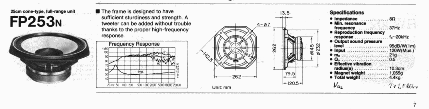

Greets!
I couldn't find any specs for the driver so can't really comment on the design beyond the fact that it's not the 'next generation' BLH unless they jumped into the 'way back machine' and first published it in the early 1930s. FWIW, the Jensen Imperial is one of the better versions of this style horn and will perform much more closely to their posted sim than their design apparently did.
Any idea what their 'innovative passive acoustic filter' might be? Last time I checked, that's what the rear chamber Vb/throat area was supposed to handle.

Since Qo isn't the same as Qts, I'll have to make up a bogus set of specs to create a Qo = 0.5, then make an equally bogus set of Qes,Qms, Qts specs from the results, so how accurate any sim from them will be is open to debate, but it's the best I can do with what I have to work with.
What's Vas, I can't read it?

Thanks, I was hoping it was since it fell in line with the FR plot, but it sure looked like 747L.
Known:
Fs = 37 Hz
Vas = 141 L (4.979368 ft^3)
Sd = 333.292 cm^2 (51.6604 in^2)
Qo = 0.5
Mo = 21 g
8 ohm nom.
120W (music)
Assumed/calc'd:
Re = 5.5 ohms
Le = 0.5 mH
Qes = 0.7265
Qms = 3.3485
Qts = 0.7265
BL = 6.0257 N/A
Cms = 8.9687e-04 mm/N
Mms = 20.06303 g
91.78 dB/W/m
OK, using MJK's BLH WS I have a sim that approximates the measured response above ~150Hz...... I assume since my half space sim shows much more gain below 150Hz than the measured response it's an outdoor measurement other than ground plane.
Another anomaly is that just from looking at a pic of the horn implies a chamber/throat layout of 0.5, but the sim by far best approximates the 0.0 layout (see MJK's BLH application notes). Maybe this is where the mysterious 'innovative passive acoustic filter' comes into play....... 😉 Regardless, the 0.5 layout yields the flattest HF response so is my preference.
Anyway, this is a typical BLH for a driver that either needs a relatively large 'filter chamber' due to its Vas/Qts properties or one that normally requires a small chamber (higher acoustic XO), but significant series resistance increases the required Vb due to using a SET amp/whatever, so it only gives 'boomy' bass if the driver's air 'spring' requirements are < the filter chamber's Vb.
GM
