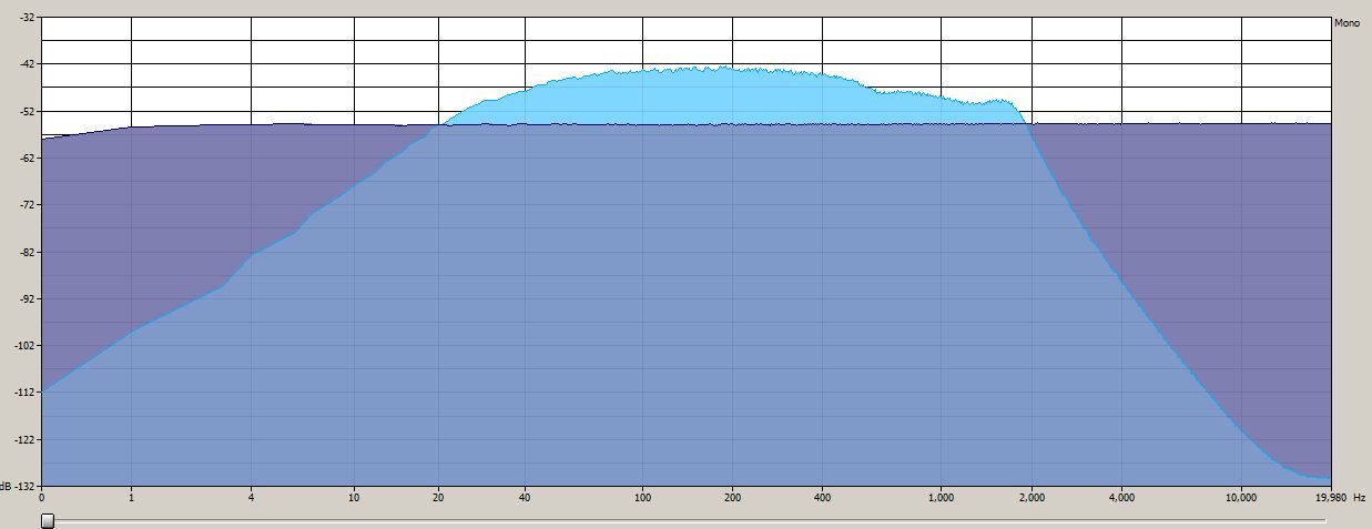

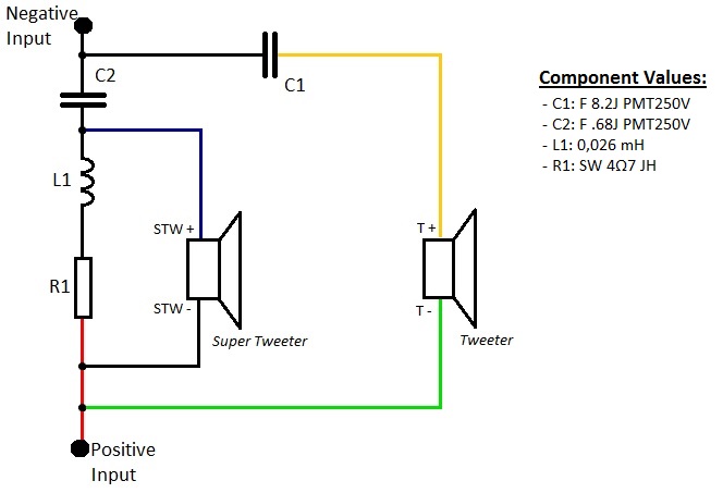

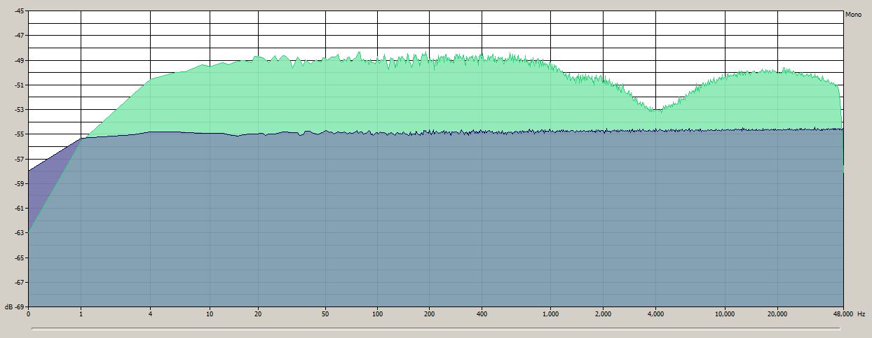

I did a spectrum analysis of both outputs of the "filter" board and I traced the "extra" card schematic, screenshots attached.
I'm finding it hard to understand what kind of crossover design I need - I don't know much about speakers ; and the more research and tests I do, the more puzzled I am - so if anyone here was able to help it would be much appreciated 🙂
So far, I believe that the "filter" board is active crossovers because of the energy added to the signal as you can see on spectrum screenshots:
- dark blue is the noise fed into the board,
- light blue is the output fed to the amp of the bass driver,
- light green is the output fed to the amp of the tweeter (still full band at that stage).
This tweeter signal is fed, after amplification, into the "extra" board (passive crossovers I believe) to split it between the Tweeter and the Super Tweeter - which reproduces frequencies above 21 kHz according to documentation.
1) I don't understand if the frequency dip around 4 kHz on tweeters signal is intentional ?
2) I dont understand the values of the components on the schematic, I copied exactly what was written on them: can you help me decipher at all ?
3) I was told that L1 and R1 form a Zobel network, but after a bit of reading it is too complicated for my grasp - can anyone explain their function in layman's terms ?
4) There is only C1 in the tweeter signal path, which I understand to be a 1st order HighPass, hence -6 db/octave. But the crossover of the bass signal shows a much steeper filtering (about -32 db/octave or so if i'm not mistaken). Wouldn't it result in a funny overall frequency response of the speaker around cutoff ? Tannoy states that the crossover frequency is 2.2 kHz.
5) The monitors are built with Tannoy's "dual concentric" technology: the tweeter is located in the middle of the bass driver. Should the Lo-Freq and the Hi-Freq signals (post crossovers) be perfectly phase matched ? What about the Super Tweeter - which is not aligned with the other two drivers ?
6) I also see that frequencies are cut at -10 dB/octave under about 40 Hz on the bass signal. Would this be intentional on Tannoy's part? should I do it ?

Why do you need to replace the filter boards? Surely they are working OK as you obtained measurements from them. Although the lack of (active) high-pass filtering on the tweeter is a bit odd.
C1 is 8.2uF 5% tolerance 250V capacitor
C2 is 0.68uF 5% tolerance 250V capacitor
L1 is 0.026mH (26uH) inductor
R1 is 4.7R 5% tolerance resistor

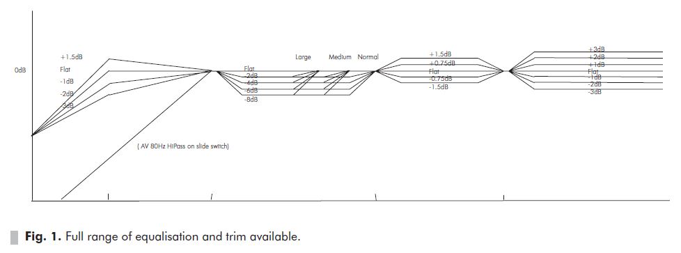

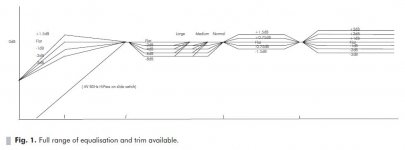

yes Andrew, the filter board is equipped with a set of 20 dip switches that - I believe - implement control over the six MC33079P (datasheet attached) chips present on this same board.
I did the spectrum analysis with those switches positioned for a flat system response (see user manual screenshot attached).
Here I see the High-Pass filtering below 40 Hz so I assume it is intentional on Tanoy's part. Would anyone know why it could be required ?

Sorry to dig up such an old thread, but that passive crossover is only for the coax tweeter that's "inside" the woofer, and the supertweeter that's external, near the top of the enclosure.
Looks like I’ve understood the entire filtering scheme.
I initially expected that a 2 way (actually 3 way with an extra wide-band tweeter took into account) has to have HiPass and LowPass filters connected to corresponding amplifier and finally to speakers. Such approach was implemented in any 2 way system I saw, but not in Tannoy Precision (6D in my case)
In the 6D there actually is a LowPass active filter connected to the first amplifier and to the woofer,
But all that could be treated as HiPass filter actually has the flat response (I’ve measured) , so HiPass filtering is made by the passive filter that pierrepierrepierre called “crossover”.
Formally it’s a crossover as well. It separates frequencies between the tweeter and the wide-band, but it’s also a HiPass passive filter for the both.
Why so? My humble hypothesis is the equalization possibilities of the 6D.
As the equalization happens in the mid frequencies as well, for “true” 2-way active crossover we wound need some synchronized equalization circuits in the both channels as equalization affects the range of the crossover frequency, But it would be too complex electrically.
So the vendor just decides to move HiPass filtering to the passive part.
Maybe there is another reason for such approach, but I could hardly imagine a simple circuit that is able to equalize the response equally in the both (Hi+Low) channels.
