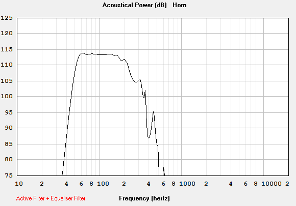

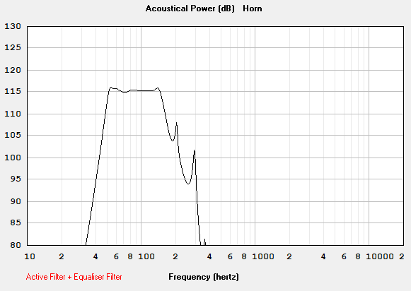

I also wonder which long throw 8" woofers could be used...it would be a great challenge trying to build one. To model a single TH with 50 Hz cutoff capable of 118 dB continuous output (4 should be then 124 dB if I am correct) would be a good start. Any recommendation for a suitable 8" and/or existing TH design for a single 8"? And if used for the TH part only, would it not be more reasonable to use a 2x15" bass reflex in the same volume (with less efficiency I suppose)?
