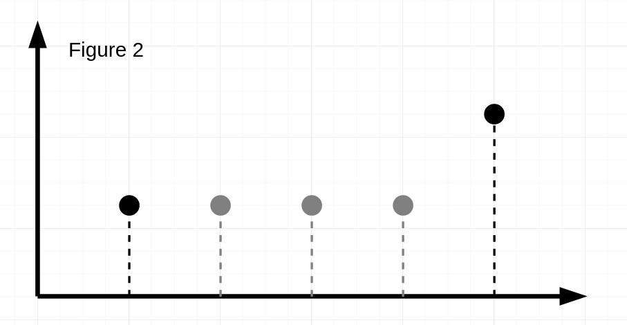

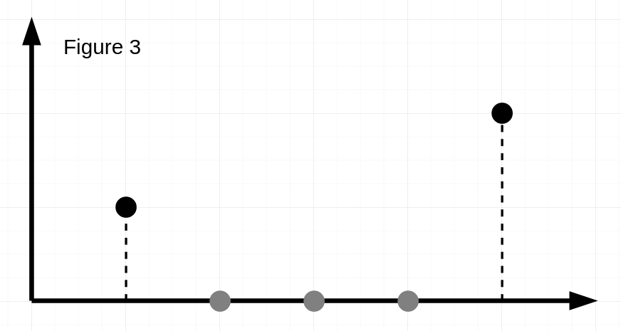

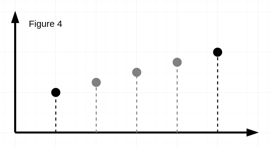

If someone used the term "4x oversampling", are they referring to figure 2, 3 or 4? (or something else entirely?)

Figure 3 shows the insertion of the necessary extra samples for 4x oversampling, but they are only zero value place holder samples as yet. Three new samples values need be calculated for each originally input sample. As shown in the figure.
Figure 4 shows what happens to the zero value samples after the entire sample string of figure 3, has been passed through a digital reconstruction filter. Typically, a 'brick wall' low-pass.
Joined 2009
The last three figures are all examples of oversampling. Naturally you get better performance if you interpolate between the two original samples as shown in the last figure. What you've shown is a simple linear interpolation. You can get fancier if you use more of the original samples in your interpolation and use some sort of polynomial fit.

Now I'm curious if anyone has performed some of the oversampling in the analog domain, rather than entirely digital.
i.e. insert zeros, then actually run them through the DAC, and use the analog reconstruction filter to low pass the result. I suppose this might have disadvantages. For one, the amplitude of the DAC output would be lower (2x oversample would be half the amplitude, as the DAC is now outputting zero current half the time), and I'd imagine that shutting the current off entirely every other sample might be the worst-case analog performance of the chip, and might exacerbate lead inductances, etc?

Fig.3(zero insertion) is the only answer to reproduce the original signal. Fig.2 isn't. Fig.3 and Fig.4 are the same frequency spectrum if Fig.4 is processed by a perfect digital filter. It's possible to use 4fs when you sample the data. But if your target has 0.5fs bandwidth, you have meaningless data(redundancy). So, you can replace the redundant date with zero like Fig.3. Instead of memorizing four times data, you can use fs. Zero insertion at sampling means data compression; now, you have 1/4 data. You can define oversampling as the reconstruct process of deleted data at sampling.

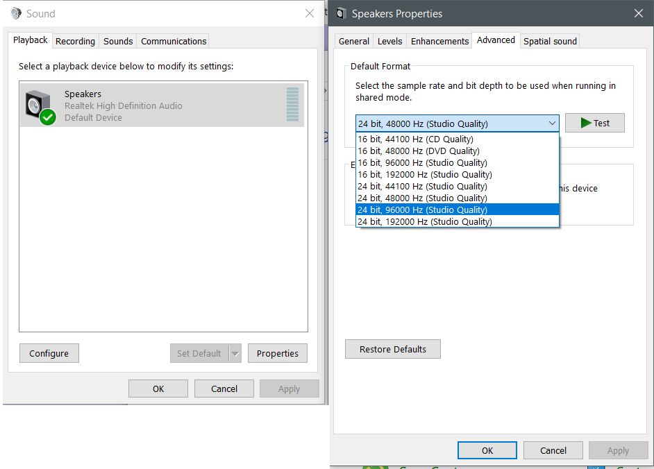

Okay, configuring windows for ASIO drivers. First you need at least two sound devices, basically one dac you want to use for playing music, and another one you are willing to let Windows mess with.
Hold down the Windows key and hit R. A run dialog should open wherein you can type mmsys.cpl which should take you to the sound device configuration control panel object. There are other ways to get to the same place, but this one should work.
First you need to get rid of any green check marks in the rectangular box for the dac you want to use. Right click on the dac you don't want to use, and assign it to be default sound device and default communications device. (Please see the attached screenshot below.) Then double clicking on the dac you do want to use should open a properties window. Go to the level tab and turn it up all the way (same think as turning up the volume for that dac from the desktop widget when it is the default sound device (or maybe whenever it is playing, not sure). Leave it all the way up as far as Windows is concerned.
Then use an app such as Foobar2000 to play all music files. Download and install the ASIO component for it then go into its configuration and select the ASIO driver for the dac you want to use for playing music. Then you can select some music and hit play. Windows should be leaving your audio alone. Looking in the sound control panel applet window you should not see the VU meter for the dac you are using moving around. That should only be active when audio is passing through Windows Sound Engine, something we are using ASIO to avoid.
