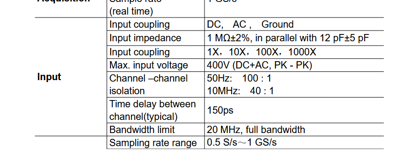

G'day Guys,
I am trying to make sure I correctly understand the voltage ratings of my oscilloscope before I blow something up.
My scope is an Owon SDS210S
https://owon.com.hk/products_sds200_series_digital_oscilloscope
The voltage rating of the scope is 400V
If I understand this correctly:
The voltage must not exceed 400v total including any and all AC + DC components.
Then there is the probes:
The OW3100 probes that come with it state:
"1x ≤ 200Vpk 10x ≤600Vpk"
Under 200Vpk I can use the probe in 1x mode.
Between 200Vpk and 600Vpk I can use 10X mode.
I assume Vpk here refers to the total voltage of any and all ac + dc components.
So assuming I have all of the above correct:
As long as I keep my probes in 10x attenuation I can safely probe a tube preamp with a 265Vdc B+ and its power supply with its maximum raw B+ of 330ish Vdc.
Have I missed anything?

The spec is a bit ambiguous, but always use the X10 probes and you'll be fine.
In general, use AC coupling unless measuring DC or low audio frequencies.
AFAIK the above seems to be correct to me, you may also check what max voltage value is imprinted on the probes themselves, probably 600V CAT <something>.
