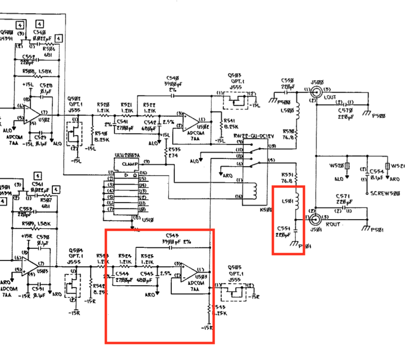

I am refreshing an ADCOM GDA-600 DAC as a learning experience and trying to understand some of the LPF used here.
This DAC uses dual channel op-amps per channel. To my understanding, each opamp does both I/V and filtering.
I've attached the relevant section of the schematic.
A few questions:
1) Is it correct that this is a "second order LPF" ?
2) There is an LC filter on the output. Is this actually needed given that we already have active filtering?
3) Can the circuit be optimized here? The cap values here seem to be non-standard based on Digikey and Mouser inventory. I've also read somewhere that the resistor value should be between 10K-100K while 1.21K is used here.
Thanks!
P.S I will be replacing the stock op-amps with OPA2132 if that matters

A few questions:
Looks a lot like a 3rd order Sallen-Key LPF.
Dacs can produce an lot of RF on the analog outputs. Hopefully, the opamps where chosen because they could handle the RF without distorting. No guarantee any downstream equipment will be designed to tolerate that, so better to filter it out as much as possible.
The cap values are probably calculated to give the correct filter poles locations. You can try recalculating with optimization favoring more common cap values, but the resistor values may be odd.
On the one hand, resistors make noise and higher value resistors make more noise than low value resistors do. On the other hand, opamps will distort if they can't drive too low an impedance load. Opamps typically used for state of art dacs can tolerate low-ish impedances (~600 ohms), and using low-ish value resistors can help improve noise performance.
Why? If you think new opamps are needed, you might consider OPA1612 which are used with state of art dac chips like AK4499 and the slightly older ES9038PRO. They may be more tolerant of RF that the lower bandwidth OPA2132. In part it depends on what dac is ahead of the opamps in the schematic you show. Older dacs with more clock noise on the analog outputs may benefit from using faster, somewhat less linear opamps. For an old 16-bit dac, the trade off to a faster, less linear opamp may be worthwhile. Point is, it depends.
On the beginning there is an active I/V converter. It has some first order LP filter as usual, followed by a passive RC filter. Then in a red box there is a second order active filter, probably Butterworth. Not sure, as there are variations having the same layout, but it was popular. Look at some examples, you can calculate your cut-off frequency before other guys come in:

As a rule, if you don't have a good RLC meter, you should not touch values of the active filter.
LC filter on the output has multiple functions. It prevents by example a radio frequency entering back to your active filter opamp.

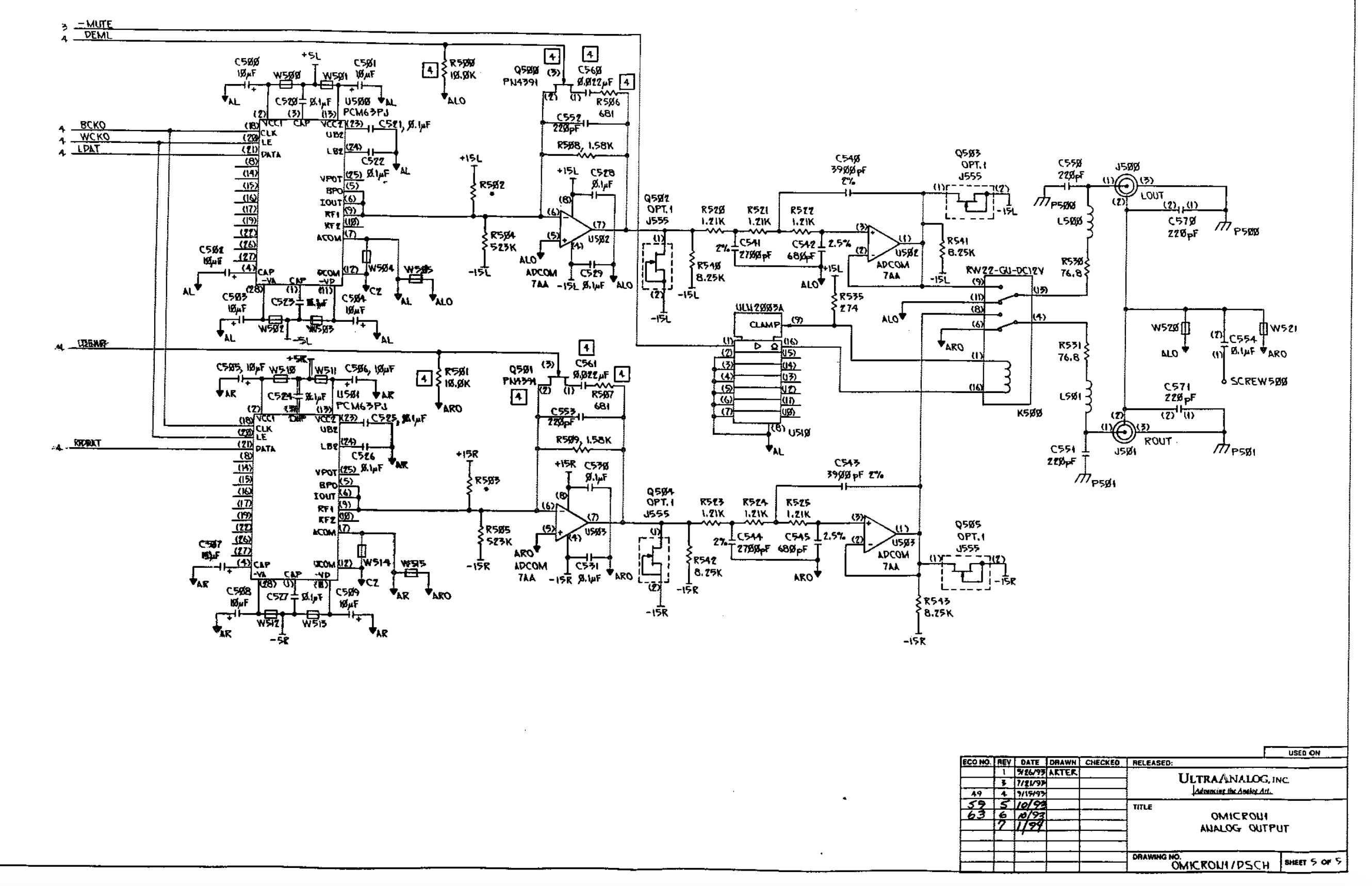

The DAC is based on PCM63P-J. Full schematic of this portion is attached.
The op-amp in there right now is badged Adcom 7AA and most people that swapped these out (seems like most people used dual OPA627 with adapters) report improved sonics (subjectively).
The cost of a modern op-amp is not high and if improvements could be had I'd like to explore them.

Shouldn't the active filter take care of this? Unless the cut-off frequencey is higher than the passive one?
If you run a frequency response simulation of a Sallen-Key LPF you may well find that while its rejection is good up to a few hundred kHz, its output starts to rise again after a while with increasing frequency. The LC filter in your schematic doesn't show a value for the inductor so its turnover frequency can't be established but its likely above 1MHz where the SK active filter runs out of steam.

A few questions:
Your DAC has a fourth order, active LPF in the 2 opamp section prior to the
OP LC filter (which is most likely at a much higher freq).
The first oder is wrapped around the the first I-V opamp. The second opamp, as Mark said, is a SK 3rd order LPF.
The FET switch on first OPA is likely a de-emphasis filter enable.
Probably not. It's difficult to say. It may have been needed for compliance. I've worked on some pretty poorly implemented DACs that had huge amounts of RF noise, not from the DAC itself but just bad design.
Would the first order be the C553, 220pF?
Do you have a CRO? This will enable you to see any RF noise on the OP and many other things.
Some modders removed the inductors in favor of jumpers and claim improved sonics. This could be true, but rather than follow blindly I'd like to know the reason why this would be.
Initially, I was under the impression that the Op-amp LPF could be sufficient but I'm learning here why that may not necessarily be case.

Your 3rd-order Sallen-Key filters are using 2% and 2.5% capacitors -- not easy to source and rather expensive in small quantities. The 2700, 3900, and 680pF values themselves at not unusual.
As to the 1K21 resistors, it is likely a best compromise selected specifically for that op-amp -- reducing input noise, while keeping the loading on the previous stage to an acceptable level. The notion that it *should be* between 10K and 100K might be reasonable for some certain (different) circuit/op-amp combination, but as a general rule simply does not apply.
The resistors also determine (along with the capacitors, of course) the filter's cutoff frequency; the ratio of capacitors sets the damping factor. Likely none of these variables were chosen haphazardly. In fact, the design probably underwent several iterations with simulations, test-builds, and extensive listening tests. More modern, better-sounding dual op-amps might be available today, and may even be cost-effective to try -- though not all will behave in this circuit.
