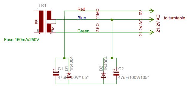

I traced the PS of my tt and it looks like the attached. As I know close to nothing about motors 🙂 could you please help me understand
- what is the purpose of the third cable (red) going to the motor
- is there any circuit to build for controlling the rpm?
thanks in advance

It is a synchronous motor, thr red cable is for starting it is just a bipolar cap to the field winding.
The speed is dependent on the mains frequency and cannot be changed, Use different belt shaft diameter for different speeds.

I need it for minor speed changes only and so as I understand a Variable Frequency Drive will be needed for altering the frequency fed to the motor.
Any hint for a suitable circuit? I assume it will be quite complex

Looking at what exists off the shelf I fell upon this, it's kind of overkill power-wise but could it work in principle?
While that may look like an easy solution it might not be so simple. What is the frequency of the output? How stable/accurate is it? How pure is it (harmonic distortion?)
