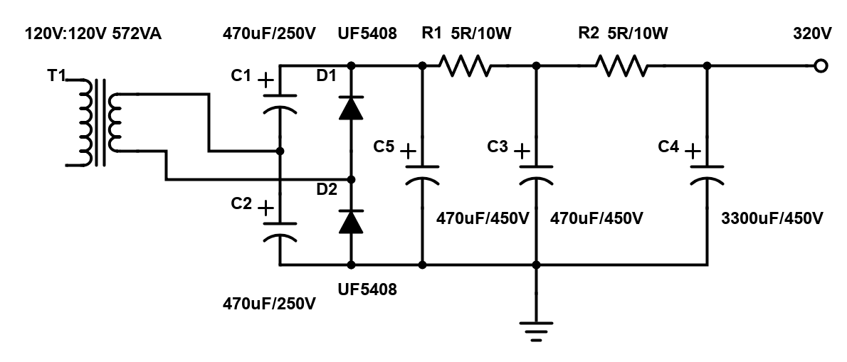

Thanks guys for all of the education and design/product suggestions. I have a question that I tried to ask earlier, but maybe not clearly enough.
Most of the info I've found on the internet explaining the safety aspect of isolation transformers key on the fact that they don't share a common neutral/ground. So that if you were to touch one of the secondary-side leads while standing on "ground"/earth you wouldn't get a shock (hence isolated). But the design of all of the amps that we build with transformers has us attaching audio circuit grounds to the chassis, which is attached to the primary side neutral wire through the earth ground wire (which is also attached to the chassis). So doesn't this negate the primary safety aspect of the isolation transformer? What am I missing here?

Simply. You connect the "box" chassis or whatever to Earth ground. The use of isolation makes it safer byjust that... galvanic isolation. This means no matter how you connect the power (non polarized plug?) you still won't get a damaging shock. So called "death caps" used to fudge this to try and kill hum. Now they tend to kill humans...
Without isolation, most modern power supply designs would result in a short to ground, too.
In this case, without the transformer, and knowing one side of the "transformer" is tied to ground at the panel, half the supply would be a short, no? Or not... What do I know 😀
dancemyth, perhaps a different explanation.
We cannot eliminate the risk of electrical shocks. However, we can minimize them. Every simple minimization is both imperfect, and doggoned cheap insurance.
One risk of shock is conducting power from the outlet through your body to another ground, like a concrete floor. Mechanically connecting the chassis to an actual ground reduces the chance of this. An isolation transformer also reduces this risk.
We are not connecting the neutral wire, we are connecting the ground wire. Neutral wires are not necessarily "neutral", in spite of connections, and therefore not necessarily grounded. Proper ground wires are always grounded.
Under the wrong circumstances, both the "hot" wire and the "neutral" wire may have a voltage differential to the ground wire. Think unbalanced loads and less-than-perfect wiring connections. Yes, this means that sometimes you can test the outlet voltage, and there will be a voltage differential between the "ground" wire and the other two wires.
Stuff fails. Wiring insulation breaks, or wears through, and fails. If the piece of metal the wire shorts to is connected to ground, then a fuse blows, instead of killing you when you touch it while powered off.
A properly operating isolation transformer limits the power on the "out" side of the transformer to the circuit. Connecting to a proper ground changes nothing. It is unlikely that an isolation transformer will short out and carry high voltage outlet power through you to an external ground. Unlikely, but horrifically expensive. If all it does is kill you, that might be the cheapest alternative. Balance the cost of paying for killing somebody's kid, in the millions of dollars, against the cost of an isolation transformer. Even tiny likelihoods are horribly expensive.
