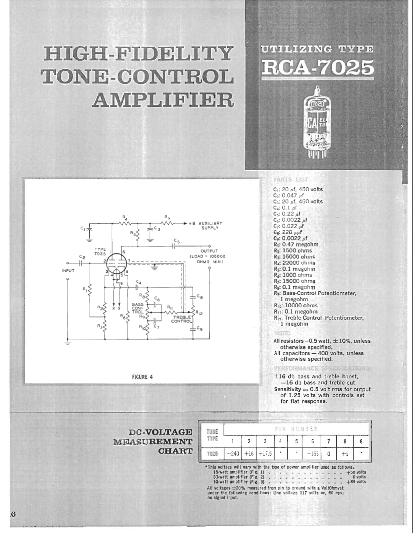

I am study for understand how to draw load lines on triode for now and I though after all I read and apply I have a basic knowledge then came across this RCA schematic and I really do not know how can work, but it works because I built it in one of my amp.

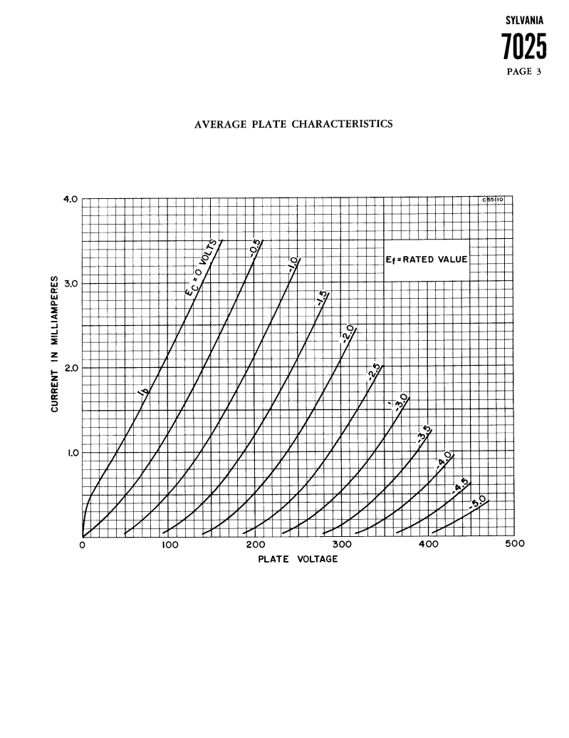

Now talking about the first triode cathode follower with 240v on the plate and a total of 16.5 K resistance on the cathode bring to 14.55 mA current, I cannot even draw a line on the 7025 data sheet where the max current plate is fixed at 4 mA. In this configuration I can see could be good for the 12au7, so I am really confuse, what am I missing? If somebody here can help I really appreciate it.

ok thanks so what is my mistake? My calculation was 240/16500=0.0145 Ampere= 14.5 mA, where I did wrong?
You did not go wrong - the load line is a very poor one. Actually the 240 volts should be reduced by the cathode voltage, but that's less than 10% - just a rounding-off error in tube circuits.

You do not have 240 volts over The cathode resistors, but 17.5 volts, so the current is 1mA, as jazbo8 says.
Yes, the DC idling current is about a milliamp. The loadline is (240 - cathode voltage = about 222 volts) across 16K5 Ohms. These values set the X and Y intersects on the load line.

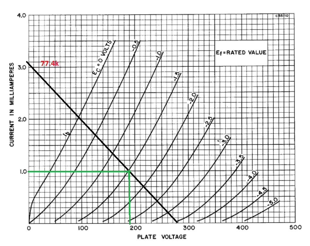

so maybe load line could be like this?

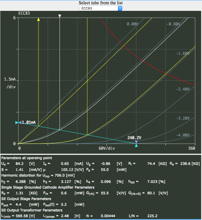

Nope. The default ECC83 in that calculator is more like what you're after. The IDLE (middle white line) is 1ma, max current (left end of load line) is 5ma which it will never achieve in use as a triode can't swing it's plate to 0V due to the Rp of the tube.

Then ask yourself what current will flow if the tube is shorted, = Va/R in series with the tube.That's one point of the line at Va=0
Second question, what voltage on the tube with no current ? Without current no drop on the resistor so Va is supply voltage at Ia=0, your other point of the line.Connect the two points with a loadline 😀
