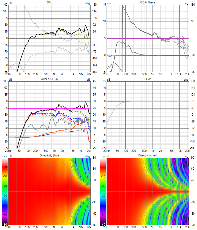

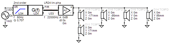

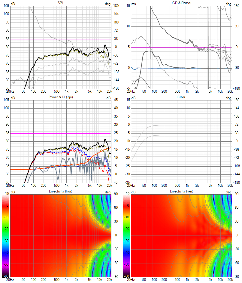

If you have enough dispersion info on the smaller driver you plan to use, it's easy to check what happens within Vituixcad.
You can even generate a raw version of that dispersion based on driver size information with Vituixcad if you don't have it available.
Here's a 5 driver Bessel using the TC9 driver (vertical array, at 5m distance):

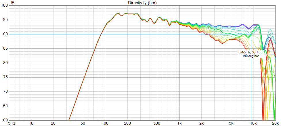

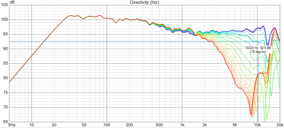

Got the parts in the door just now, the simulations are very exciting!
If that is correct and I can get such a response using a relaxed sloping function + a -2.5dB dip and a +2.5dB peak, and some taming of a peak at 12kHz, with an 8 driver array, this will get really exciting.
This is not a Bessel array like in the patent, not the same circuit, I would call it something like a "Pure" Bessel Array or something, or perhaps "Idealistic".
Reactions: GM and pelanj
Considering sacrificing a bit of off axis response for a tiny bit more SPL. Think it is still looking pretty good at -4dB/10kHz 70 degrees off axis.
This is with some very gentle nudging here and there, only 5 EQ bands per channel (Array tops + Bass) and relatively simple 12dB/oct Bessel filters.
Phase sums super smooth.
Will be exciting to see if this is compareable to real life, all the drivers are in house, hoping for a bit of time to make sawdust soon.
