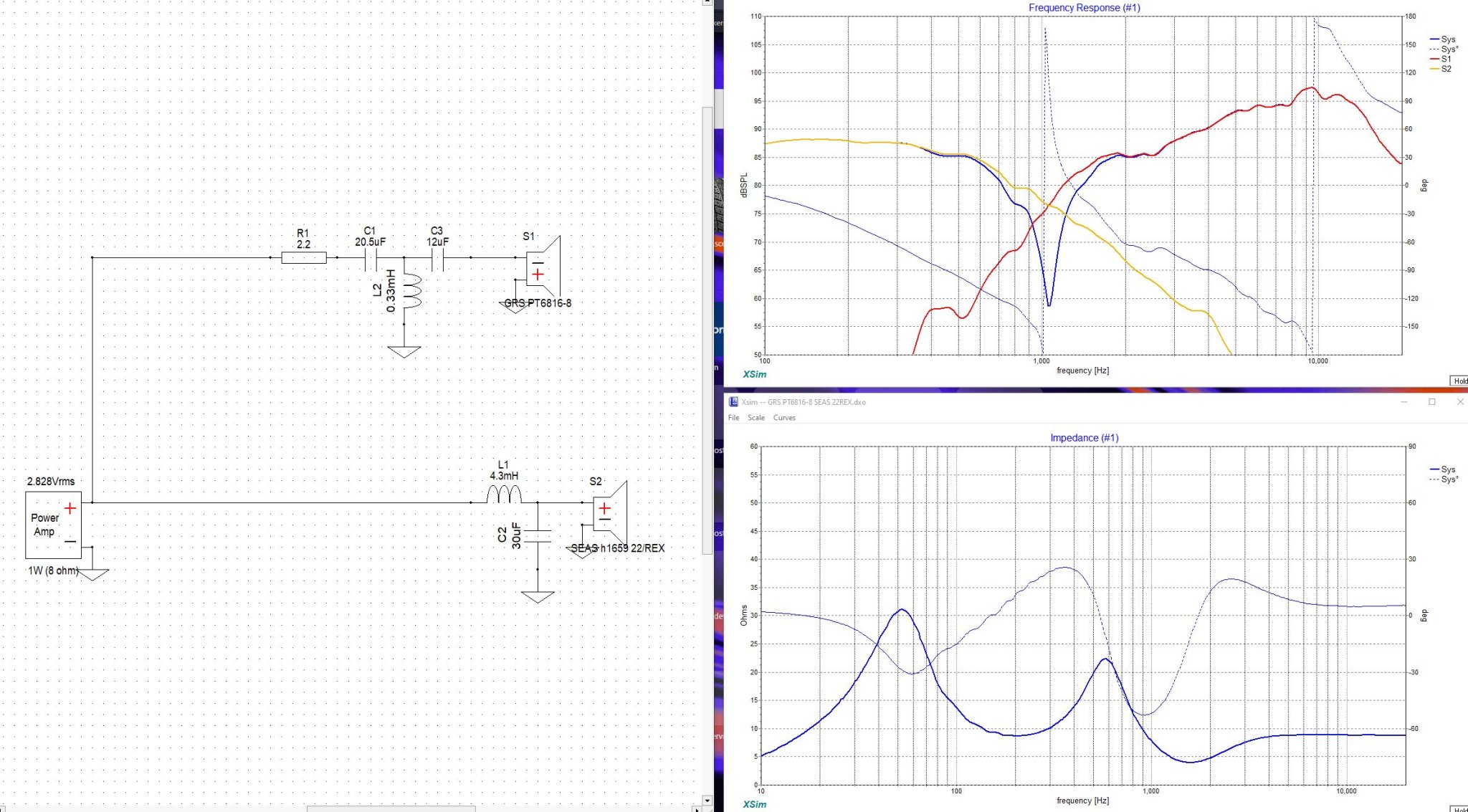

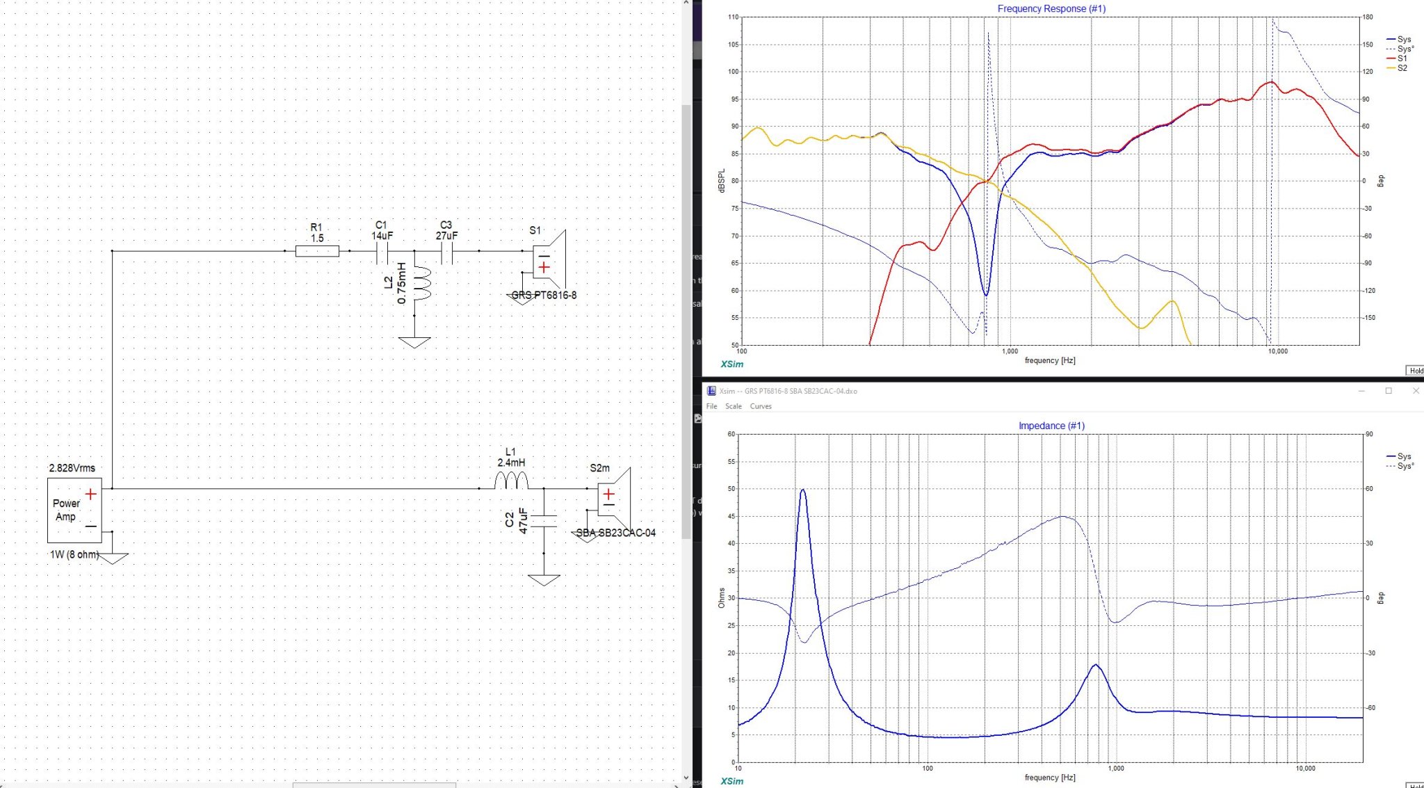

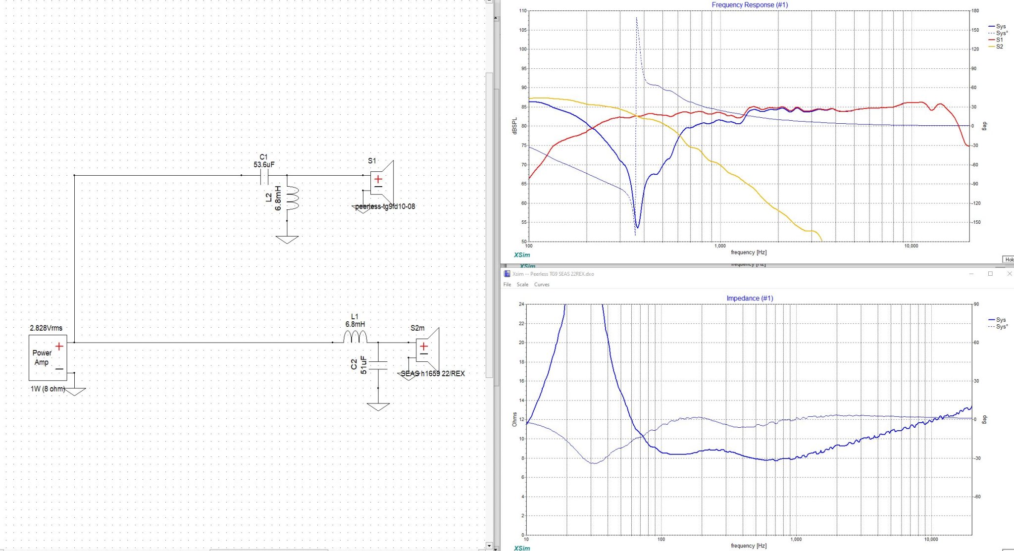

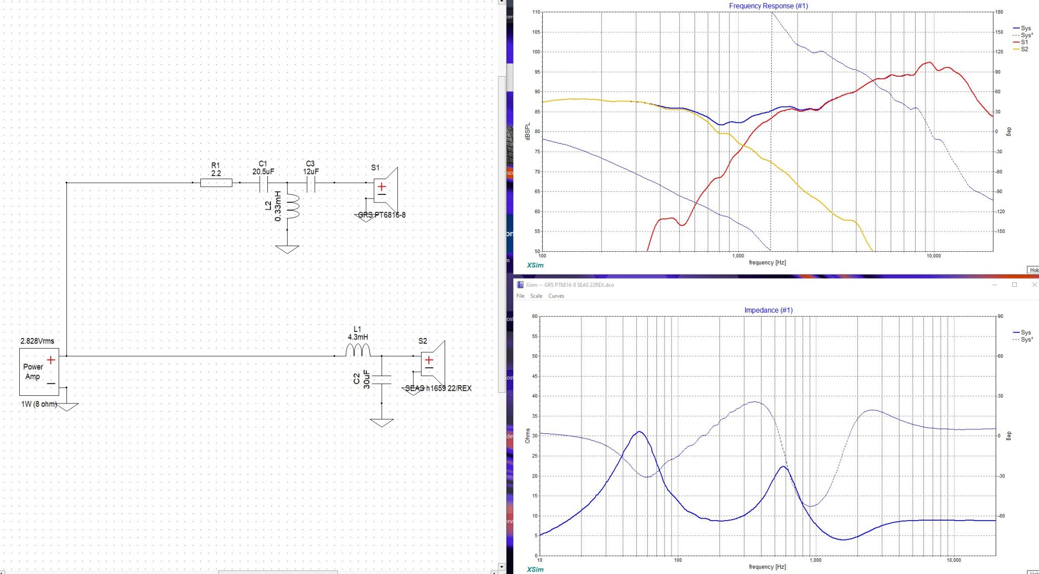

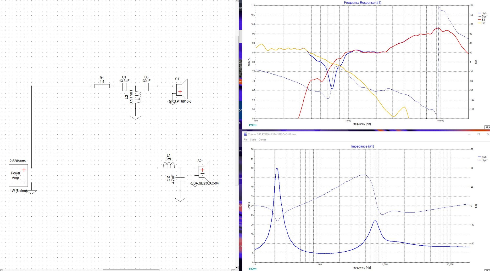

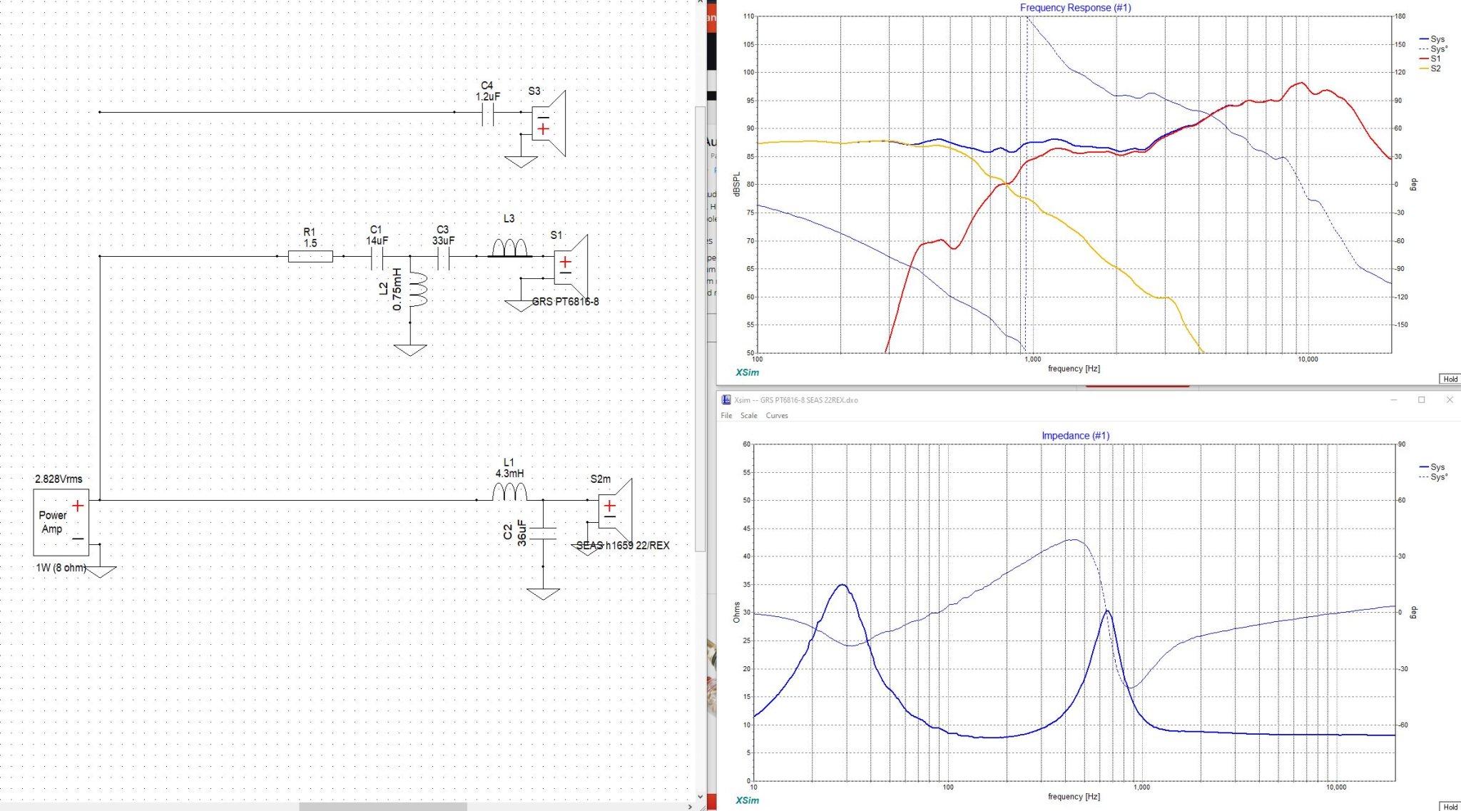

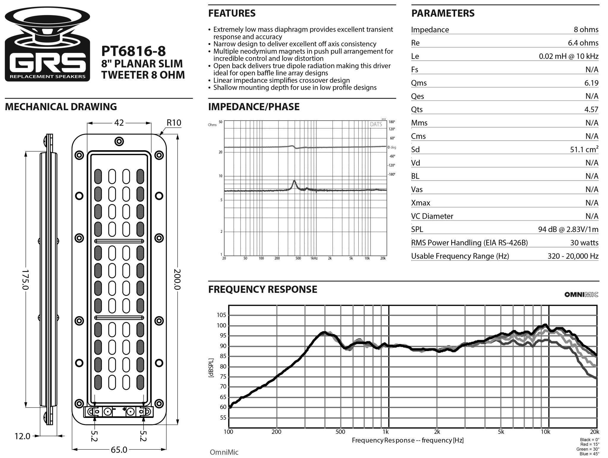

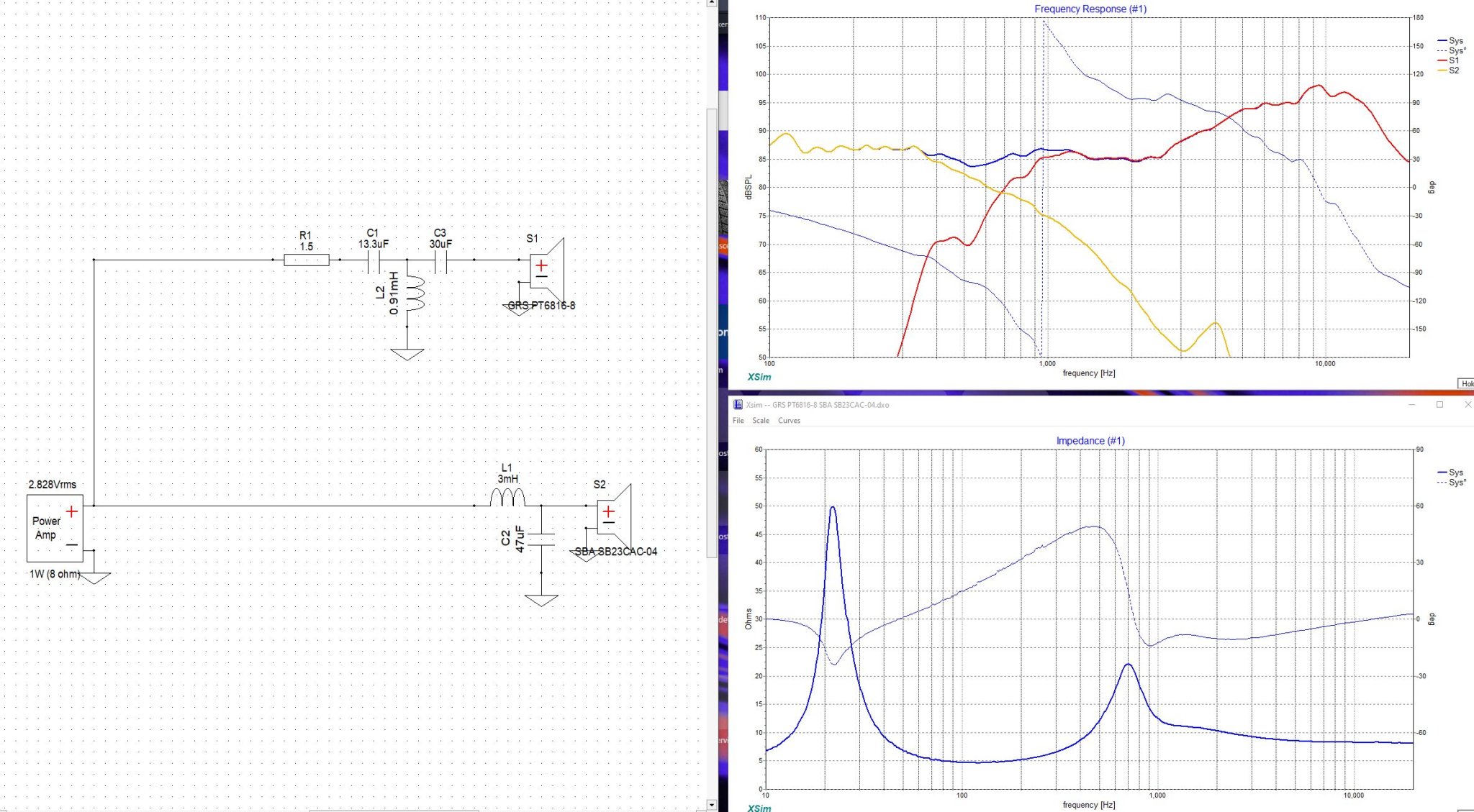

It's funny the best 300hz and above driver I have is:
https://www.parts-express.com/GRS-PT6816-8-8-Planar-Slim-Tweeter-8-Ohm-272-128?quantity=1

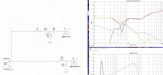

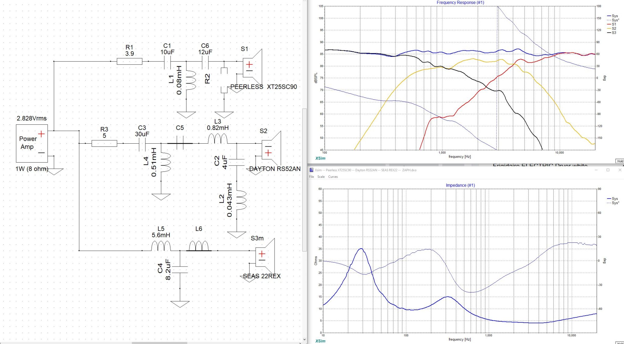

I can't seem to filter out the 400 Hz bump/resonance in Xsim.
Doesn't seem to be a lot of content above 4 KHz.

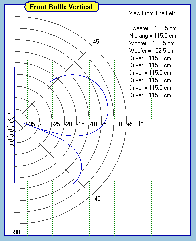

http://zaphaudio.com/ZDT3.5.html
Has a crap ton of cross-over crap going on.
Lobing at 3500 Hz is very bad if you're 20 degrees between the tweeter, which sometimes I am.
Cross-over makes me want to not make it, although I already made it for a similar speaker.
I was thinking of doing GRS sideways in semi open baffle (top and bottom enclosed) with reflector behind it (sides open).
I can draw the reflector

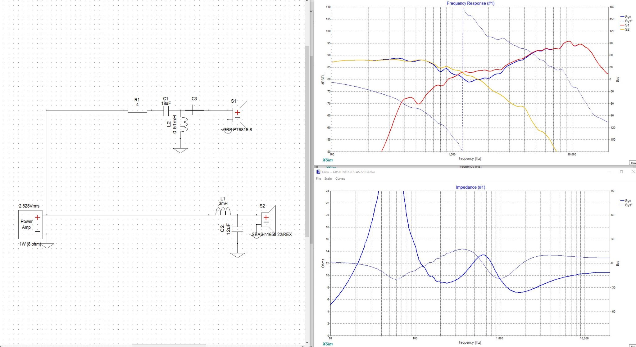

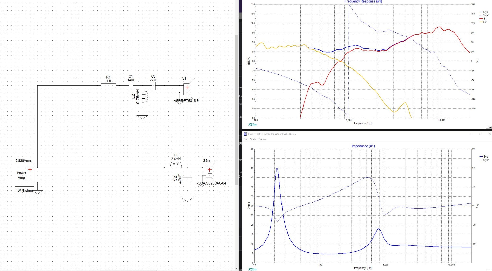

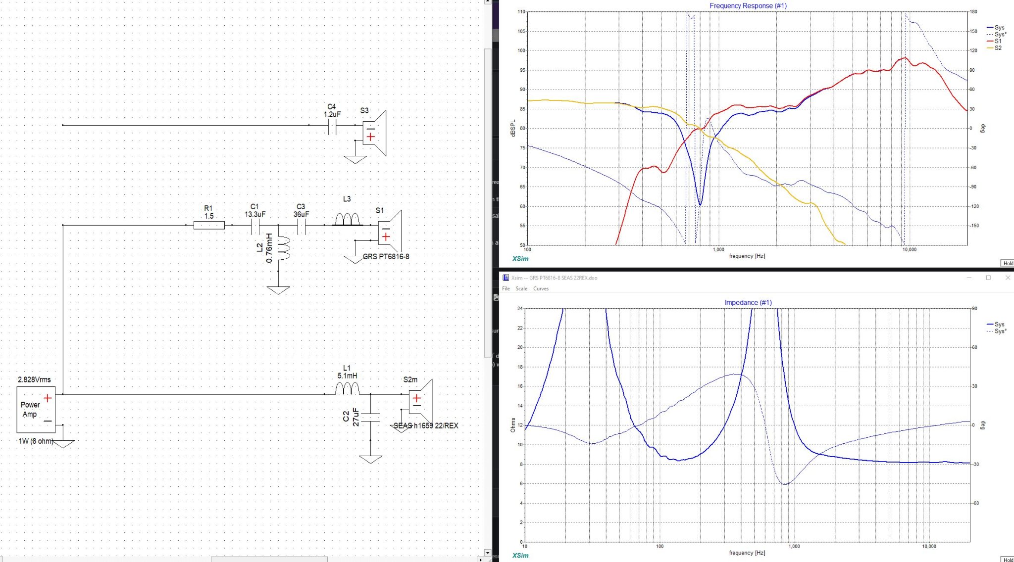

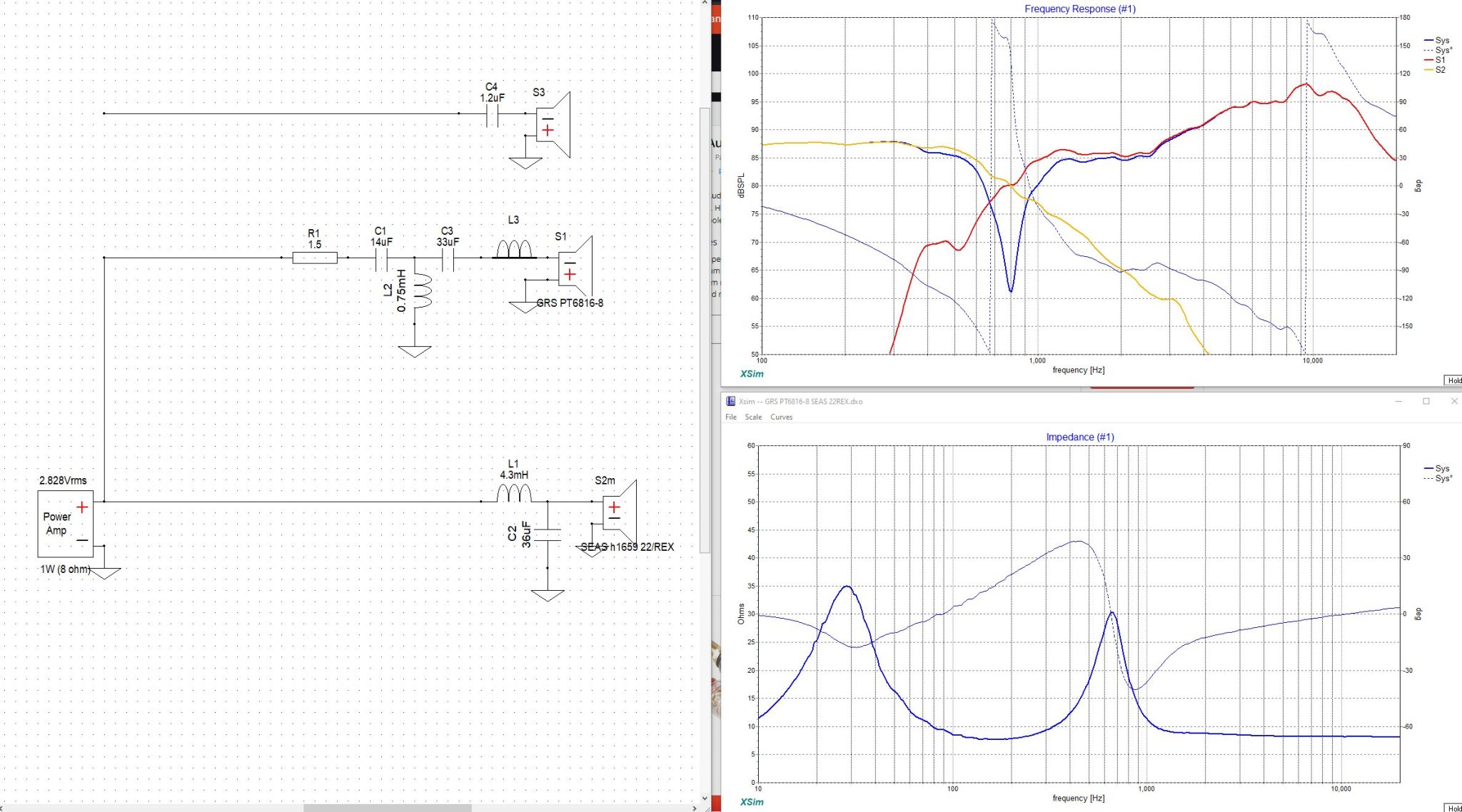

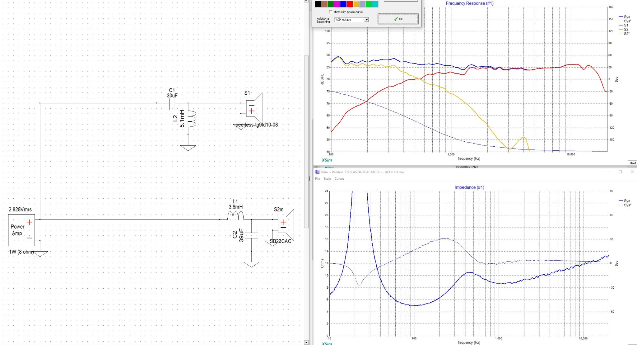

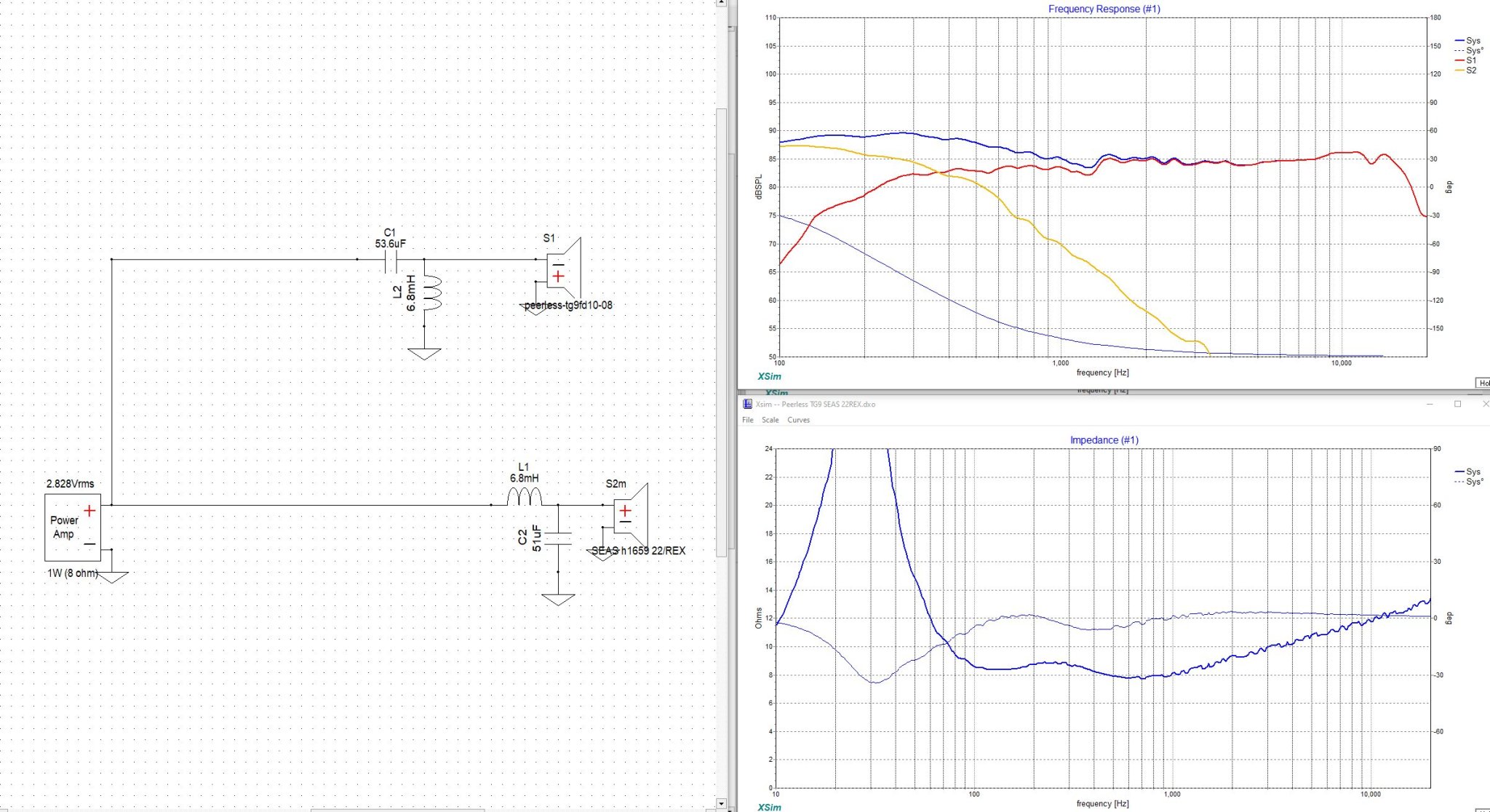

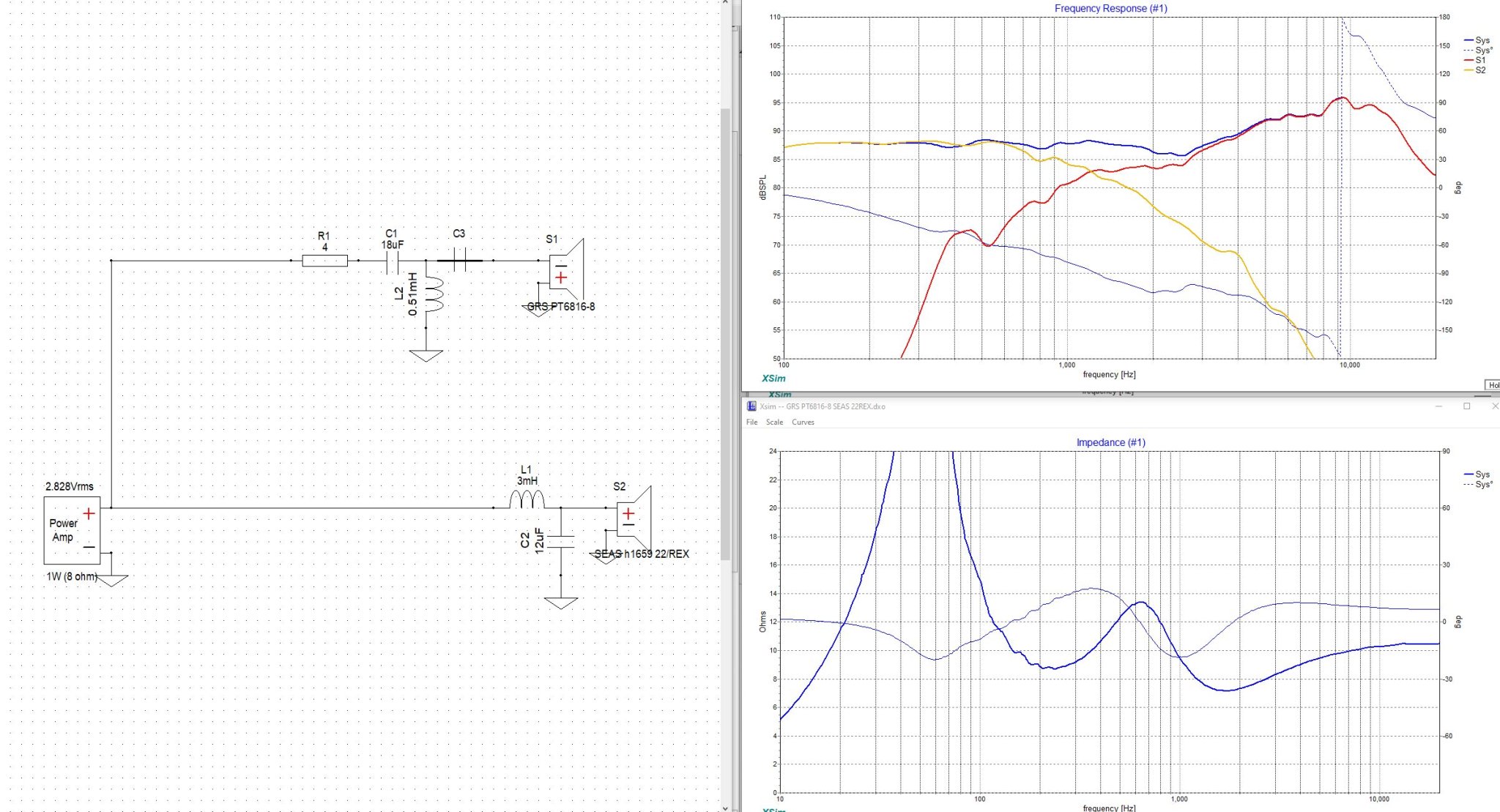

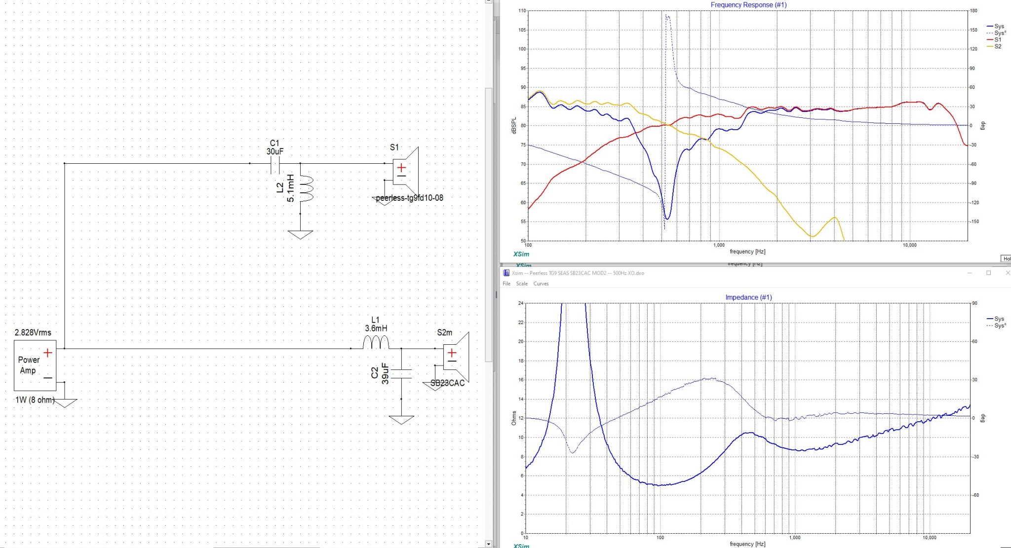

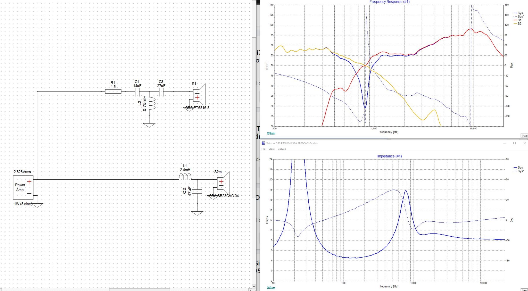

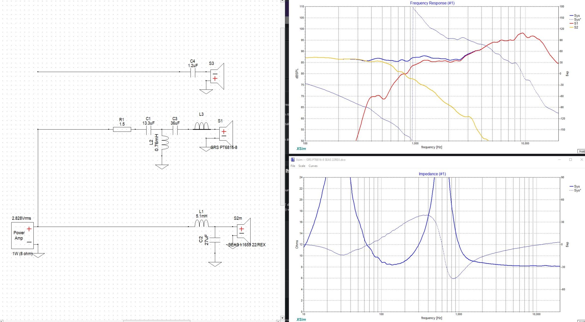

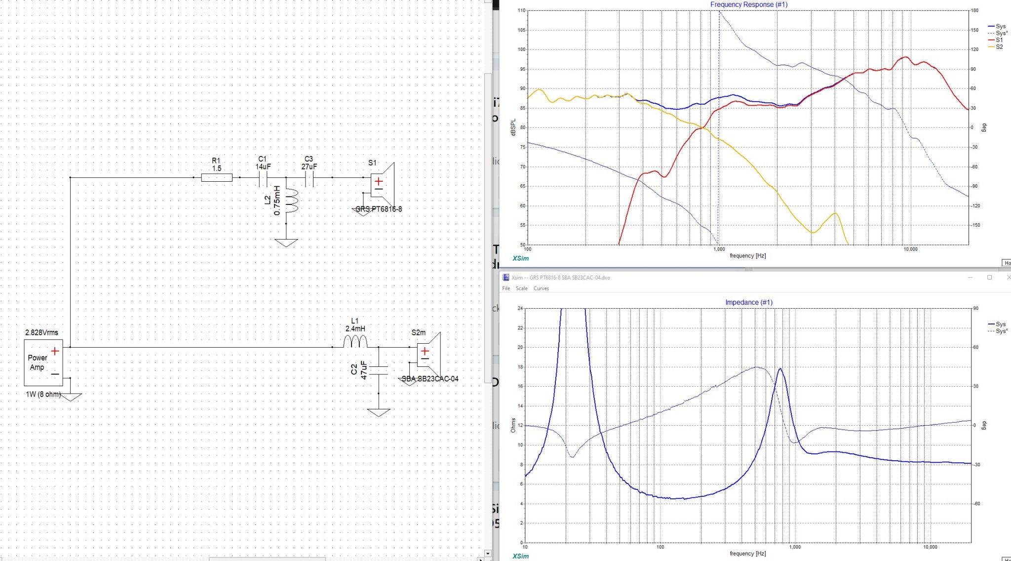

Attached are some of my designs (with help from other designs of course).

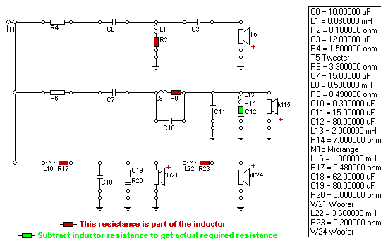

I don't recall the names of things
https://www.diyaudioandvideo.com/Calculator/ParallelNotchFilter/
Those have huge caps, especially when I input Qms.
I don't believe in those filters, the series notch, specifically; but graphs look good except for the high frequencies, no?

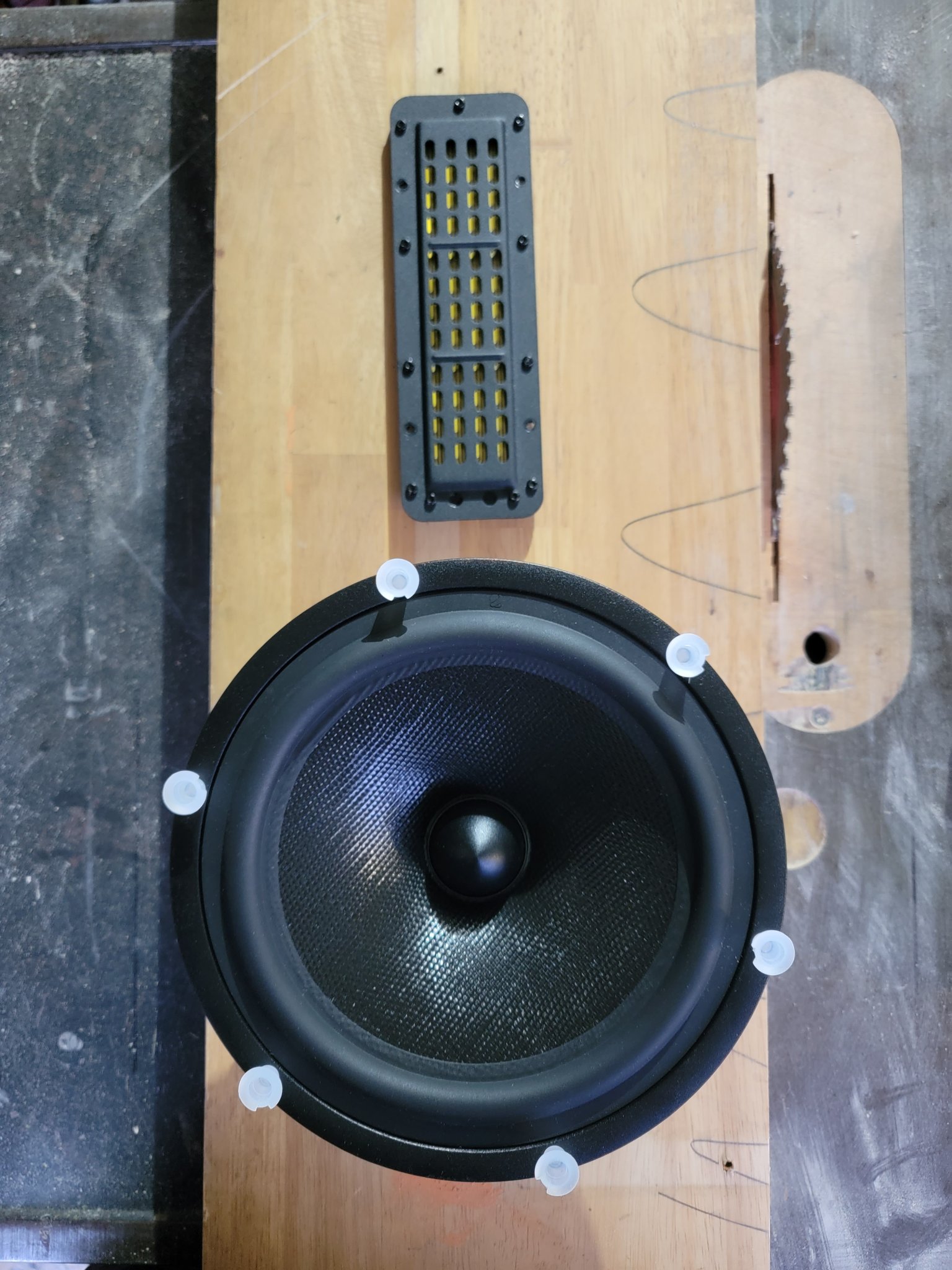

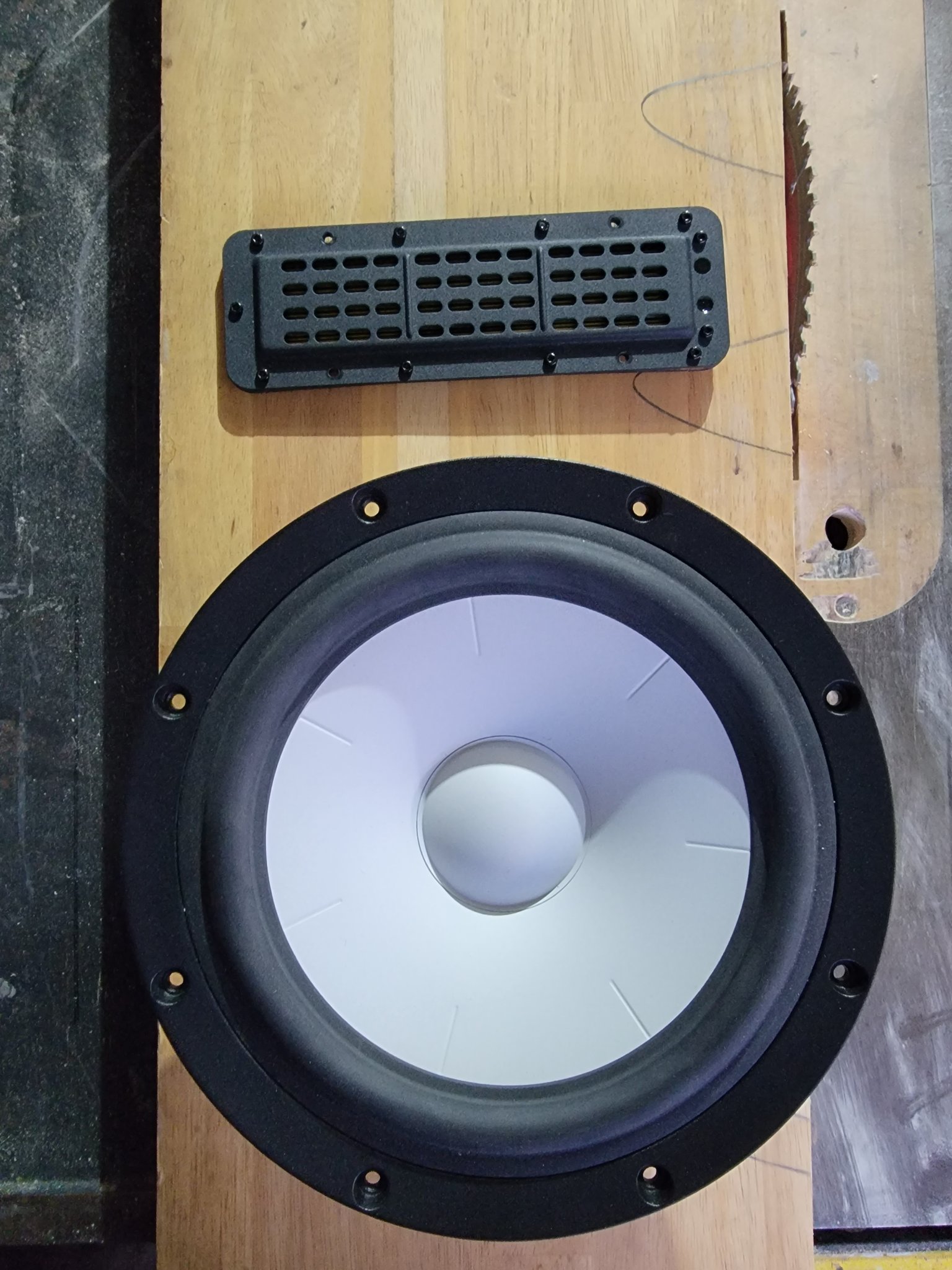

Try to mount long ways on the top, 200 mm sideways across the top, looks cooler, and bird wings in the back with wool socks or similar material on the far thirds of the tweeters. 1950's or RAAL ribbon tweeter style.
I think that will help with horizonal dispersion and top octave rise.
I'm going to **** it up to some degree, but ribbons sound pretty good.
I was thinking of buying GRS neo3 and neo8, but then I have to wait to get them and I want to have an enclosed speaker, more or less (nothing on top).
Positive mod offset of 32 mm (1.25") of the woofer below it seems to help phase alignment if I'm using that term correctly.
Series Notch Filter?
Parallel Notch Filter?
https://www.diyaudioandvideo.com/Calculator/SeriesNotchFilter/https://www.diyaudioandvideo.com/Calculator/ParallelNotchFilter/

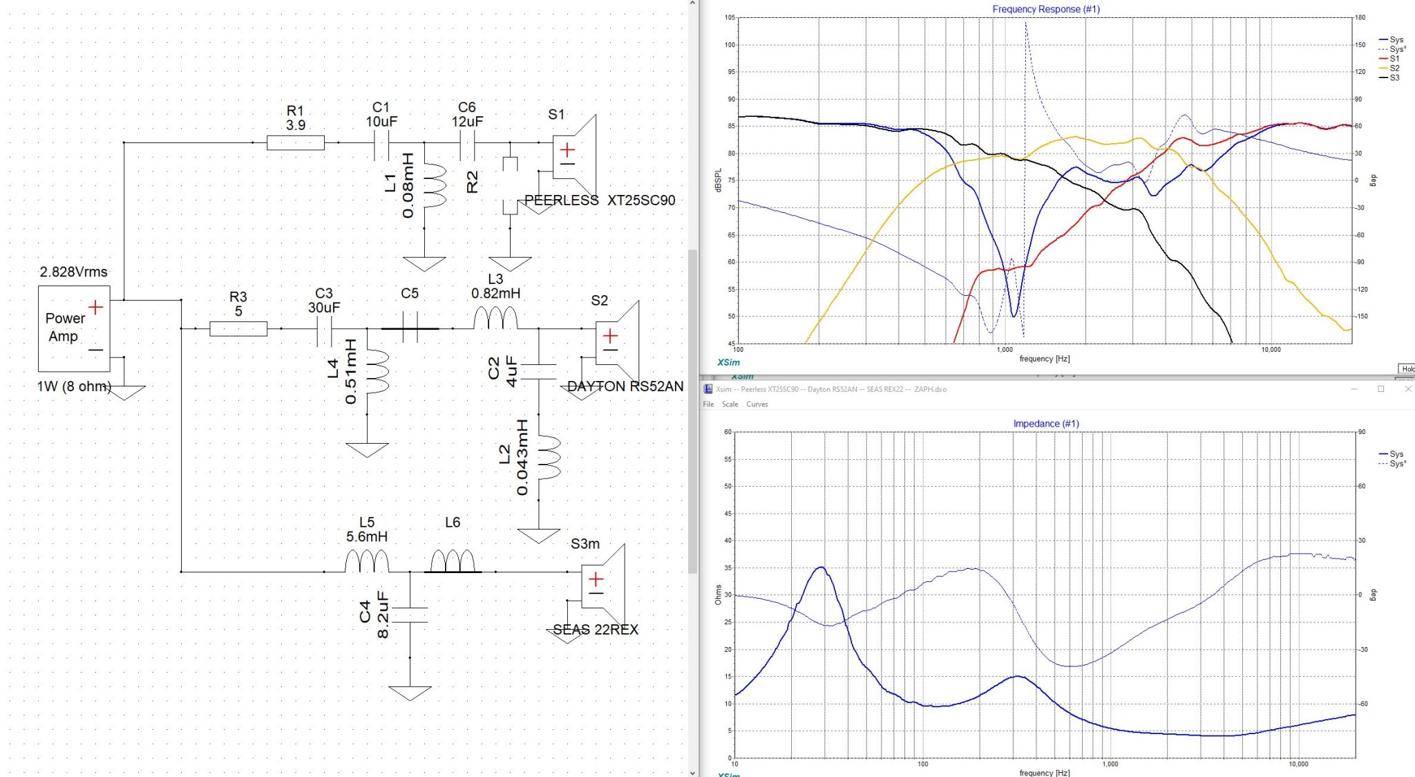

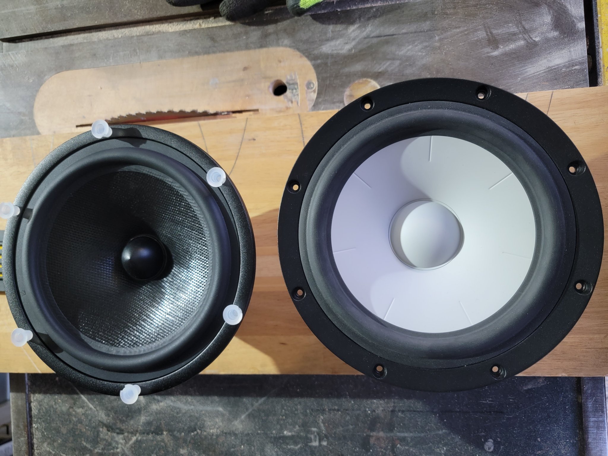

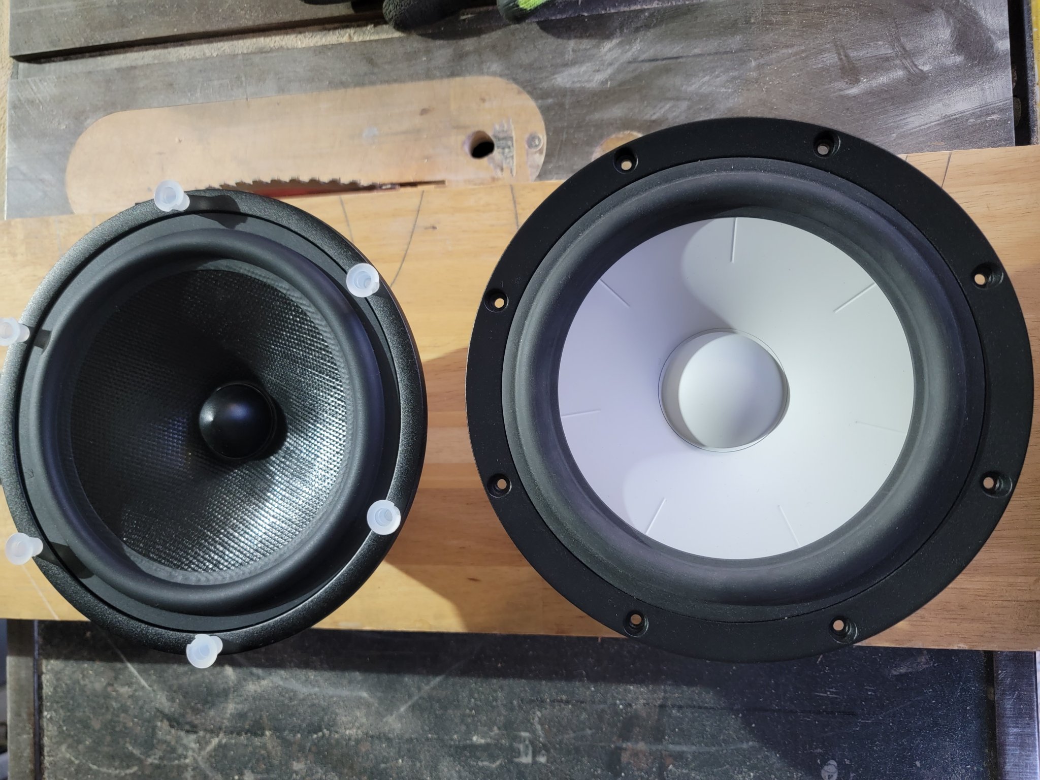

That's a poor comparison. The RS52 data sheet states it's usable frequency response starts at 500hz. And of course the manufacturer's claims are always a little exaggerated, so it's more like 700-900hz.Although I was shocked recently at how much better (more realistic) an open air GRS sounded than a Dayton RS52
Crossed over at 300 Hz, there was no detectable distortion in the GRS and the Dayton sounded like a dome in a high Q enclosure, I think.
My guess is you'd still prefer the GRS, but your comparison above isn't fair.
Yes, the GRS is pretty life-like.

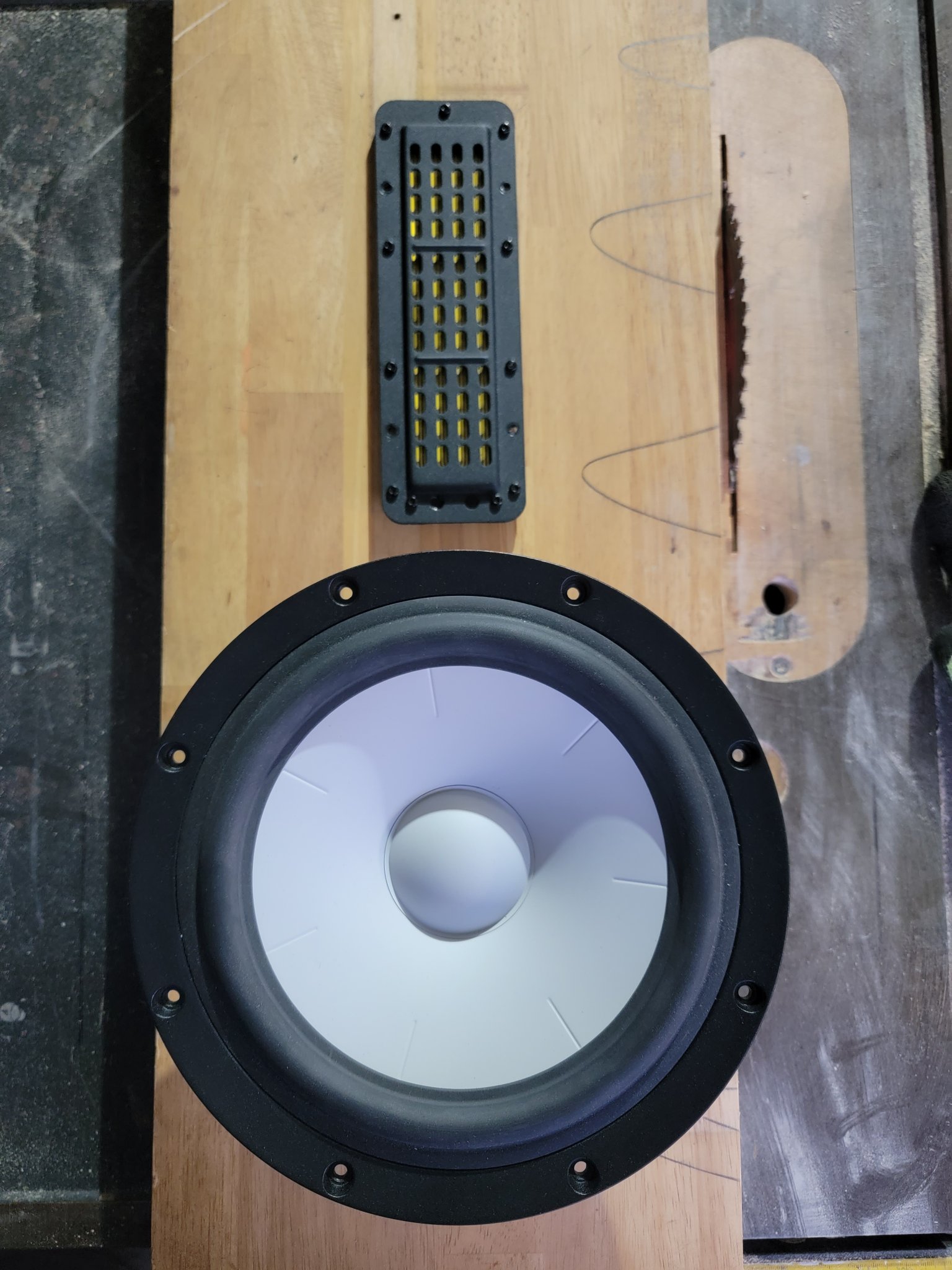

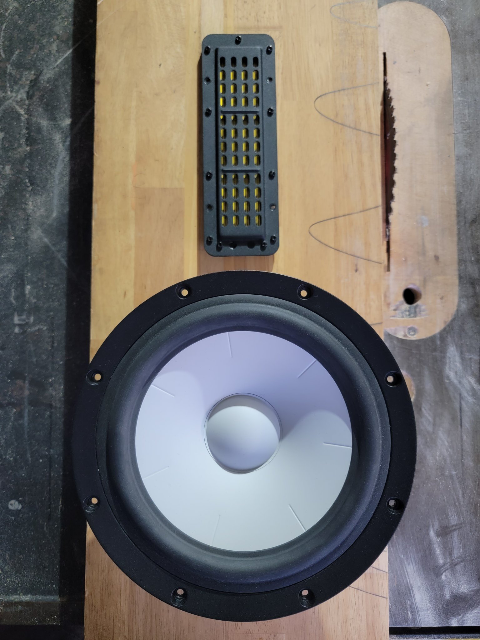

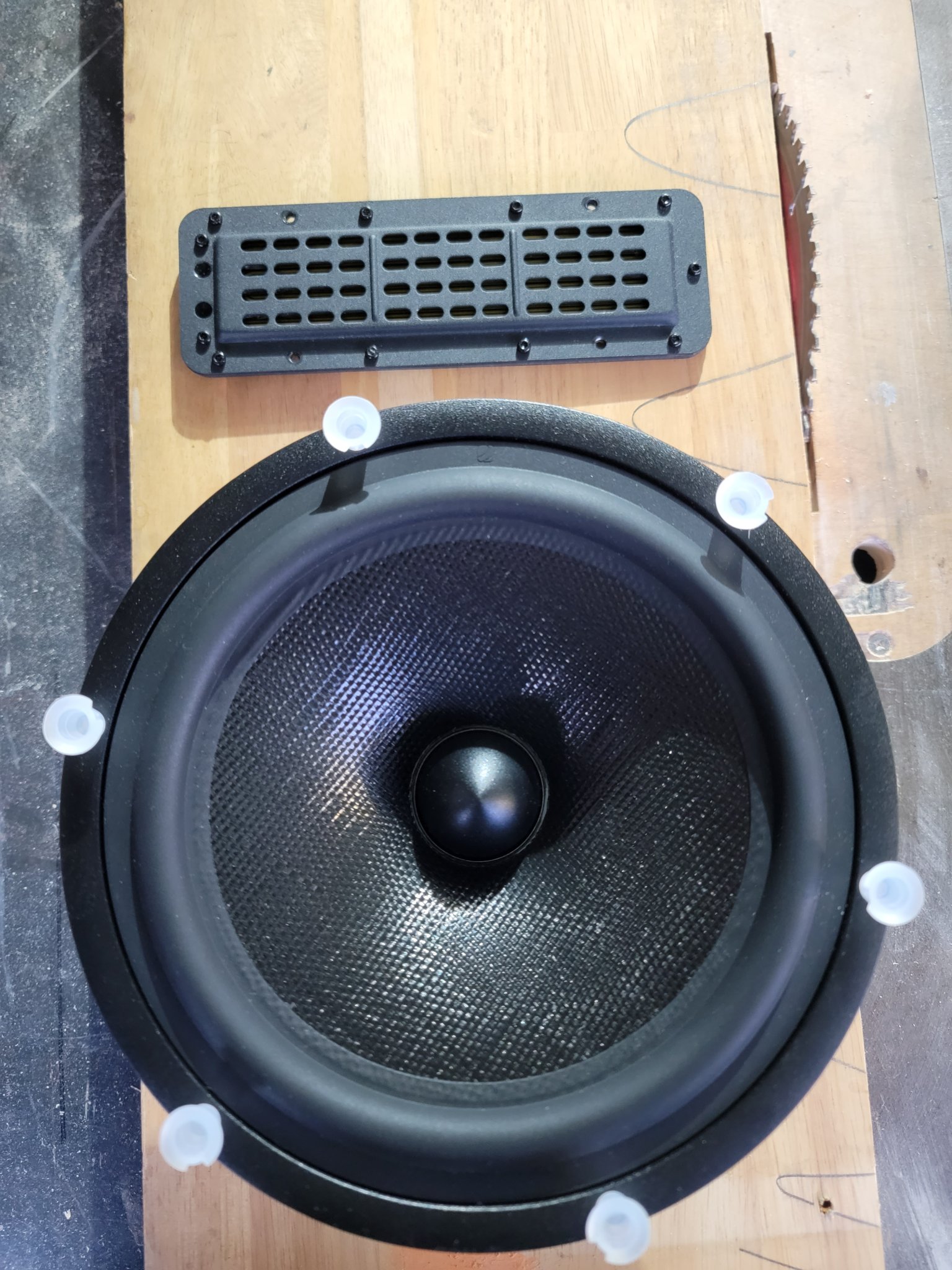

I don't know if I should mount it horizontal or vertical.
I'm going to cover the thing with a sock or something similar; not sure which frequencies that affects.
My hat I wear in the winter tells me the high frequencies
but not sure which.
I guess it depends on the thickness and material.

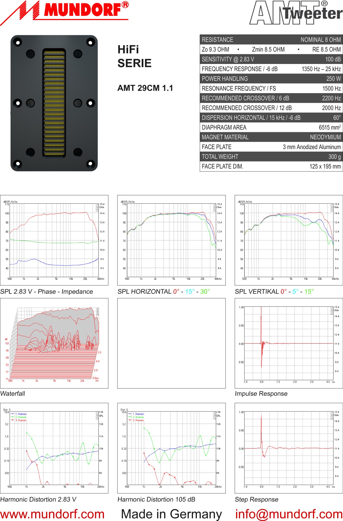

Attached are some Mundorf FR graphs of their 200mm AMT drivers.
Seems like the GRS I have (depending on what the socks do) would benefit by being mounted horizontally, looks wise also, IMO.
Also the woofer would be closer.
If it's like the Mundorf, right between 5-15 degrees horizontally mounted it should be pretty flat.
Which is probably where I will be.
But the highs of the GRS aren't like a dome tweeter, they don't irritate me.
GRS highs, even on this 52 cm^2 Sd driver are better than or similar to Tymphany/Vifa/Peerless XT25 tweeters.
It's mostly the looks that bother me mounting it vertically.
Also my speakers are only 30" (76.2cm) tall and that will push the woofer into the middle of the speaker.
What you think? Mount it vertically with the socks on?
SB woofer looks so good, but not sure it sounds very fast.
Goes really low though.
I have a 1.5 cu ft. (42.5 liter) box with a 231x19mm port that's 686mm long in the back.
I only want to hear it a little at 20 Hz with the Seas, but with the SB I will hear it a lot I think.
Started out with different drivers when I built the box.
