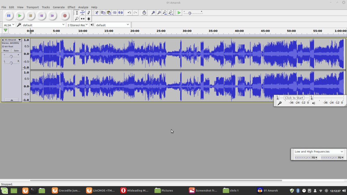

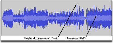

Noting as always, the media you then play, limits the level , to 0.316v RMS aka consumer line level. In the case of streaming most providers abide by -14LUFS which is almost identical to consumer line level.
