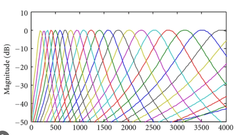

ERBs (https://en.wikipedia.org/wiki/Equivalent_rectangular_bandwidth) seem to be at the heart of understand best known to date psychoacoustic science re phase/group audacity.
The amount of phase rotation from one end of an ERB to the other end, seems to be the determinant. (recommend searching J.J Johnton's posts on ASR)
Since the ear's ERB's bandwidth widens with a decrease in frequency, it makes the likelihood of phase audibility aka group delay, greater with lower frequency.
The fact that a xover's group delay increase with a decrease in freq, double downs on the odds of the likeliness of low frequency audibility.
I've read a number of pro-audio techs who have experimented with reducing phase rotation as low in freq as possible, report positive audible improvements.
Certainly more low-end research is needed ,imho.
I think the high end, like at 1000Hz or above is fairly well researched (much easier to research than the the low end).
The ear's ERB's at higher frequency seem to be sufficiently narrow to preclude phase ability...like CharlieLaub was showing..
ERB widens with increasing frequency.

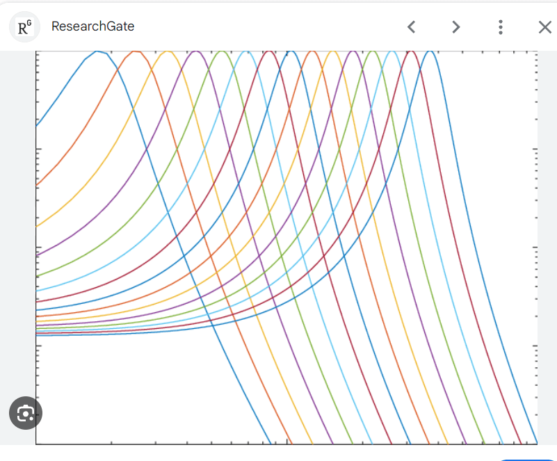

Ok thx. Here's the ERB chart from that link. Linear frequency scale.
Here's from same site. Log scale.
Which is the scale that supposedly matters in audible phase detections. As in how many degrees of phase rotation/tilt, are there over the octave width of the ERB, when comparing the lower frequency end of the ERB to the higher frequency end.
