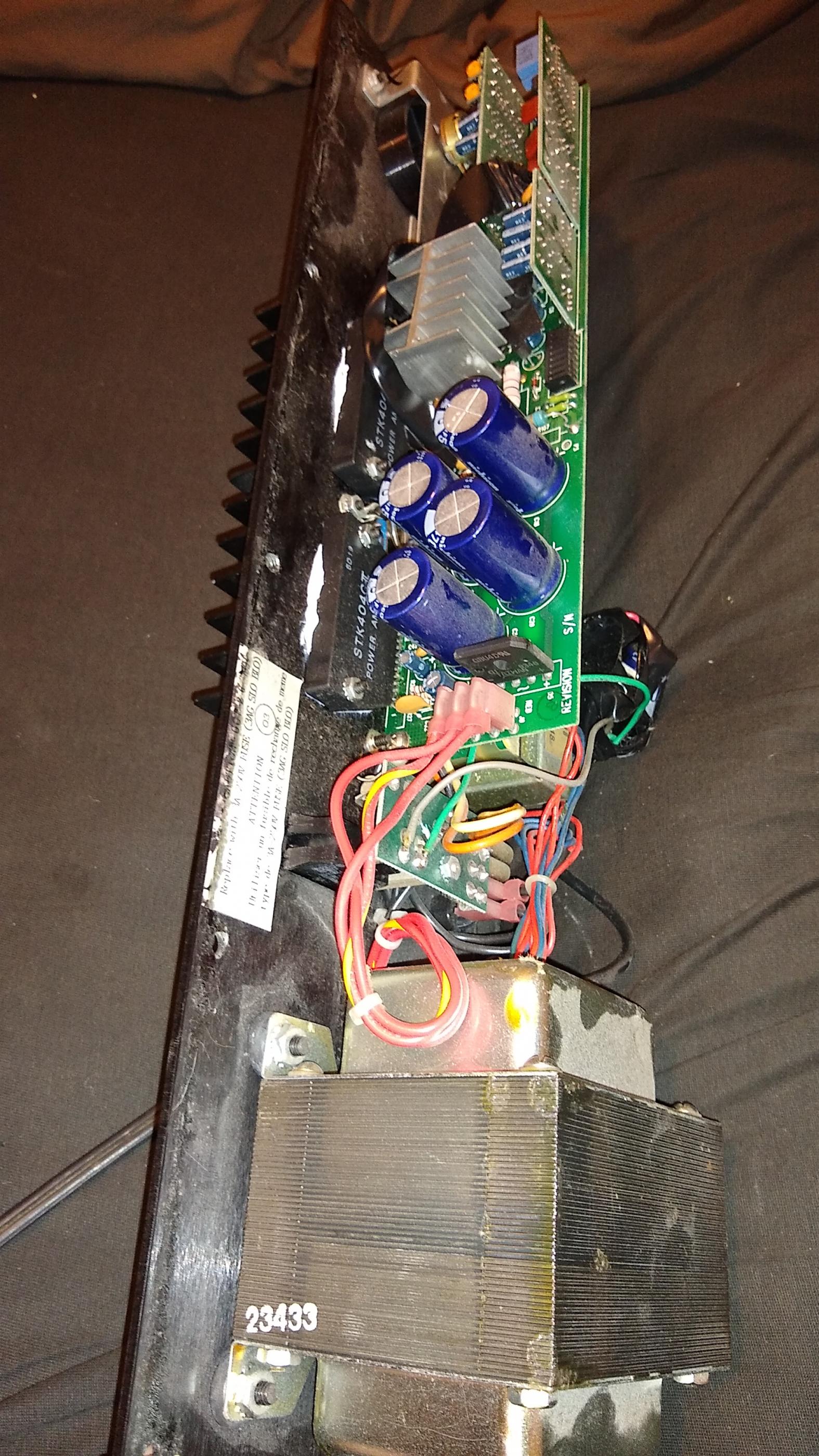

Attached are images of velodyne amp. Maybe we can estimate real power
output
4 50v 4700uf filter caps, 2 stk4040ii power amplifiers

I think you will be fine - especially at lower listening levels.
That original amp only has a 70-watt chips (at +/-42vDC and 0.4% THD), so with 2 in bridge configuration, you might get 100-120 watts clean power from the Velodyne amp, so you are going to have close to the same power.

Issue with fsr-15 was that dc voltage oscillated +-.7v and woofer was moving in and out at around 10hz frequency. Oscillation was only noticeable when woofer was out of the box.. when sealed can't see oscillation with your eye. I recapped amp and replaced 2 transistors that ran very hot(traces of overheating on board). But issue still remained.

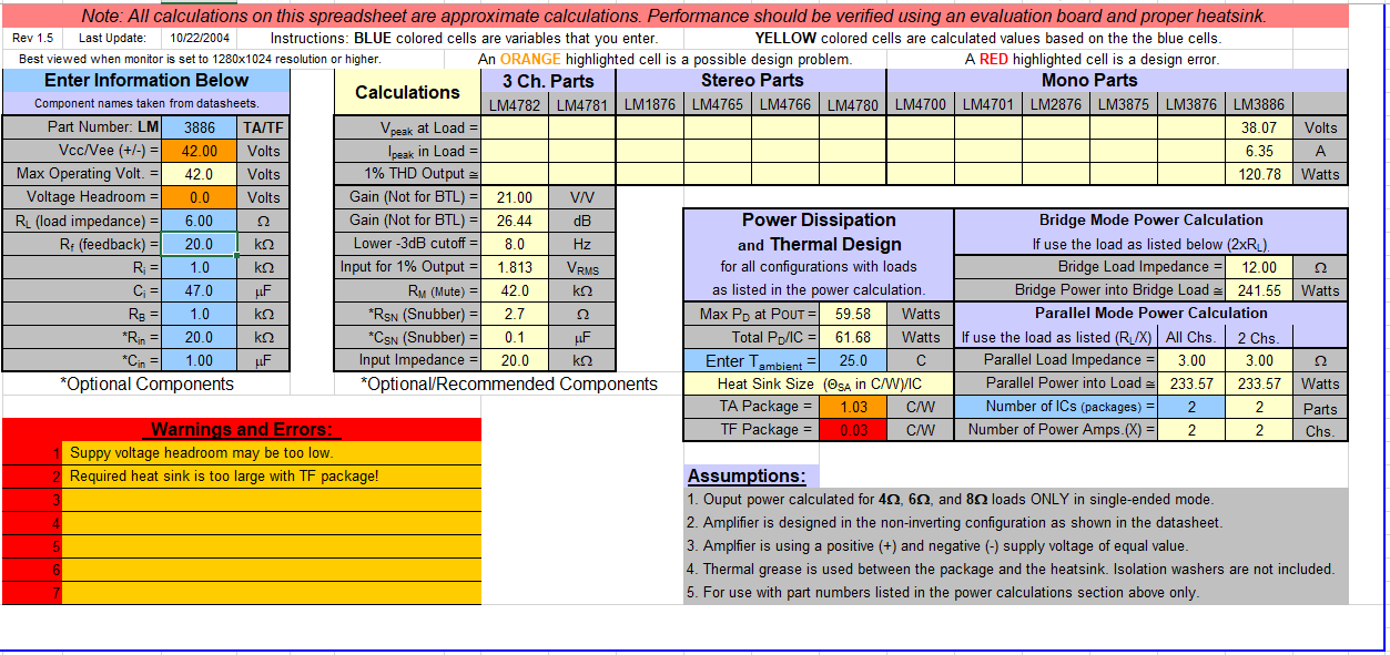

that heat sink doesn't look sufficient for bridged operation. At +/-42VDC you need a heat sink with thermal impedance less than 1.0 ohms. I pulled down the Nat Semi Overture design guide -- as the same analysis applies for the STK parts:
