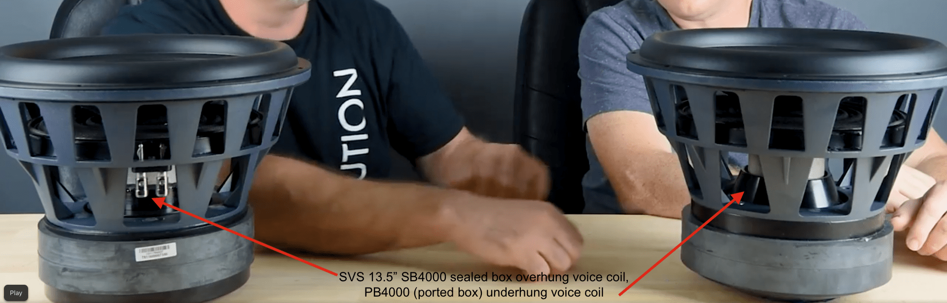

A new question, Would an underhung woofer play better in a sealed box with lots of damping material (50% or more of the box) than an overhung woofer?
I once saw a video from SVS saying that underhung is more "optimized" for ventilated boxes, but I think it depends more on other parameters besides Bl.
What is "better" depends on what parameters you put the most priority to in which end of the frequency spectrum, and the volume of the sealed box compared to the Vas and Bl of the driver.
Good example of using nearly the same materials and optimizing them for a larger vented box or a smaller sealed box covering a limited frequency range.
(Sub)woofers covering the decade from 15Hz to ~150Hz will have much different design parameters than a wide band woofer required to perform well in the decade from 50-500Hz plus two more octaves to 2kHz.
Not to say that a 50-2kHz driver with ~40mm Xmax is impossible, but practically with current materials, one that performs well at 2kHz is limited to ~6-10mm Xmax.
