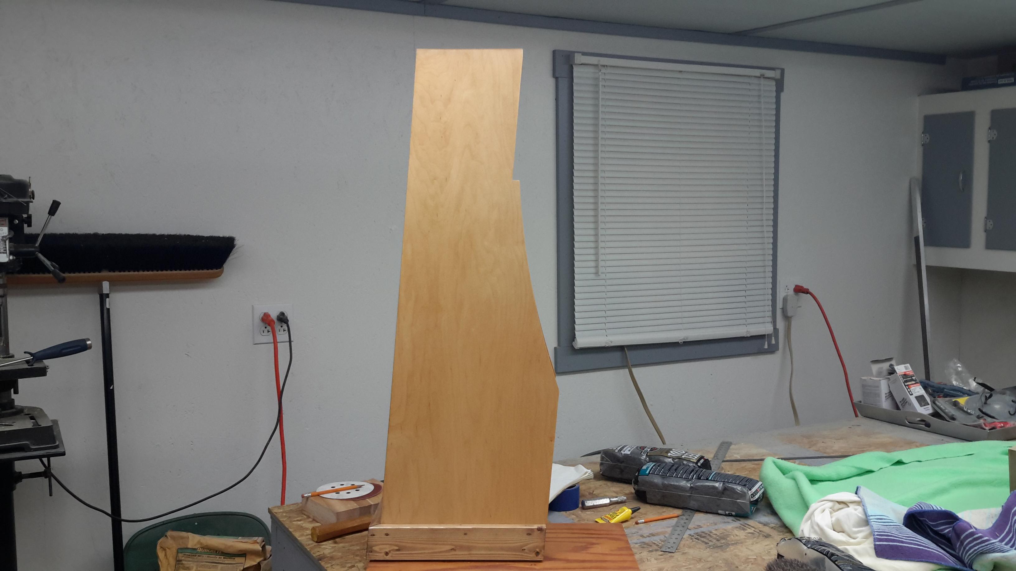

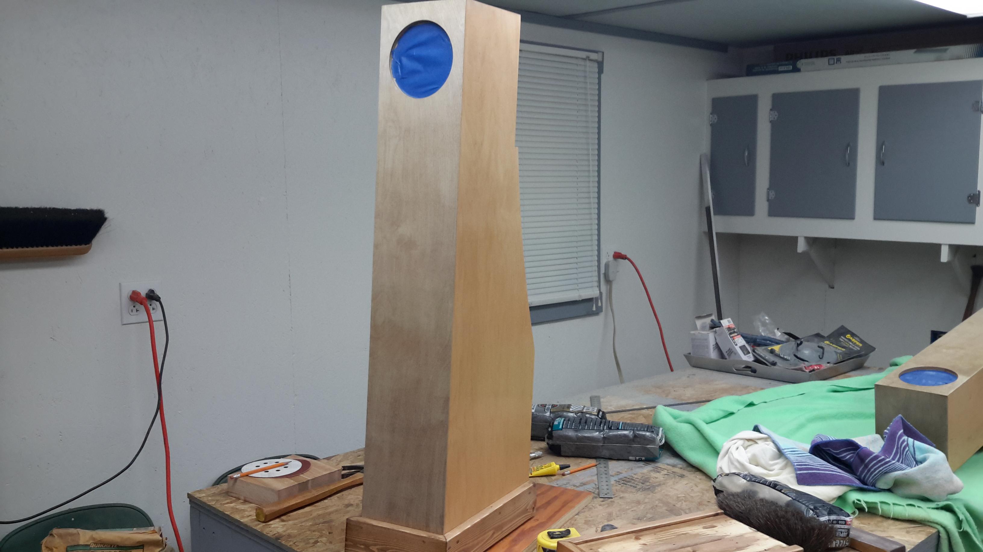

These have been modified just a tad, something I've been kicking around for a bit.
The top 9 1/4 inches have been trimmed parallel on the front/back, with a little ledge left at the bottom of the back cut. Then trimmed the flare at the bottom off a little and made some bases 2 1/4 inches tall.
The reason- I routered a couple of holes just the size of the top of the horn, toed in a few degrees, into a 30" x 60" x 1 3/4" butcher block maple cabinet top. I am going to slip the horns up into those holes until it stops at the ledge on the back. This will leave 7 1/2 inches of the speaker sticking up through the table top, but puts the top at 27 3/4 inches, so that's where the bases come into play.
With the entire curved flare on the bottom, the desk would have to set out away from the wall too far, or the speakers would have to be moved too far forward on the desktop. These will be the rear legs, I have adjustable Ikea legs for the fronts.

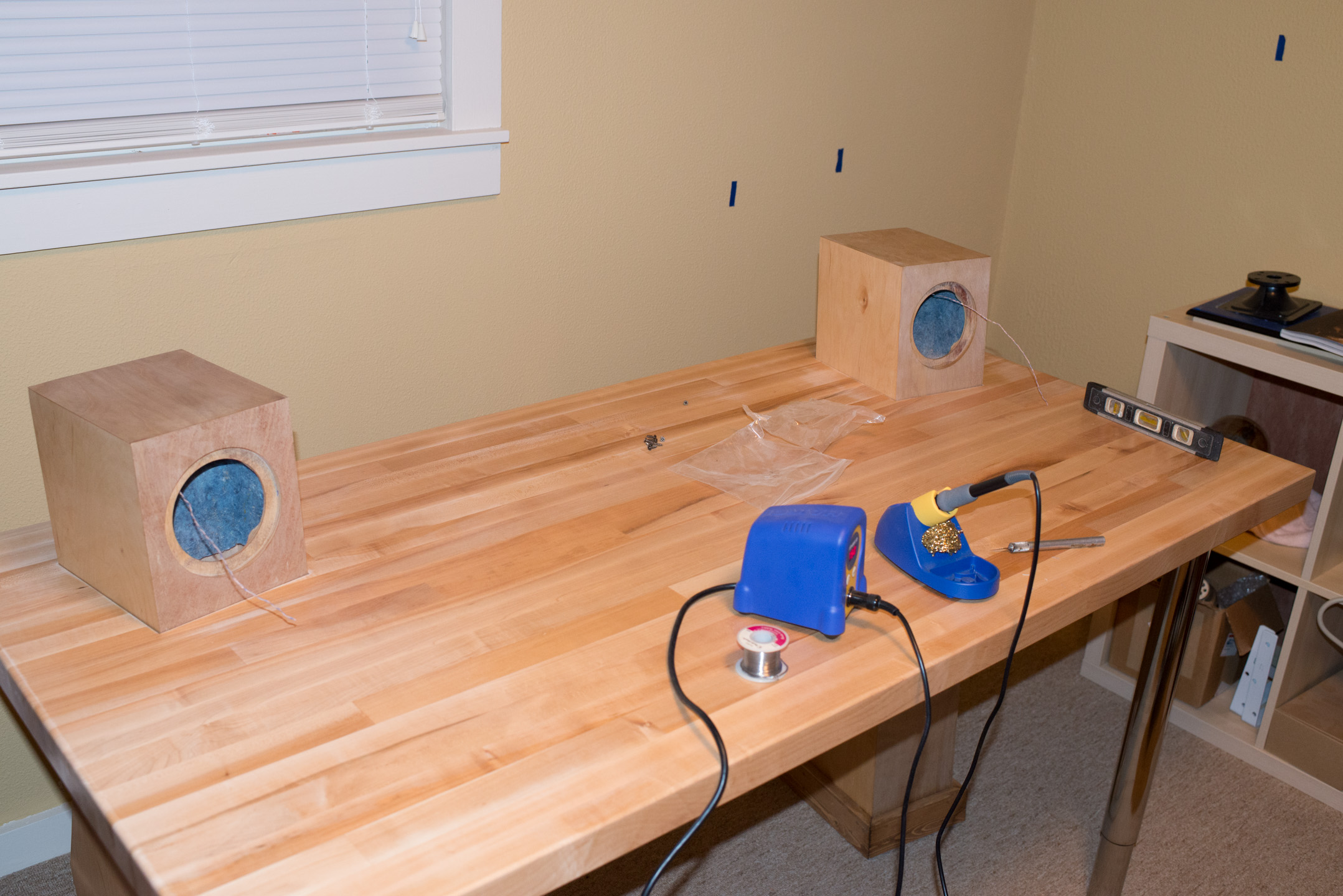

Computer desk here one of these days, I just thought I'd better get some pre-assembled shots for context, these have a few coats of super blonde shellac, the fronts and tops veneered with 1/64" birch ply - wouldn't use again, very thin plys.
I could upload the pics of the speakers, but get a size violation with the desk pics, ànd they are smaller. I'll use a camera next time ànd resize them.

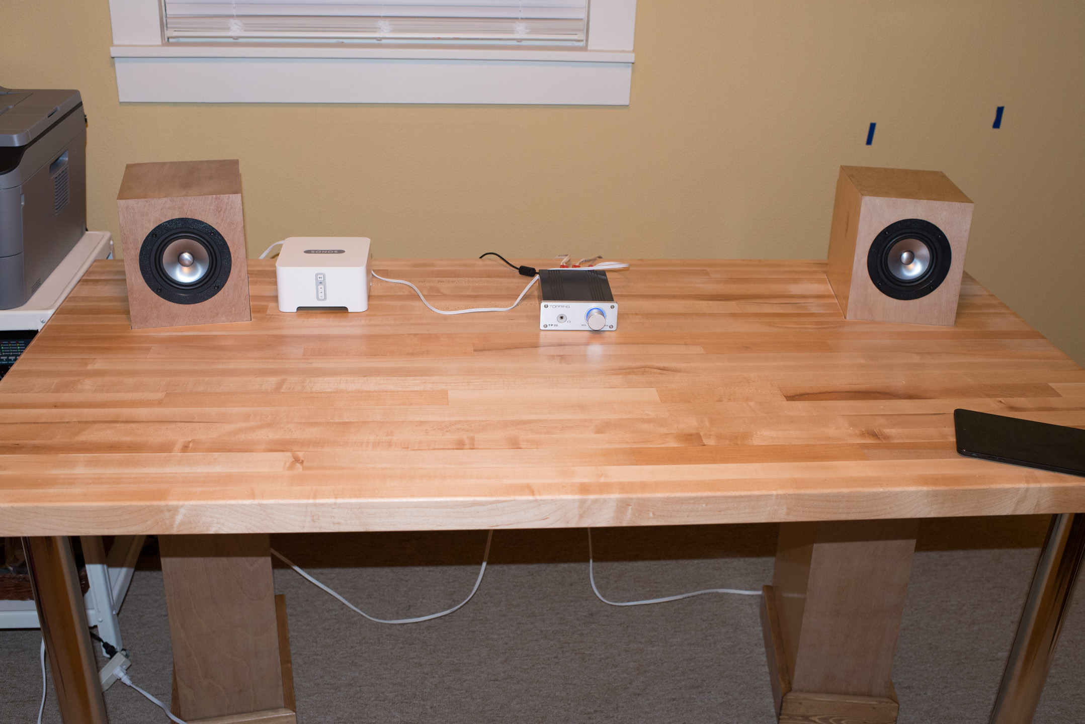

They have the full amount of stuffing in the front chamber, I think they are near perfectly balanced. The drivers don't have much time on them, but "Flight of the Cosmic Hippo" reveals that they really can produce surprising bass at even low volume.
The imaging is spot on, I have to wonder if the desktop surrounding the columns isn't helping, in a near-field sort of way. And the toe-in seems to be spot on (good thing, huh), it's like the computer screen is the source.
This is exactly the effect I was going for, killer computer desk sound.

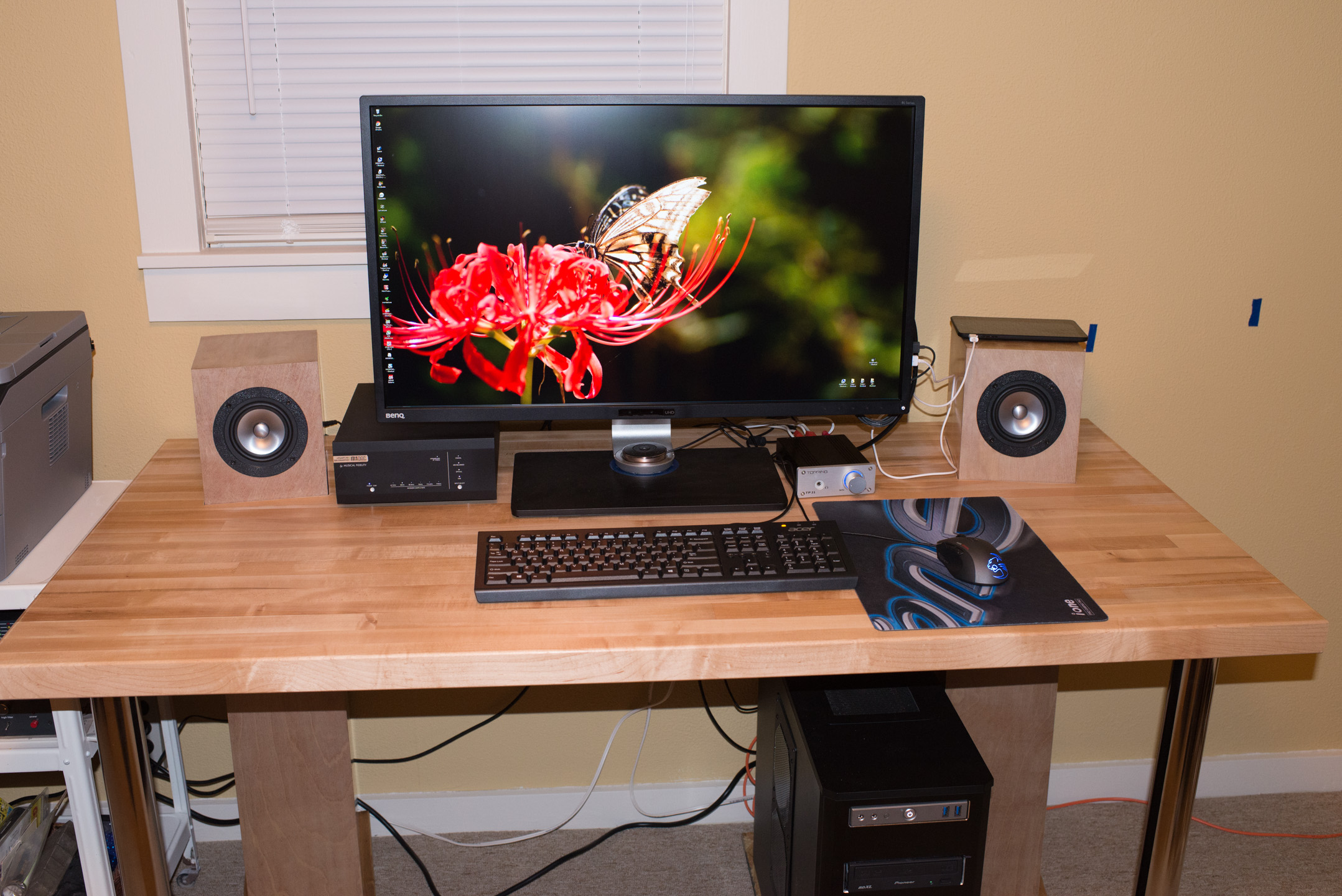

Thanks, it really turned out even better than I had hoped. I wasn't sure the little ledge would be enough to keep the whole mess stable, but it does a good job as long as the towers are carefully leveled. Adding cleats to the sides of the speakers to would be easy and would make it a lot simpler to get steadied up.
I have a pair of Perreaux SX60M amps that do a better job than the little Topping, but lack the volume control knob - a feature I just about have to have. I use USB for computer sound (and can control that volume on the mouse), but have a Sonos connected to the coax in of the DAC so it can double as a stand alone stereo. I thought I'd try the Emotiva Control Freak between the DAC and SX60Ms instead of a passive pre. I tried a LDR volume control, but the gain structure is out of whack and the lowest volume level was way too high.
Anyway, the CF is supposed to be here tomorrow, I'll post a pic of the finished product then.

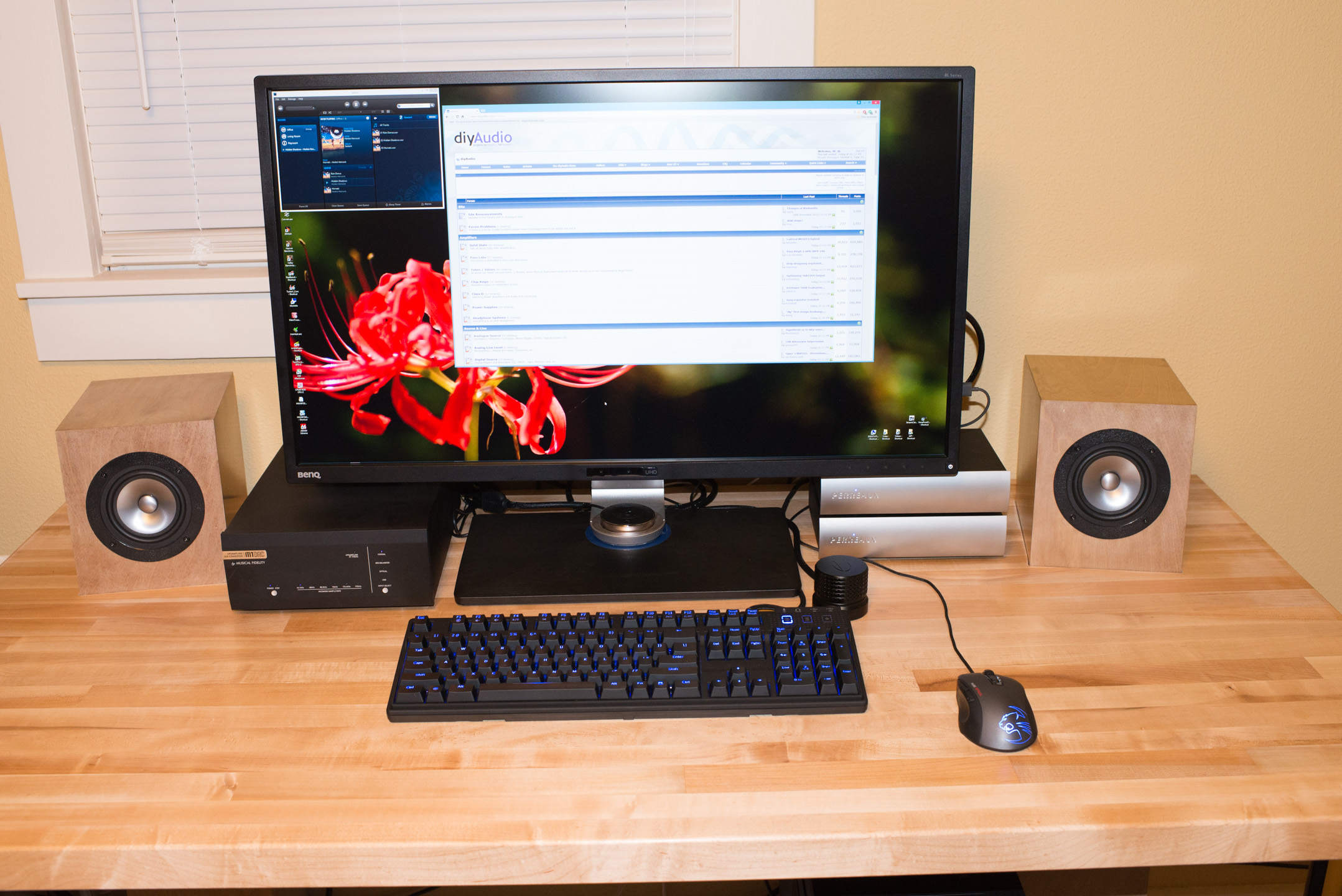

Anyway, it's done. The little Perreaux amps are definitely a step up, and even though Amazon sent me the wrong Control Freak, it's up and running.
I like that Control Freak. I didn't know what to expect, but it's just what I wanted it to be.
That DAC, those amps, and the Frugel-Horns would make a pretty good system in its own right.
