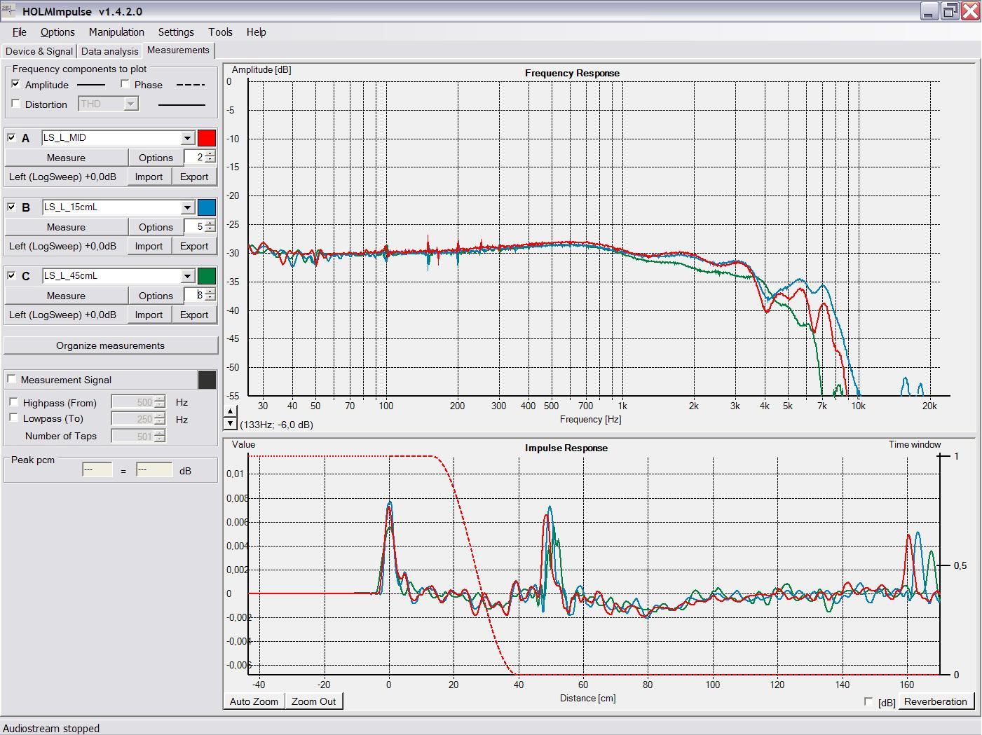

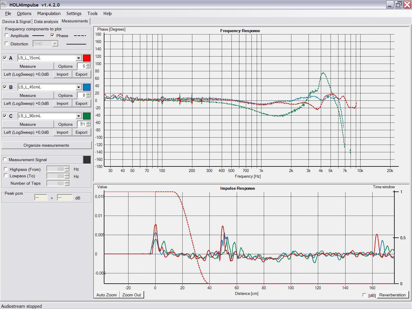

This needs some explanation! I see "LS_L_15 cmL" measured three times with different results 😕. And why aren't left and right of equal value when measured from the center position? I'm more confused than enlightened 😱.
Rudolf
Rudolf
I will post some measurements made under anechoic (gated) conditions.
It is hard to follow which picture is which condition.
Also I cannot figure if one or two speakers are playing at the same time or not and when if yes ?

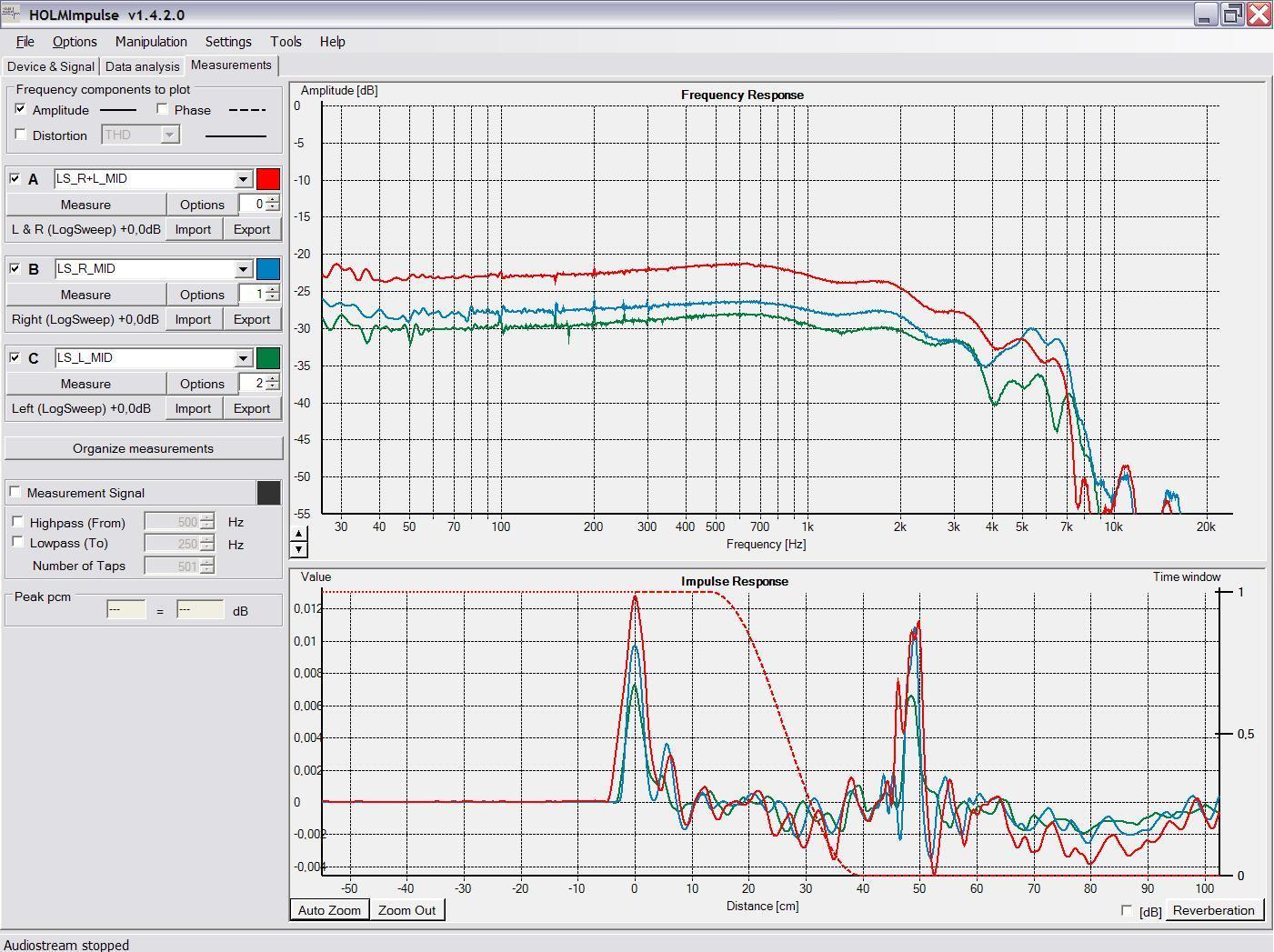

Pictures:
..amplitude in stereo center
..for both speakers, right speaker, left speaker
..centering of microphone and also toe in of speakers
..not perfect > no perfect symmetry and sum for HF
..ID
..00..red.....left speaker + right speaker (sum)
..01..blue....right speaker
..02..green...left speaker

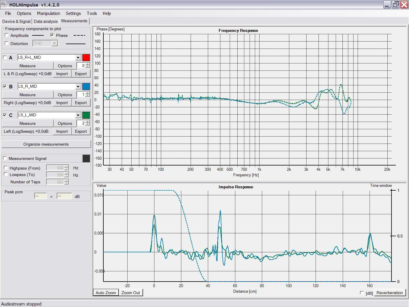

..phase in stereo center
..for left speaker, right speaker, both
..not perfect.
..ID

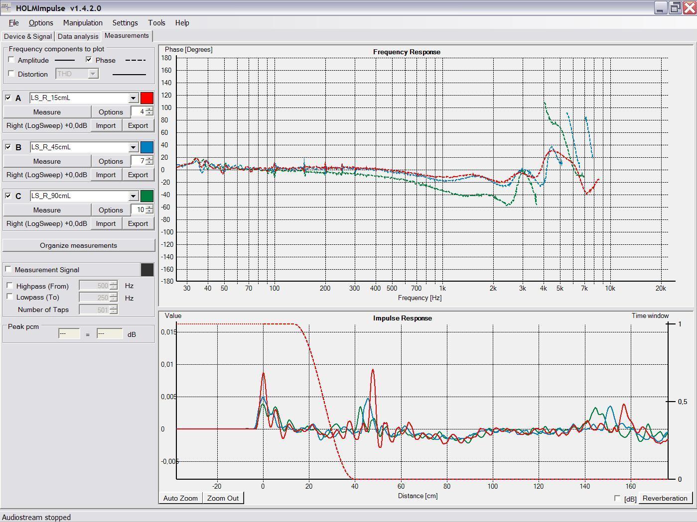

..phase, phase for right speaker when microphone is moving to the left
..ID
..04..red.....right speaker, microphone 15cm left from center
..07..blue....right speaker, microphone 45cm left from center
..10..green...right speaker, microphone 90cm left from center
..phase, phase for left speaker when microphone is moving to the left
..ID
..05..red.....left speaker, microphone 15cm left from center
..08..blue....left speaker, microphone 45cm left from center
..11..green...left speaker, microphone 90cm left from center

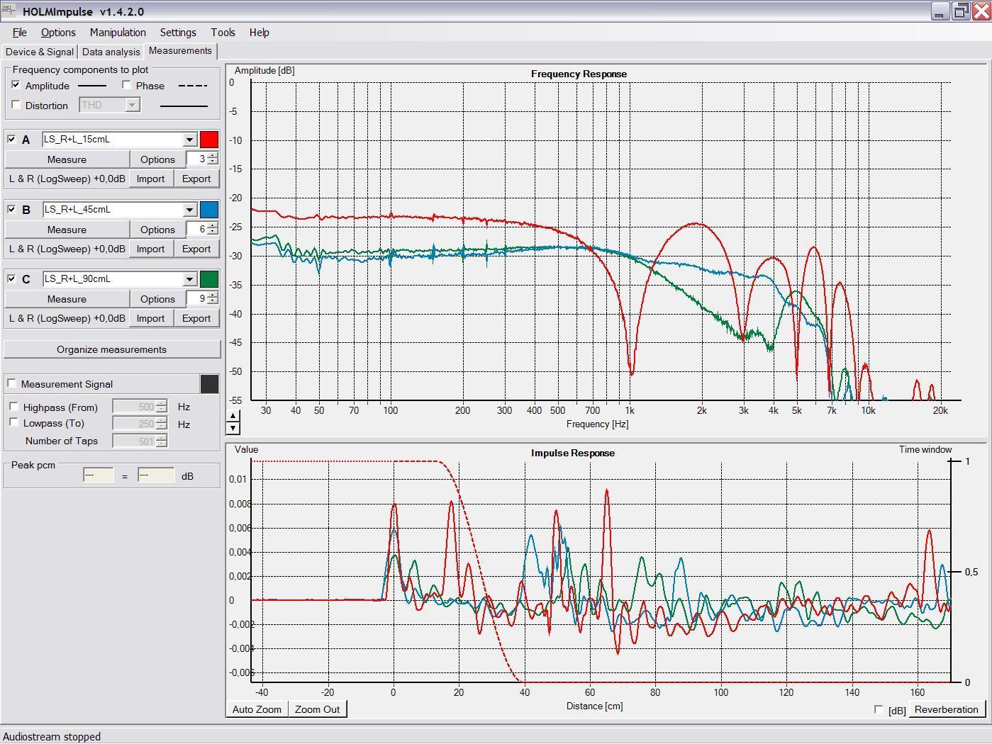

..amplitude, amplitude for both speakers summing
..combing can be observed, because even at 15cm left
..from center speakers are quite phase coherent
..ID
..03..red.....left speaker + right speaker, microphone 15cm left from center
..06..blue....left speaker + right speaker, microphone 45cm left from center *
..09..green...left speaker + right speaker, microphone 90cm left from center **
* curve meaningless, because of gating only impulse response of left speaker is shown
** curve meaningless, because of gating only impulse response of left speaker is shown
..amplitude, amplitude for left speaker at
..center, 15cm left and 45cm left
..ID
..02..red.....left speaker, microphone 00cm left from center
..05..blue....left speaker, microphone 15cm left from center
..08..green...left speaker, microphone 45cm left from center

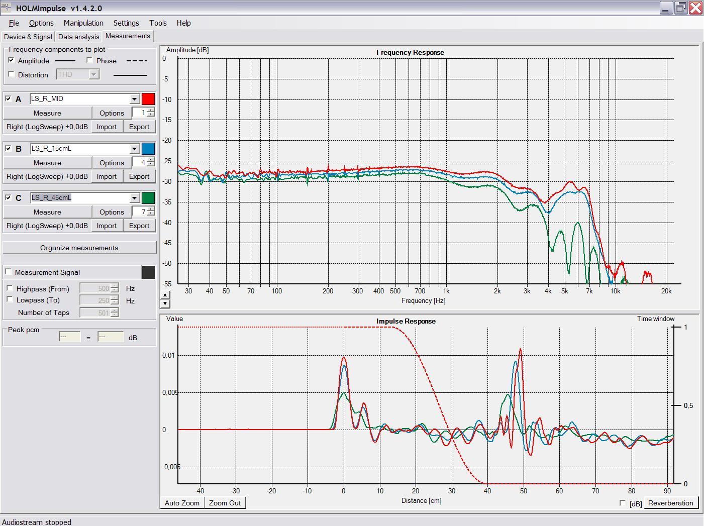

..amplitude, amplitude for right speaker at
..ID
..01..red.....right speaker, microphone 00cm left from center
..04..blue....right speaker, microphone 15cm left from center
..07..green...right speaker, microphone 45cm left from center

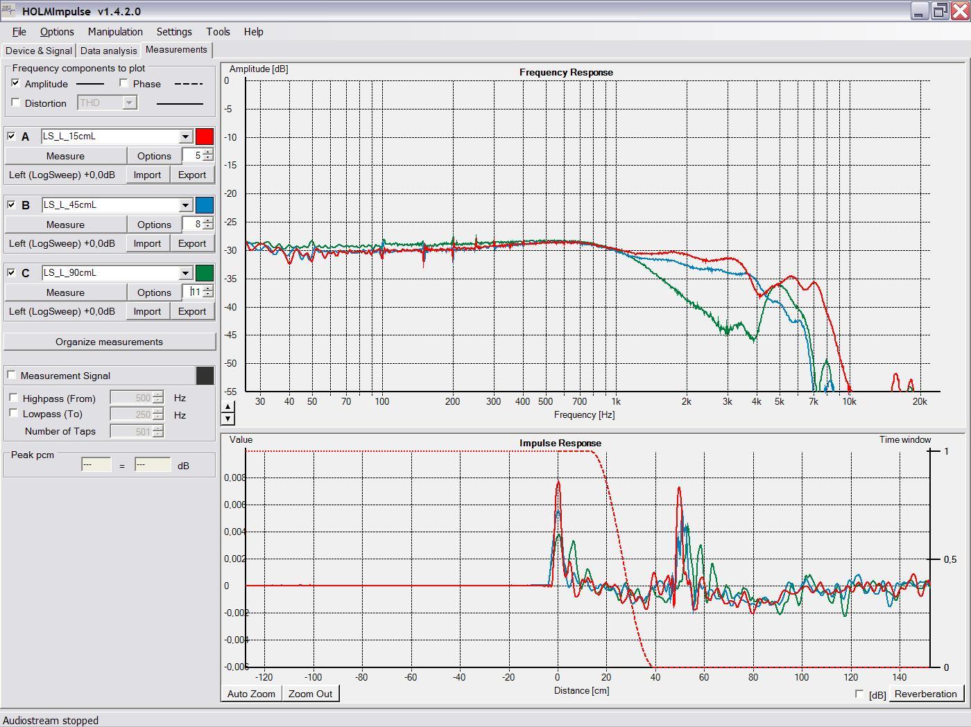

..15cm left, 45cm left, 90cm left
..ID

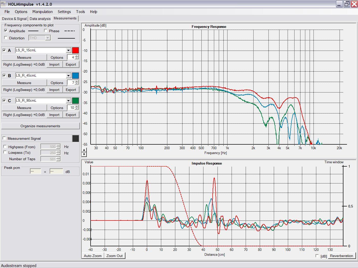

..ID
..ID
..ID

When I look at pic 8, the 90 cm (green) measurement should be next to the left speaker axis parallel to the side wall. But it has the earliest high frequency roll-off. Must have to do with the speaker to-in. But it is difficult for me to visualize the situation.
What should I see, that could not better be explained by speaker off-axis angles than by distance left from mid position?
It has to do with toe in. Nevertheless the dispersion at HF is widened
again, although the system is fullrange (has no tweeter and no
crossover frequency).
Nothing at a first glance.
The measurements were motivated by (also earlier) discussion with Elias.
Goal was to view the phase decorrelation patterns at distances and angles
in a usual stereo triangle situation. The price to pay was using a rather
short time window of course.
Questions were
- Is there really phase decorrelation at distances larger
than the radiating memrane's dimensions ? (Yes)
- Is there also phase decorrelation affecting interference
between speakers at the stereo center ? (No, because speakers are
quite coherent at small off axis angles)
What we can see now is how closer and farther speaker decorrelate when
moving out of the stereo center.
The speakers are pair symmetric - there is a dedicated left and right one -
but they have a broken symmetry in themselves. That means phase and amplitude
patterns change in a different manner for the closer and the farther speaker,
when moving out of center:
See Picture 03 vs. Picture 04
Note that the phase patterns remain more coherent for the left speaker,
although the angle is changing more rapidly for the left speaker
(because it comes closer and both speakers haver been toed in to aim
at the stereo center).

I think the most interesting is figure 5 red curve.
It shows comb filtering when both speakers are playing, so as you noted the phase is quite coherent close to on-axis.
We can ponder if this is necessarily good behaviour ? It would be nice to have more phase decorrelation very close to on-axis to prevent interaural comb filtering. Because, I think, this comb filtering is the main reason for any negative aspects of stereo triangle.
Further away from on-axis the phase decorrelation seems to increase. This is good. But again, on the other hand, in a living room type of conditions, many room reflections are already quite decorrelated due to unsymmetrical furnituring features.
So, all in all, what I would like to have as an 'ideal' would be high phase decorrelation on-axis.
It is surely not the most interesting one to me, but it is important.
It shows, that the speaker is able to present a stereophonic image in a
coherent way at the stereo center, like conventional pistonic loudspeakers
too.
This was a major point criticized by Earl some time ago, who supposed
analogously "diffuse to the sides, diffuse everywhere", which may hold
for almost all primitive DML panel types, but is not the case in this
design.
Truly, you find the typical interference artefacts for small off center
deviations, if the speaker is toed in for maximum coherence:
Can't get one without the other.
To me the pictures 03 and 04 seem even more interesting, see below.
Because of the pair symmetry and different decorrelation behaviour for the
listener moving inwards or outwards the stereo triangle, you can make correlation
more "sloppy" by reducing toe in, up to even making the speaker's membranes
parallel to the stereo base.
Since radiation in upper highs in quite "diffuse ommni" there will be no loss
in "sparkle" as with usual speakers.

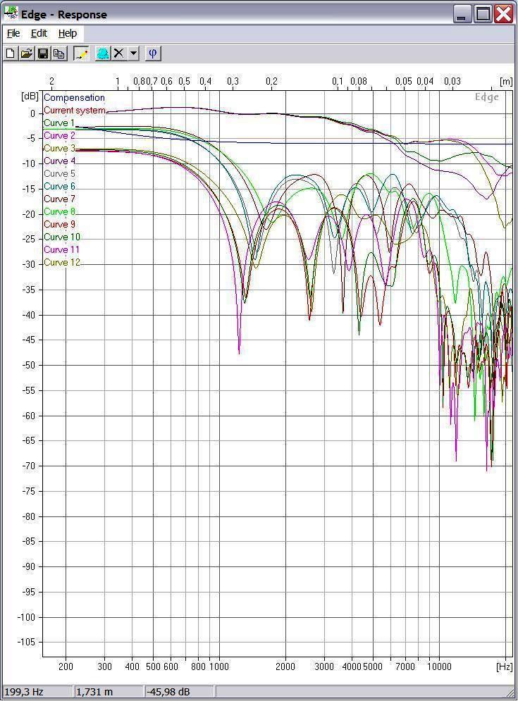

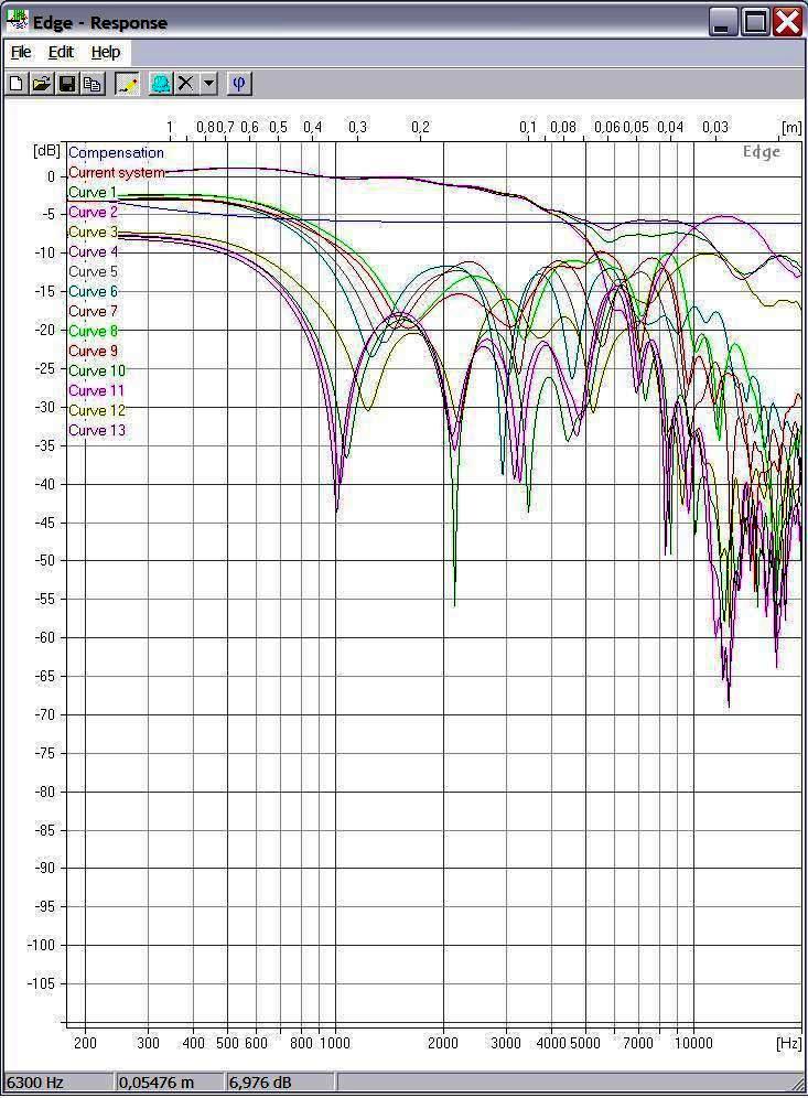

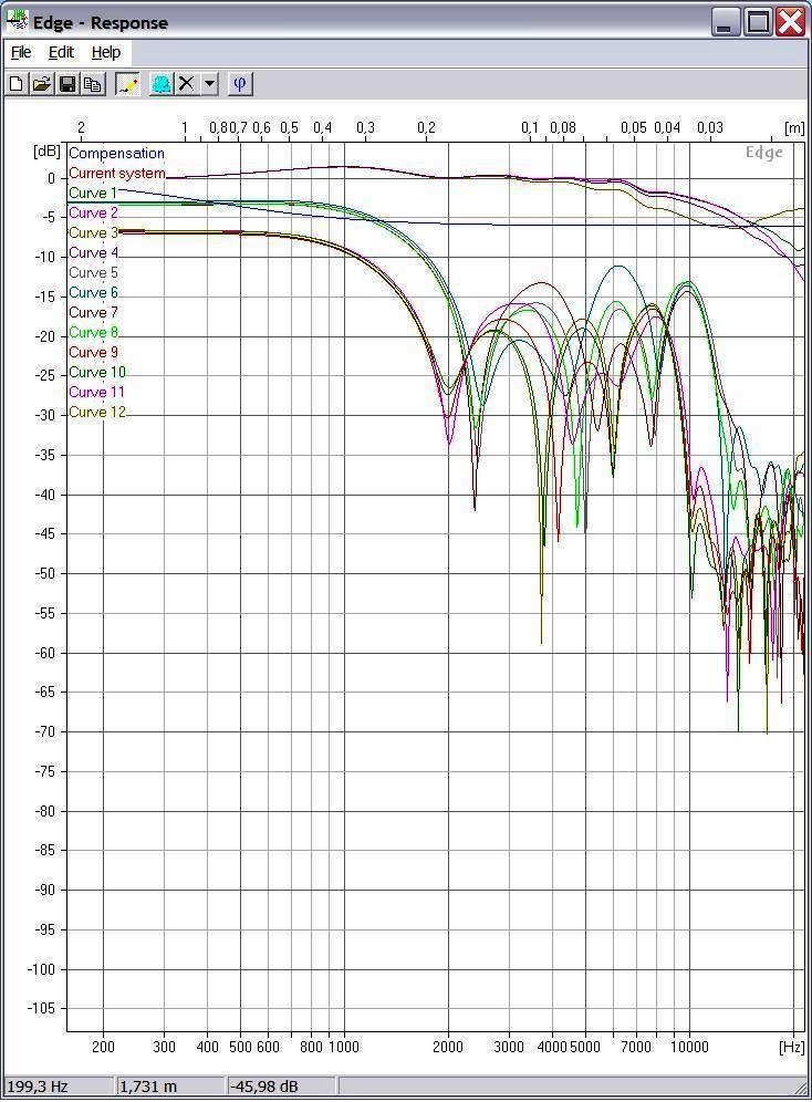

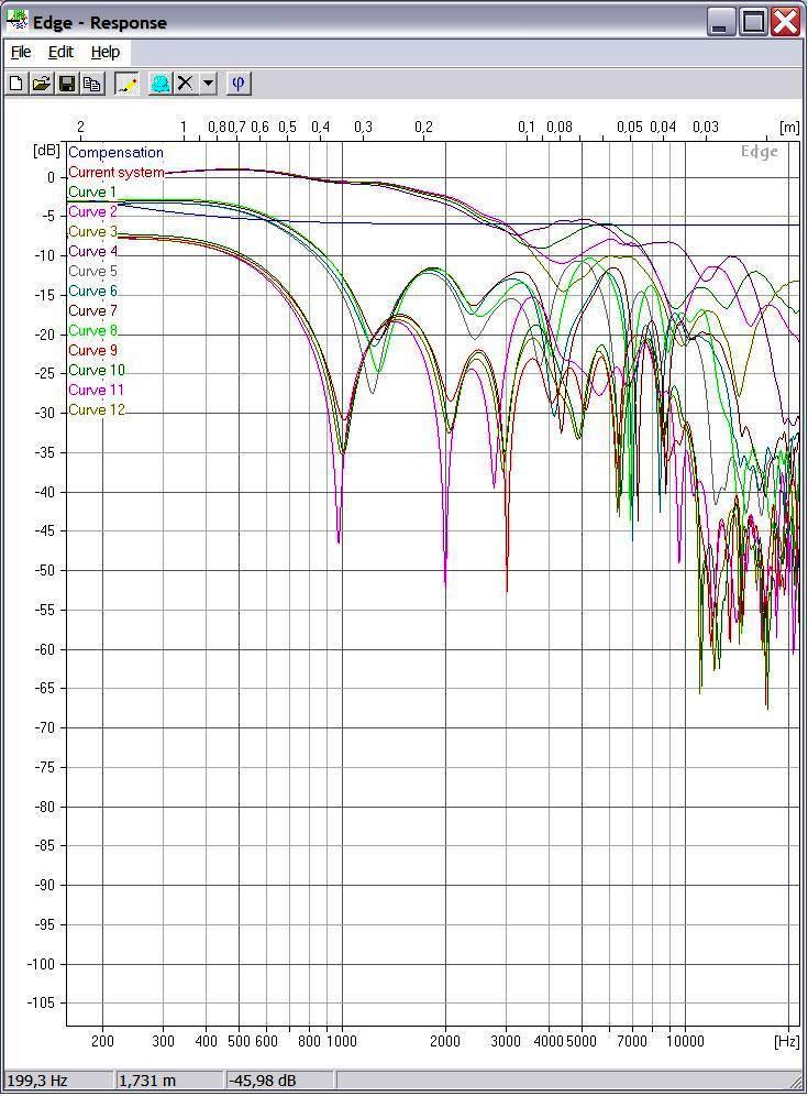

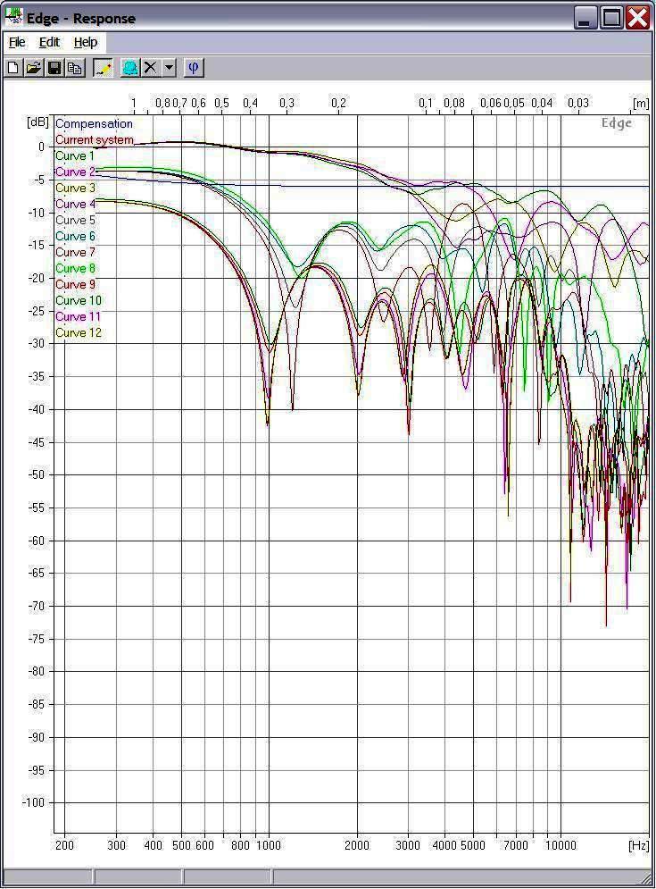

"Better performance in a usual living room". I'm also targeting there myself 😀
Maybe you would like one of these ... see pictures below.
Simulation is around 0 degrees, 45 degrees, 65 degrees.
There are always 4 curves picked at around +/- 8 degrees.
Differences in LF level because distance not constant.
This is just some "quick and dirty" prototyping of a new
idea i am thinking about:
"Mimicking dispersion properties of certain types
Bending Wave Loudpeakers
using conventional pistonic drivers."
______
But i see a problem with a speaker combing seriously at
small off axis angles: "On axis smoothness" in FR is
- also according to Toole - important for a speaker to be
accepted as "good sounding".
Maybe some kind of cascaded allpass filters would be
right for you to make some experiments in decorrelating
left and right channel at HF.
If it is beneficial (and there is "a right way to be done"),
it should be beneficial with nearly any loudspeaker ...
I personally doubt it, because non flat phase and serious
group delay may cause other problems ... but maybe there's
a "subliminal way" in making stereo more robust at HF.
Experiments using allpass filters should be quite cheap and
easy to do ... despite the problem of evaluation by listeners.
