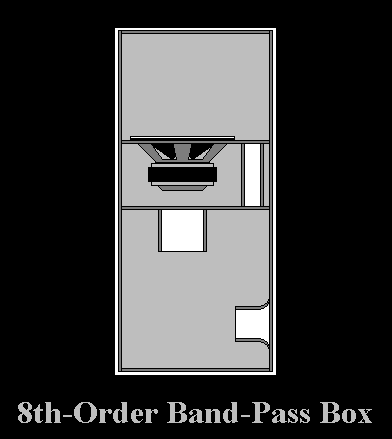

Just figured I would include a diagram of an eighth order bandpass in case anyone is familiar with the configuration, but not the name.
Also, I was in a thread where someone had simulated a tremendously low F3 for a bandpass box. There was a post by someone who seemed to be a professional who said that bandpass simulations, especially those of configurations with multiple ported chambers, do not conform to real life output.
I could not comment one way or another, having never built a bandpass. But I thought I would pass it on.
Is there any particular advantage of this enclosure style? Does the 8th Order bandpass give a lower F3 than other enclosures, such as the vented box?
I have heard that the more resonators, (ported chambers), involved, the greater the group delay, and possibly worse transient response. But again, I do not speak from experience on this.
Here is the configuration for anyone who has seen this enclosure.
Good luck with your project. Please let us know how it turned out.

Bam,
I'd have to say I'm not in general a fan of bandpass subwoofers, although it does depend on your application. I'd say they are suitable for non critical applications, where you are willing to sacrifice some quality to get more output - say in a PA setup, or for some boom boxes with small drivers that otherwise wouldn't really be up for the task - especially computer speakers if you want to add a little boom to your computer games. A 4th order bandpass, OTOH, is perhaps more feasible as it doesn't compromise sound quality as much. Jamo once had such a sub, with a 10" driver in their flagship speaker - actually they had two of them in isobarik configuration inside a curved speaker.
It really depends on what you want it for. I believe bandpass boxes are very sensitive to the parameters of the driver, so it may prove hit and miss unless you actually measure the parameters to be sure they are what they are supposed to be.
Subwoofer simulator is a good one to use. However, be aware that if the parameters of your driver are a little different to the published specs, it could mess up your design.
Ok, so why use a bandpass? ...
Basically it allows you to trade efficiency and bandwidth. They gain output by narrowing the bandwidth. So, compared to a vented box, a 6th order bandpass will have a higher F3 and higher efficiency. They also tend to have higher power handling due to the increased excursion control. This is particularly useful in PA, where low extension is not really useful, and high output is desired. If you design a bandpass to have a lower F3 than a vented box, you start to loose efficiency. If you want a lower F3, this is probably not the way to go. If you want a lower F3 than you can achieve with a vented box, your options include:

Bose used an 8th order bandpass with small midbass drivers in their older acoustimass modules. They go low enough for most music and roll off rapidly on the upper end, so that they are more flexible placement wise - distortion is less audible as it has to get out through the ports, and the rolloff helps also to prevent being able to localise the sub. If you aren't fussy about sound quality, it's quite clever, and will easily satisfy most people. But it will satisfy very few who are likely to be found browsing this forum!

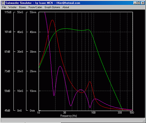

Well, I just modeled one of those Peerless 833599s. Subwoofer Simulator will not model two.
The power delivered to the woofer is 96 watts.
The sensitivity seems to go down, but the bandwidth seems to go down very far for a speaker with an Fs of 37. Speaker normal sensitivity is 88dB.
Group delay is a very large 45 ms.
Green line=output without room gain
Red line=group delay
Purple line=cone excursion

Here are the box dimensions and tunings.
I would certainly make the Av of the vent larger than 1 inch, but I did not have time to calibrate a bigger vent for the same tuning.
But I think everyone gets the idea.
The box seems to have the potential to give smooth tuning for frequencies well below the speaker's resonances-in fact, about a whole octave below.

One question about the readings you got with Isaac's subwoofer simulator. Does that mean that my 6.5" woofers in this box will actually be able to reach down below their Fs to the 20Hz F3 that it is predicting? I might model up one for myself and change it to see that the lowest frequency it tries to do is 35Hz and extend its possible range up to 200Hz.
Well, the 1 Watt curve will be -3 dB down at 19 Hz or so. BUT at 19 Hz, the cone excursion for your 6.5" is 23mm!
Actually, TC Sounds makes a 6.5" that will be linear at 23 mm. Only trouble is, they mostly sell Original Equipment Manufacturers, so you have to locate which manufacturer uses it. I hear Styke sells ome of TC Sounds speakers, so you might look there as well.
Assuming a normal excursion of ±6mm or so, plus a little added for nonlinear travel, you still fall far short. Even if you double it for 2 woofers.
If you don't mind my saying so, I don't think being able to put out 101 dB at 19 Hz is such a great idea. You will need more SPL than that to make going down that low worthwhile, even with room gain. I would definitely move the F3 upward for greater sensitivity, greater output and less cone excursion.

B) Your dimensions for this box, (36" X 20" X 12"), with one inch building material, translate into 3.5 Ft³. That is one large enclosure. Are you sure you want to go thru all this trouble with the eighth order bandpass sub?
A vented Shiva or even a sealed one-should give you all you need down to 35 Hz. You can parallel two vented Peerless 10" CSX or CCC and get down to 35 Hz, with an efficiency of 91 dB and major excursion output.
It is your project and if you want it in the form of two 6.5's in an 8th Order Bandpass, that is great. Just thought I would let you know that there are a lot of less complicated alternatives out there.
I know there are a lot less complicated ways of getting bass, and probably better bass at that. But I have never seen a DIY-built 8th-order bandpass subwoofer, and I want there to be at least one existing DIY 8-O bandpass design. Just like there is an existing design that uses Wave Cannon theory, I want to build at least one 8th-order bandpass. That is my whole motivation for this project. Otherwise I would have just built some sort of sealed 10" woofer. My whole aim in this, though, is to make sure that my 150-watt plate amplifier dies not sit idle.

I built an 8th-order box, long before I knew enough for SubSim's conception. It used a cheap chinese-made 8" woofer. This was in the early 90s, so I can't remember the tuning frequencies, and surely the driver unit wasn't a match for the enclosure.
This type of enclosure does require a capable woofer. The one I made had a glass panel so I could see the cone excurssion. The cone movement is so small that the voice-coil vent is almost useless. The driver easily runs into thermal overload rather than mechanical overload.
A 30Hz signal at 100Wrms was just too much that it fried the coils within seconds. I could smell and see the smoke vibrating in and out of the main vent. It was loud while it lasted, kinda cool actually 😀
