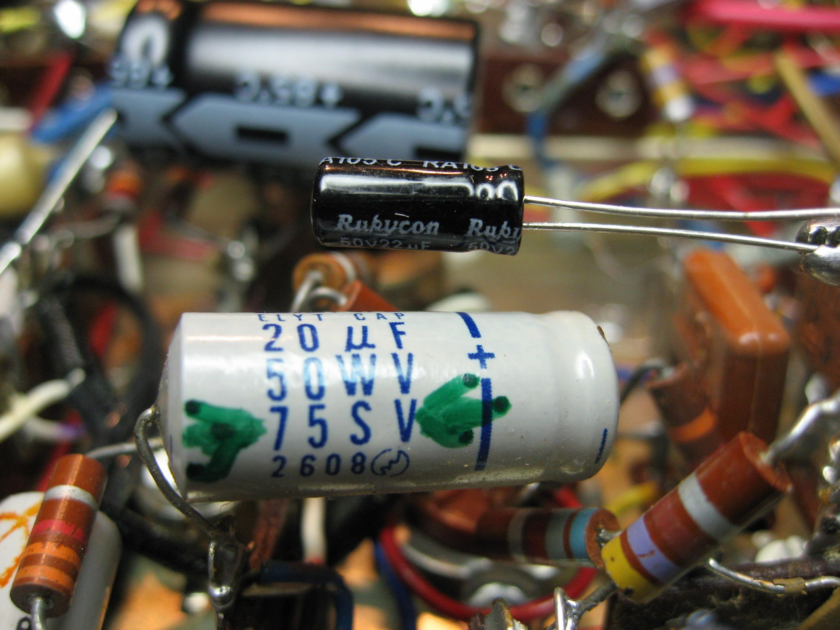

Uncomfortably big difference in physical size of these two capacitors
I am in the process of replacing electrolytic capacitors in a 1960's Japanese tube receiver (AGS-Trio KW55) and have a bit of a quandary. I purchased replacement electrolytics from a list prepared by recording the values of the original ones while still in circuit. And then I went shopping.
Up to now, a quantity of replacements have been done with more or less satisfactory results meaning the amplifier section of the receiver works better than it did but I halted when I got to these two.

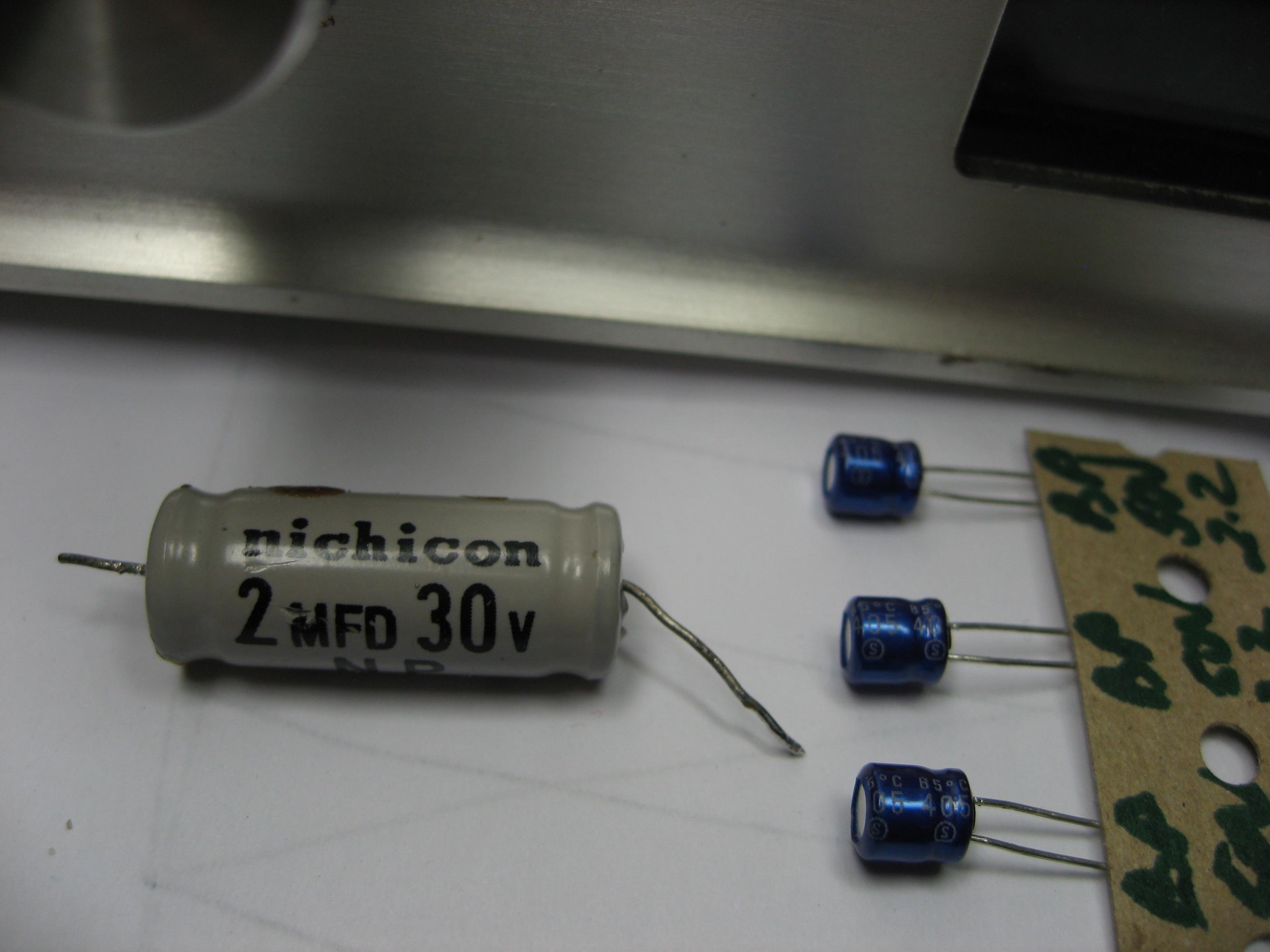

One is a bi-polar 50V 2uF cap and the other a 50V 20uF polarized.
The new ones I bought are 50V 2.2uF and 50V 22uF respectively.
But the replacements are a lot smaller physically that those I wish to replace.
I understand it is quite normal and expected for modern caps to be smaller than similar value ones from 50 or so years ago but the disparity here makes me uncomfortable.
Something that enforced my concern was what was printed on the original 2uF bi-polar cap. It is labeled 50WV-working volts and 75SV- surge volts.
My replacements are branded Elna and labeled @ 50V but the data sheet I looked over did not state what the maximum allowable voltage was that they could be subjected to for a brief time. Either that or I could not understand what I was reading.
My hope is that someone can either tell me to put the brakes on and find something else or validate that what I have will be appropriate.

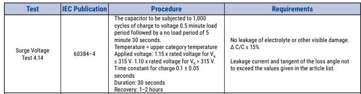

I've attached a copy of the IEC testing paragraph relating to surge voltage.
Basically it is 1.15x the rated voltage.
I would personally work on the rated voltage being the upper limit of voltage that I expect a capacitor to endure, unless the datasheet specifically states otherwise.
Your example capacitor has an SV of 75v so I'd choose a value above the 75v.
I'd use something like this one which is 20uF 100v: Mouser Electronics, Inc. Australia
Or something like this 22uF 80v which is cheaper: 870056175003 Wurth Electronics | Mouser Australia

Yes, you and the previous respondent agree on this and it does makes sense. To a degree I am fortunate in having an electronics parts store somewhat nearby. I makes the cash outlay for parts much less than online ordering. No shipping charge and no Canadian to US currency exchange.
I do see 22uF electrolytics on their website of perhaps 400V and is not overly expensive. I'll pick one up - hopefully there will be enough room (without the original in place) for it to fit in.
Being bi-polar's are less common, I may just use those small ones I have and see what happens.
New tech caps are 1/4 size of old tech caps.

In the case of a 2 uf bipolar cap, a mylar cap would probably fit, and polyprophylene might sound a little better. Lower voltages are smaller but a little hard to find. 63 v is pretty commonly stocked. New value will be 2.2 uf. If the 10% mismatch is critical you can parallel a 1.5 uf cap and a 0.47 uf cap.

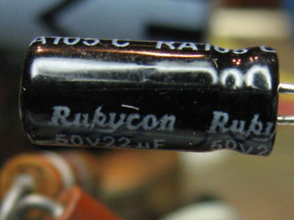

I think its actually 'Rukycon', one of the Chinese brands I'd not touch with a 6ft long pole...
Hard to believe, but it's true. Dirt cheap, though. And what a warranty.
China Rukycon Aluminum Electrolytic Capacitors 100V470uF 16*27 mm, Router, switching Power supply, fan on Global Sources
"If the item you purchase from factory beacuse of quality problems, you can return them to us
for replacement or refund. And any items returned must be in their original condition to qualify
for a refund or replacement."

The 'Rukycon' cap will probably work fine so long as its not taken too close to its working voltage. The problems I've had with dodgy Chinese cap brands has been mostly in terms of the stated working voltage not being honoured in practice, together with tolerances being way too generous (in the negative direction always).
My habit has generally been to go at least one voltage step higher with replacement over original caps so I'm reasonably confident of being above borderline. The odd time out of necessity, I've stayed at original voltage (never less) if there's nothing higher that has the required value.
