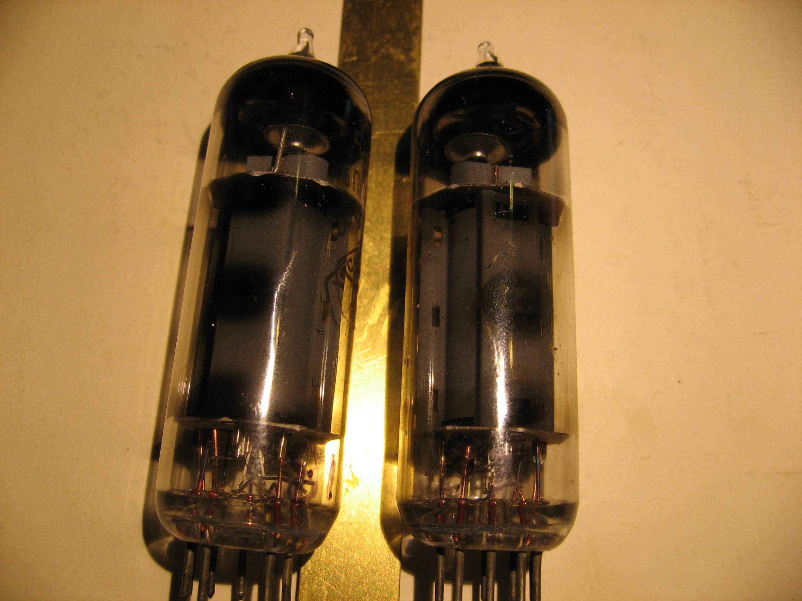

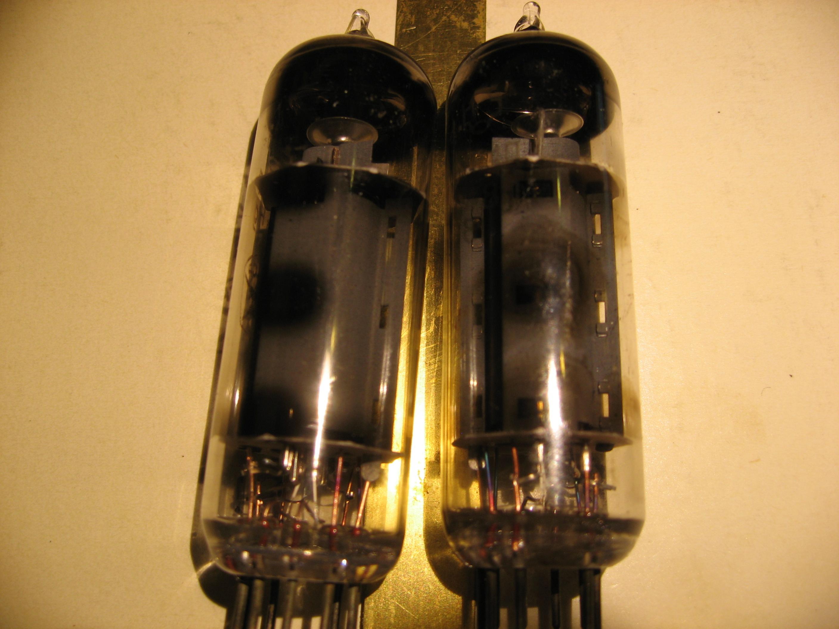

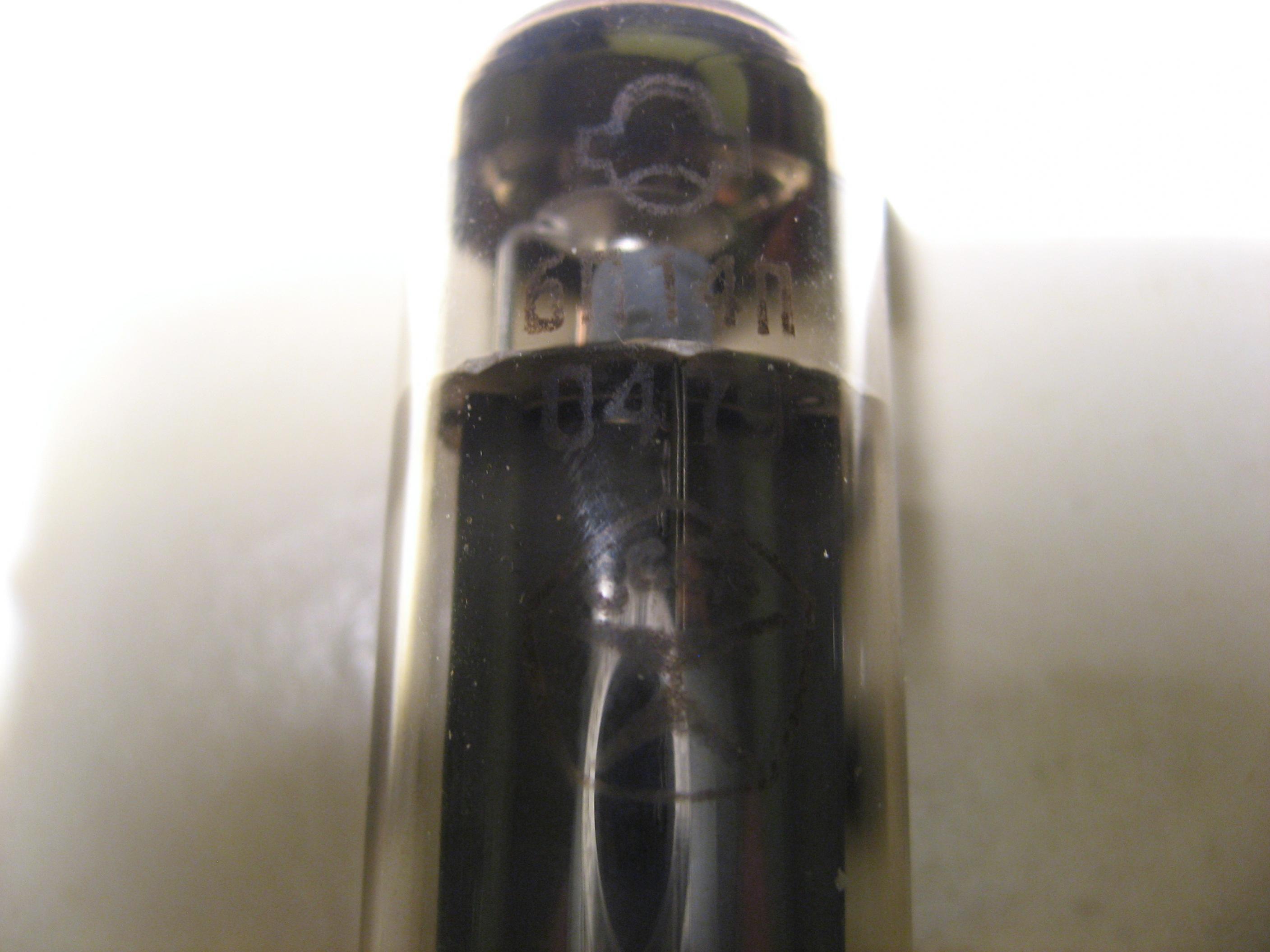

The 6BQ5's might be NOS. They're Russian and by the looks of the boxes, intended for that domestic market who knows when - the staples are rusty.
The Russian 6Π14Π (6p14p) is a quite mediocre 6BQ5/EL84 equivalent. OTOH, the 6Π14Π-EB (6p14p-ev), AKA EL84M, is a nice 7189 equivalent that is tougher than old rubber boots. Check the markings on the tubes in your possession.
Re-examination of the schematic shows "Cheap Charlie" DC heaters as part of a single bias network that all 4 "finals" share. You need a closely matched quad of O/P tubes. A random set of 4 tubes could be part (all?) of the red plating problem. IMO, it will be well worth your while to acquire a properly matched set of the 7189 equivalents from a reputable dealer, like Jim McShane.
Interesting. All four of the boxes those tubes came in have the "EB" suffix but the tubes themselves don't. And just now having examined them, two of the tubes are labeled with red script and the other two with grey.

I'm reasonable sure the tube glass was clear when I first got them which in my mind, made me understand the vendor's remark that they might possibly be NOS. At present, two of them, the ones with grey script, have silver/black "scorch marks" on opposite sides. I do not believe this is indicative of a healthy tube.
