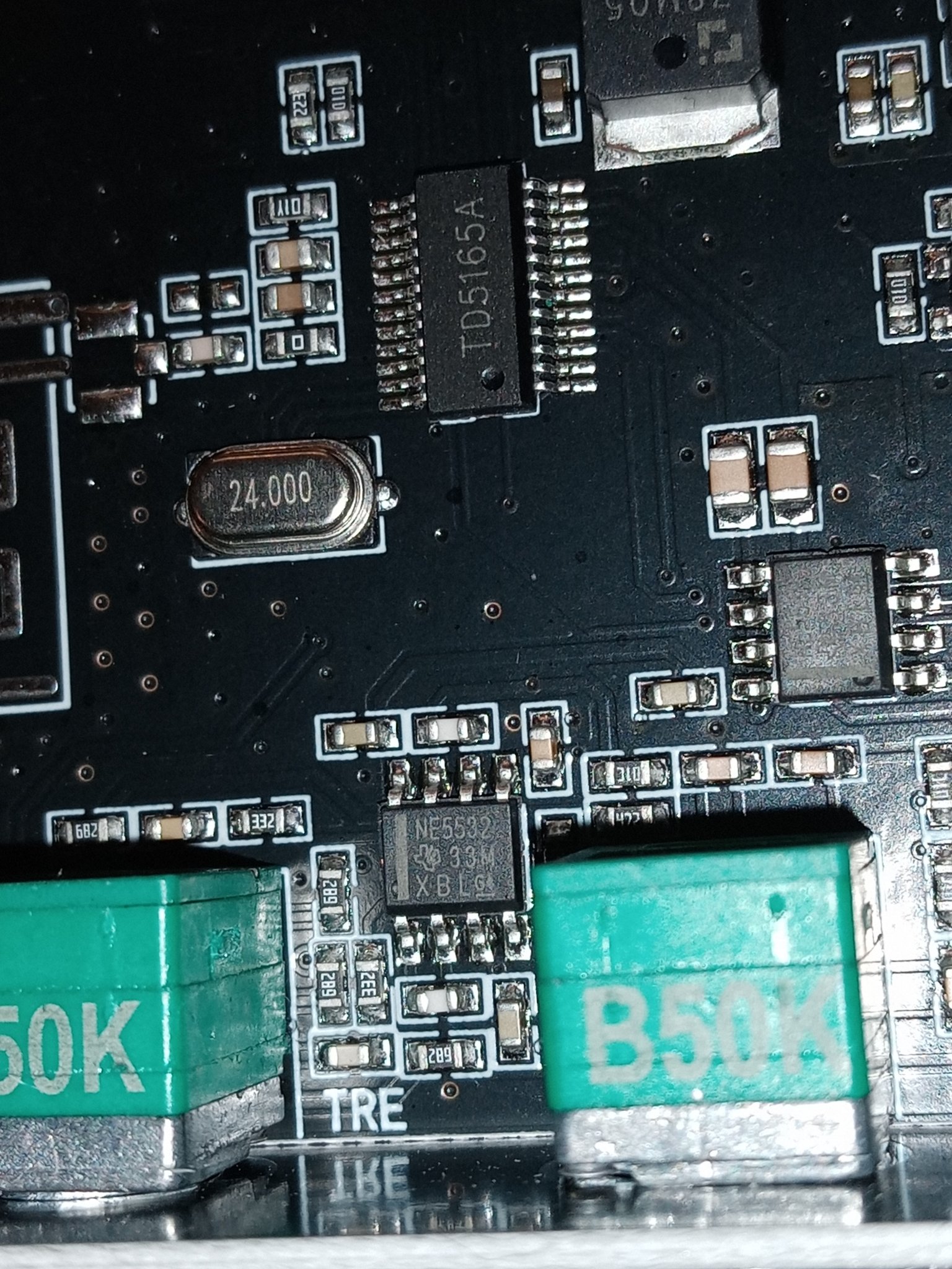

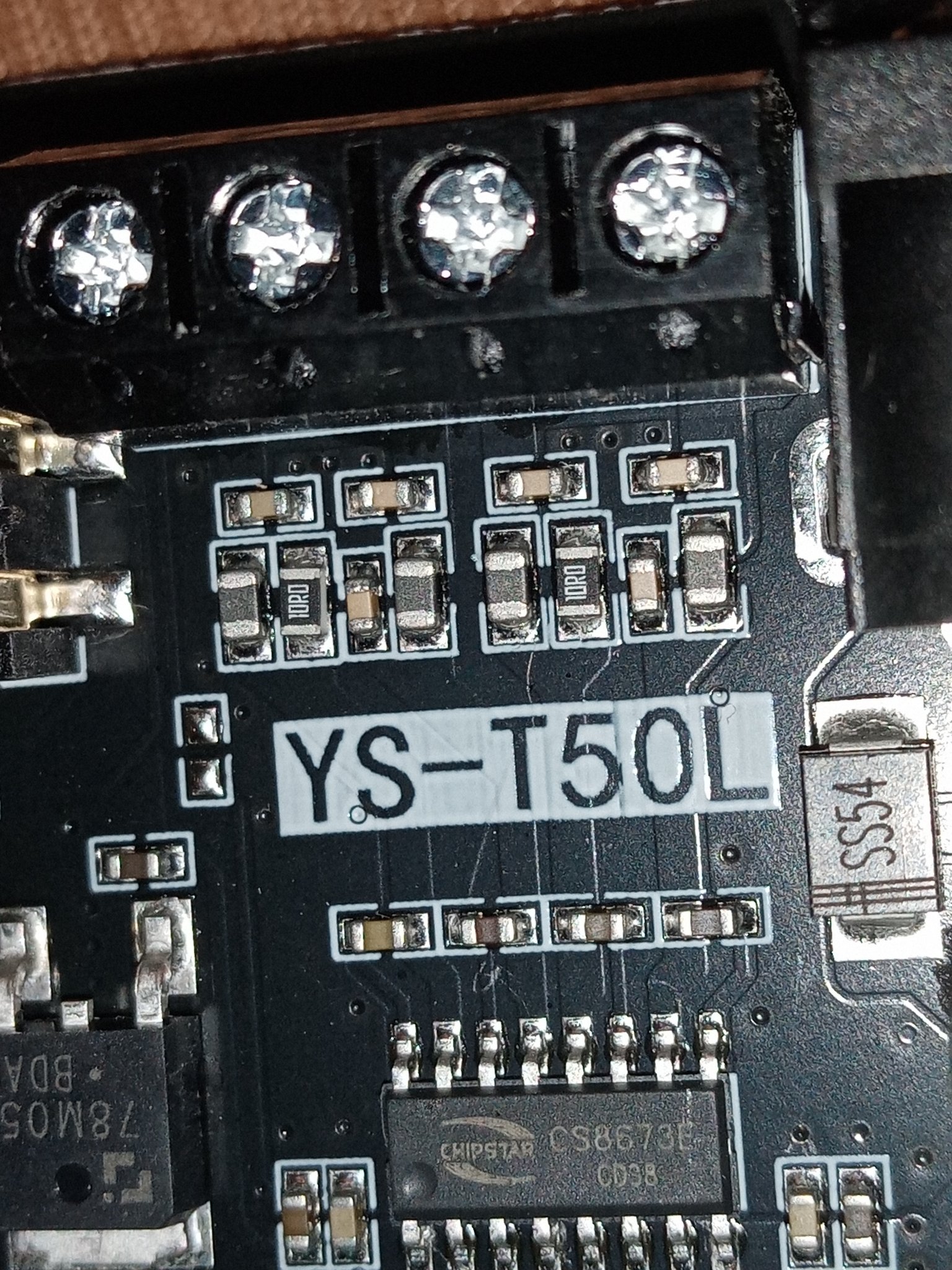

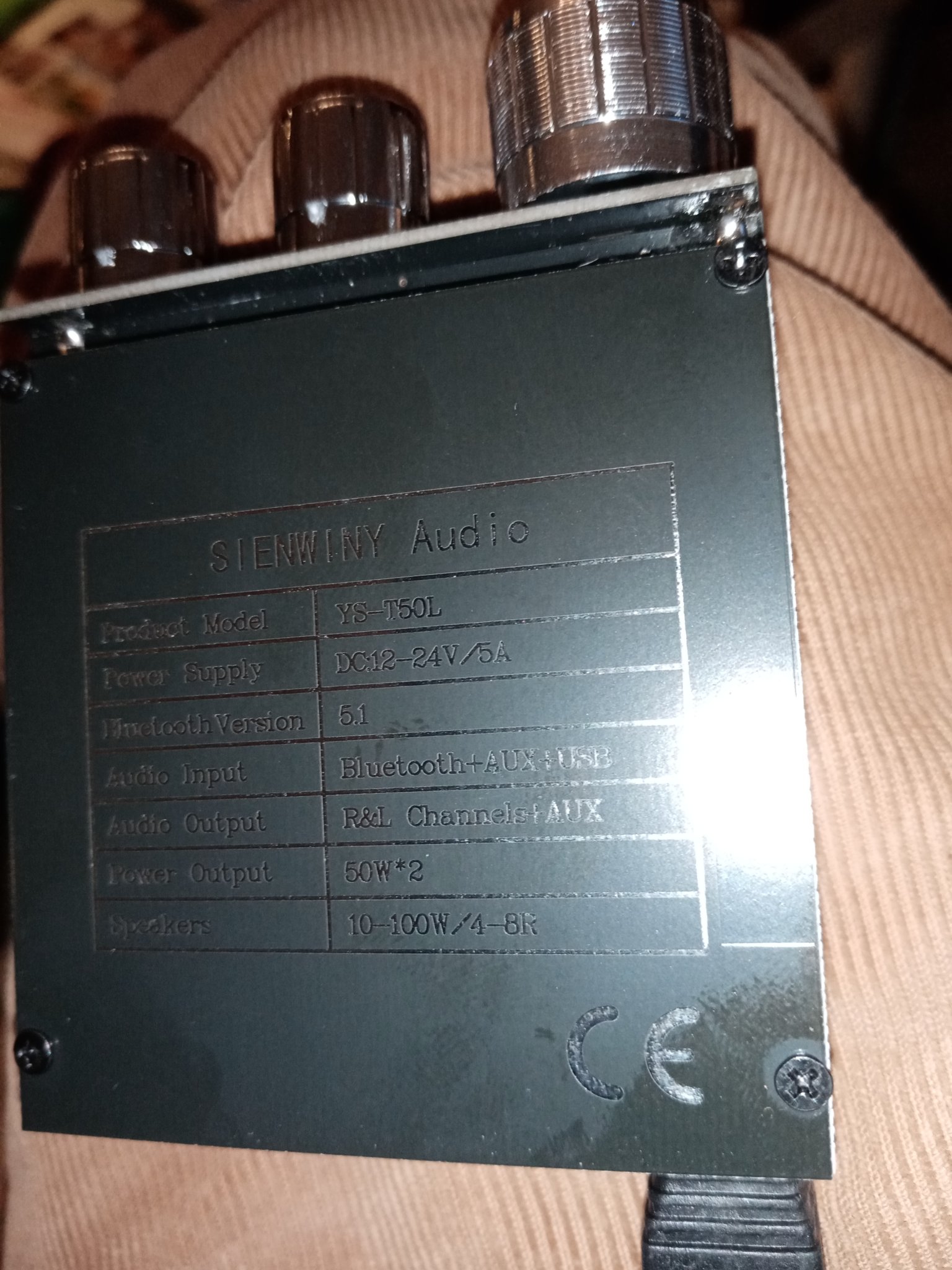

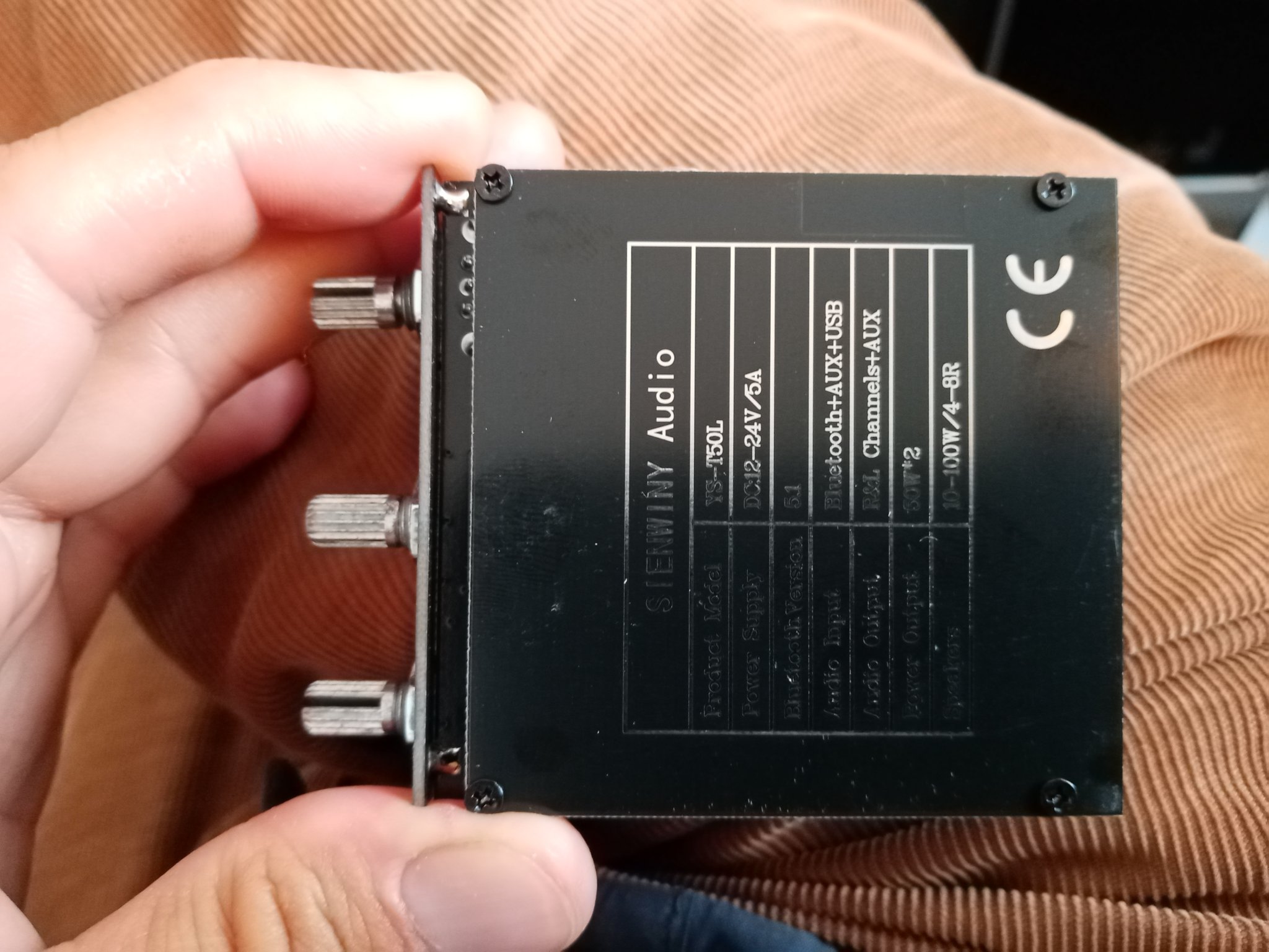

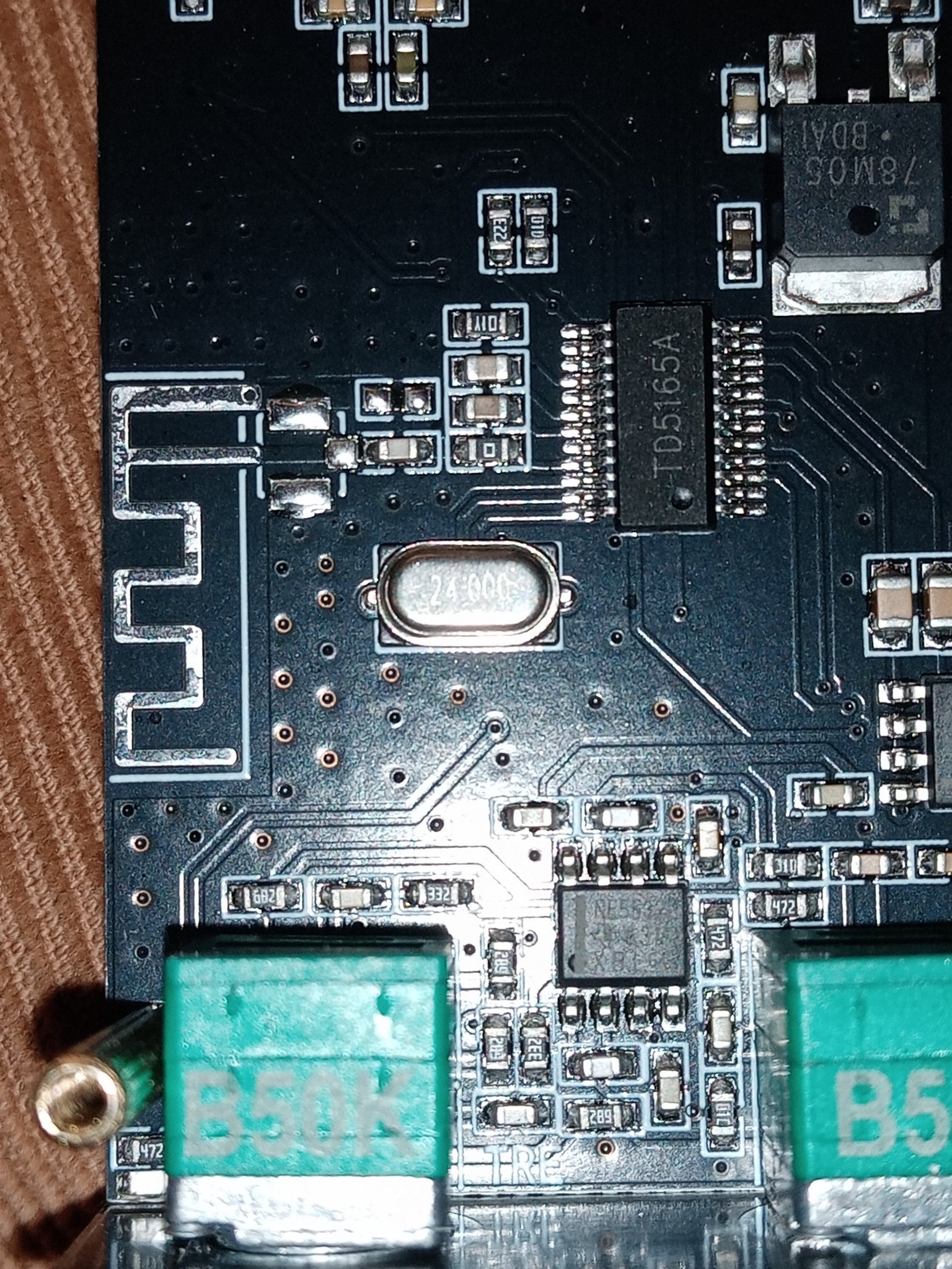

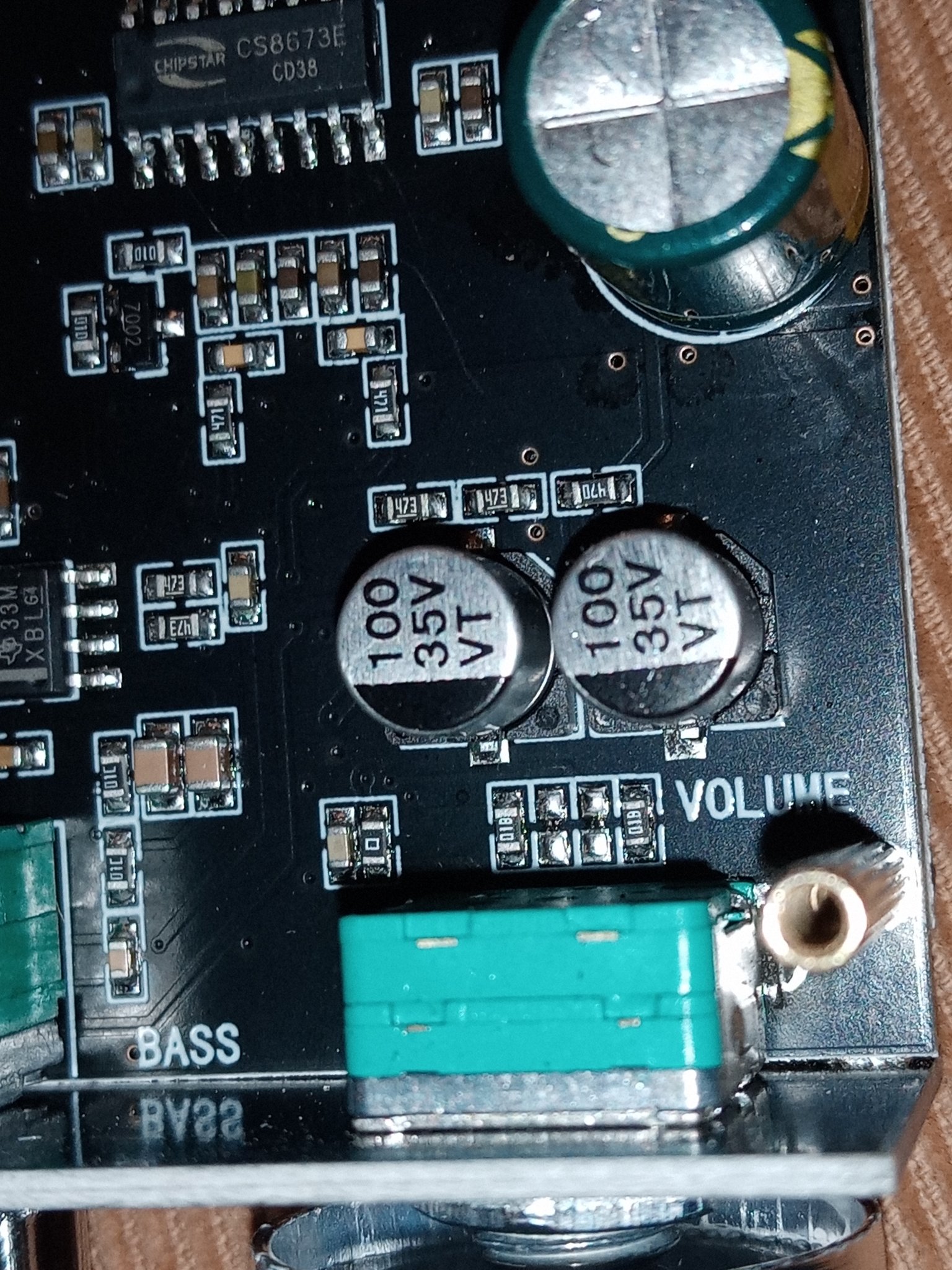

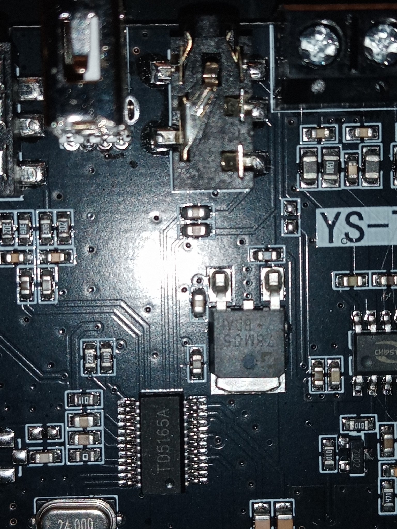

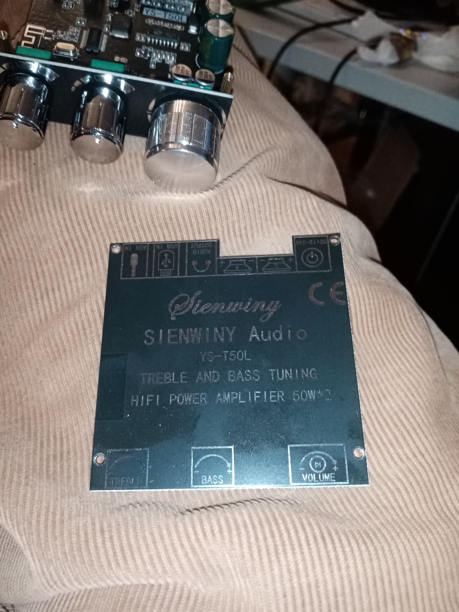

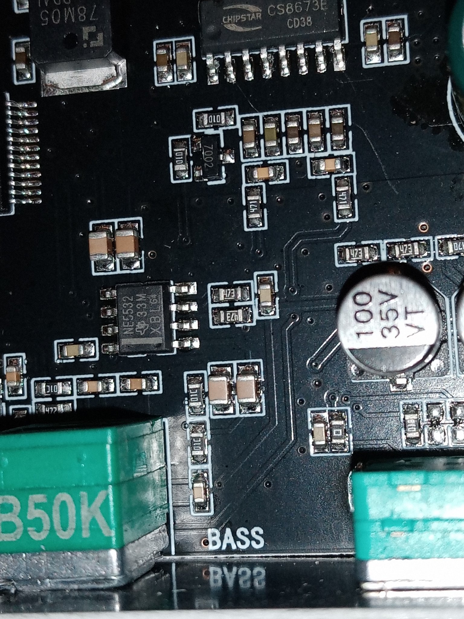

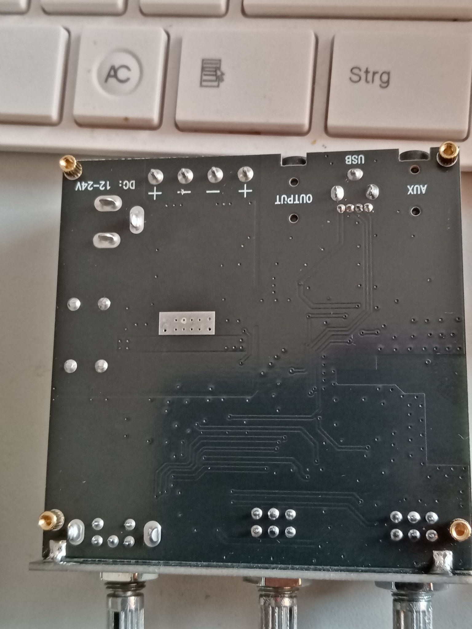

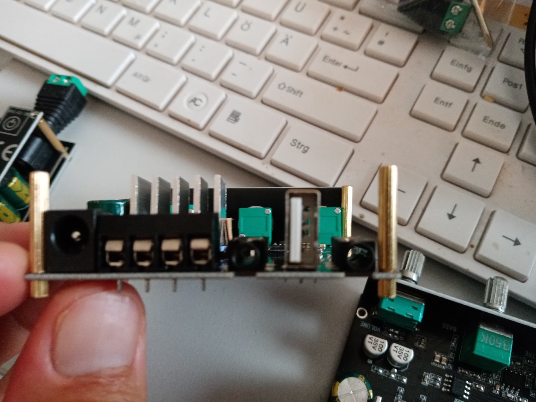

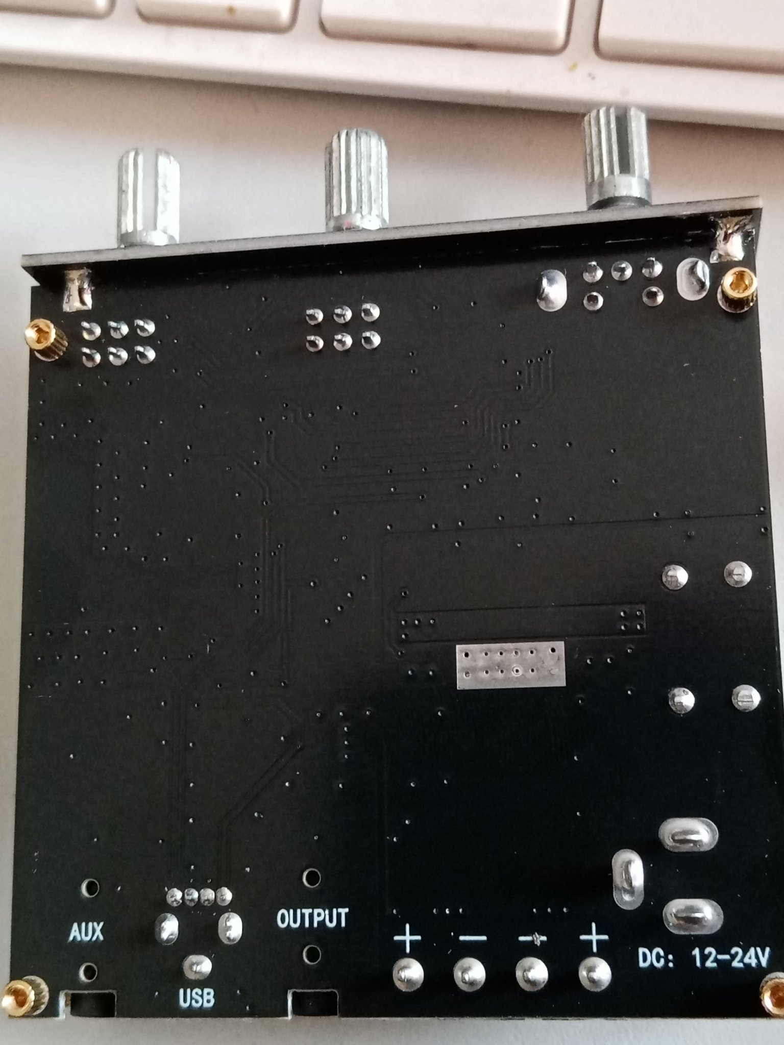

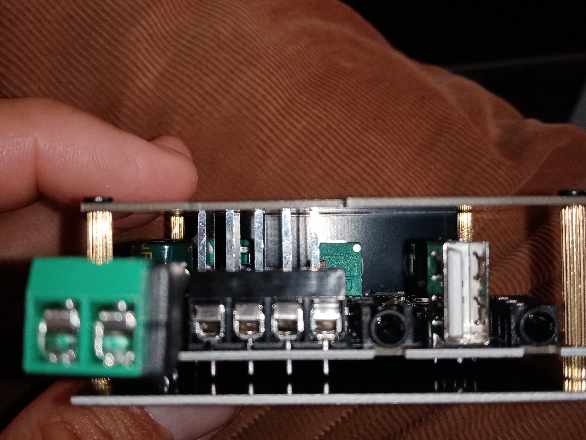

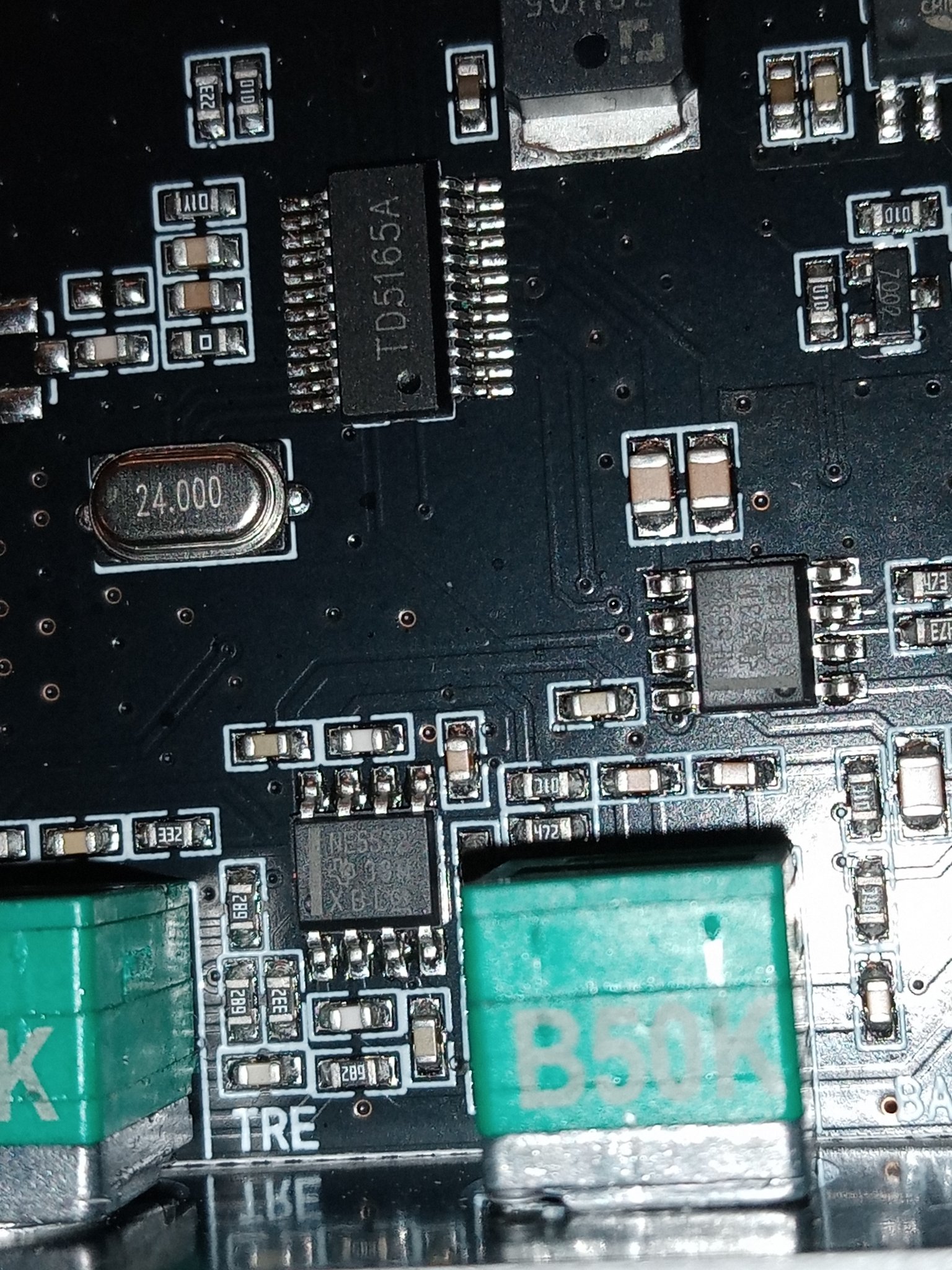

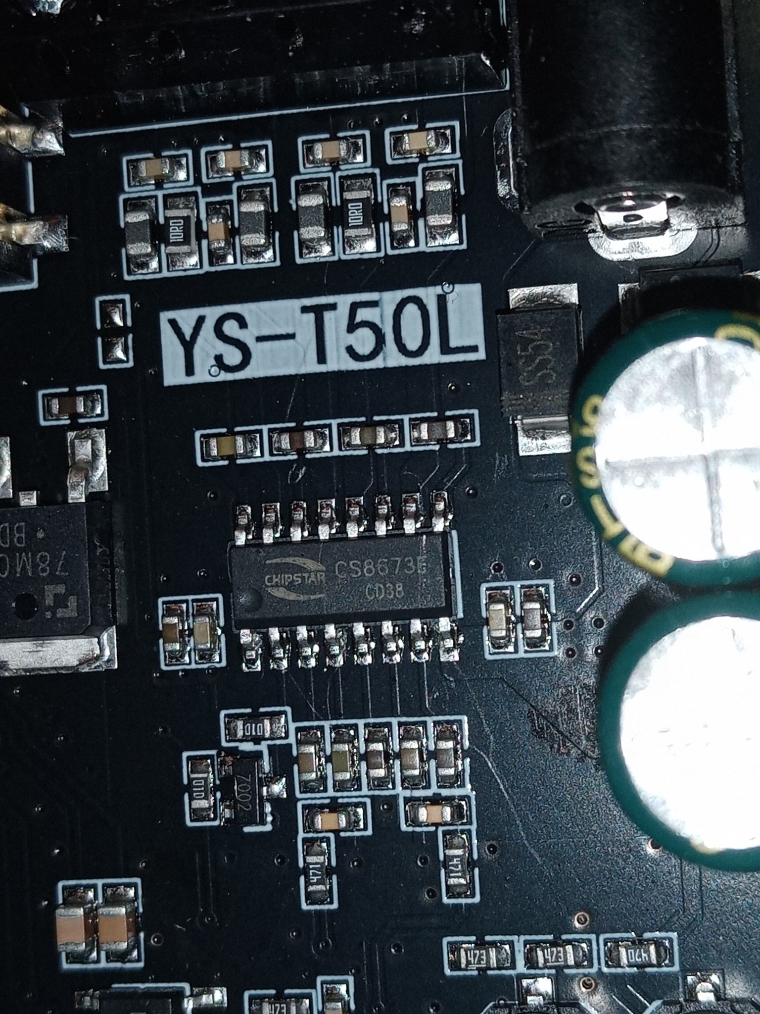

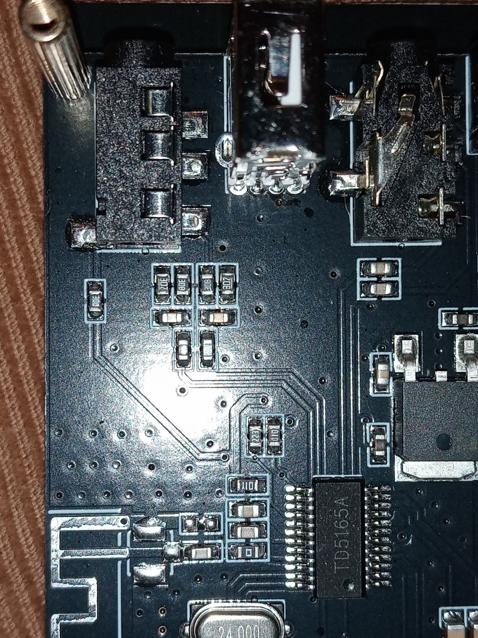

Unboxing / unpacking Sienwiny YS-T50L mini Bluetooth amplifier with close up Fotos of the board.

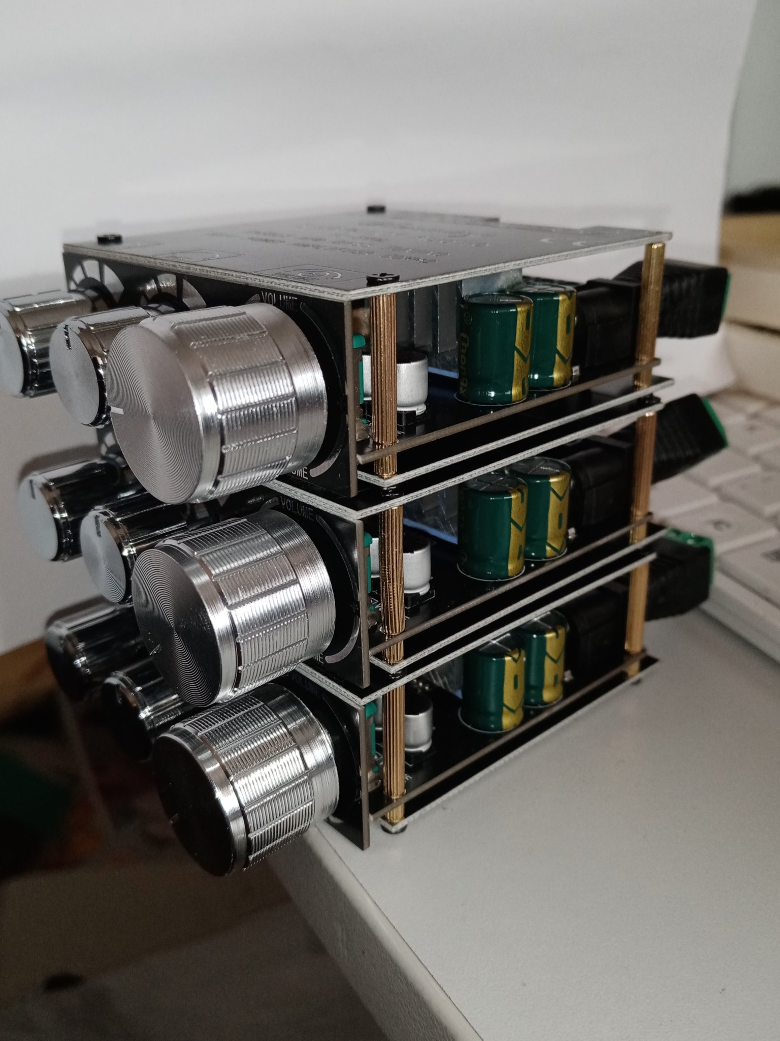

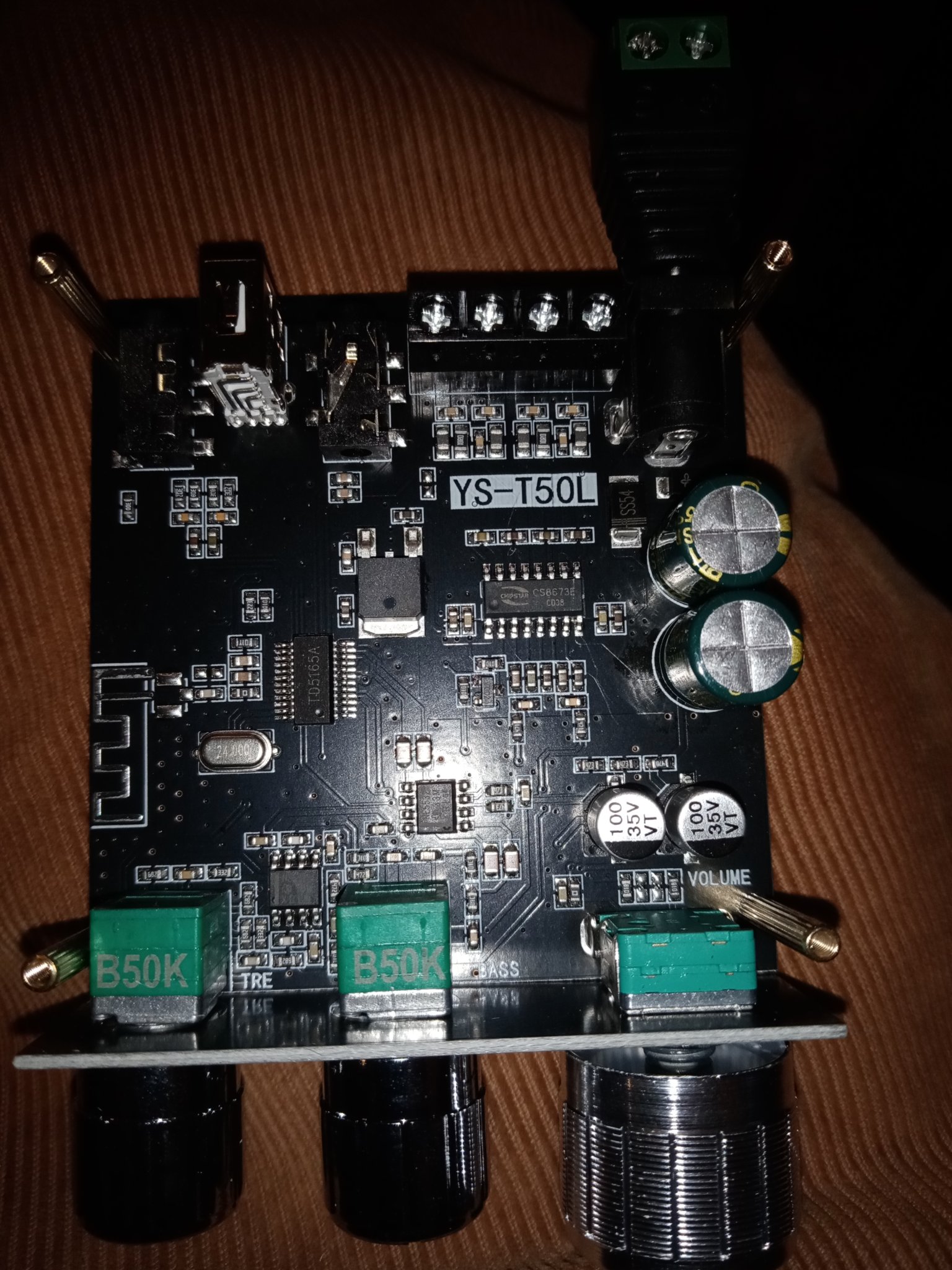

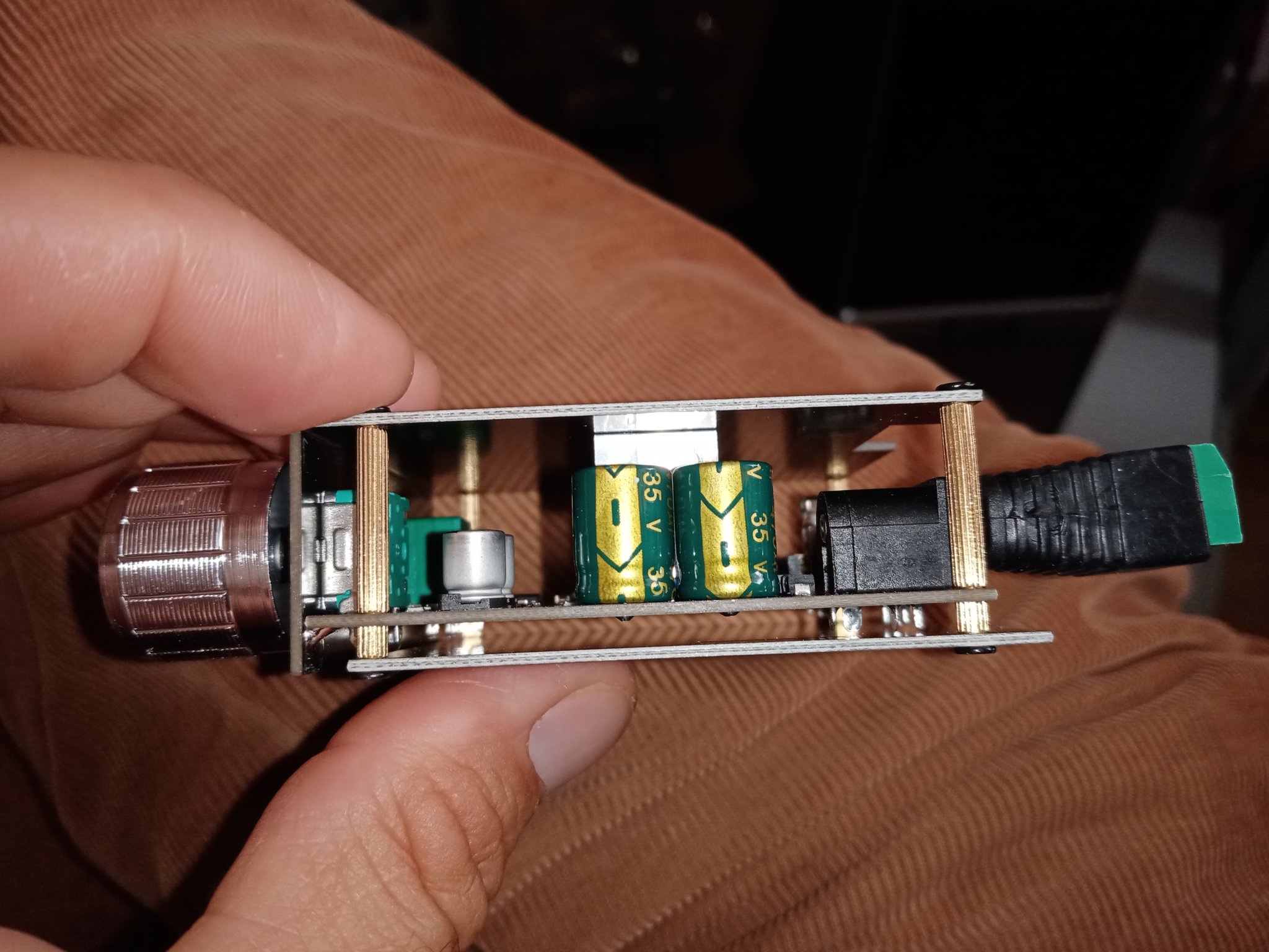

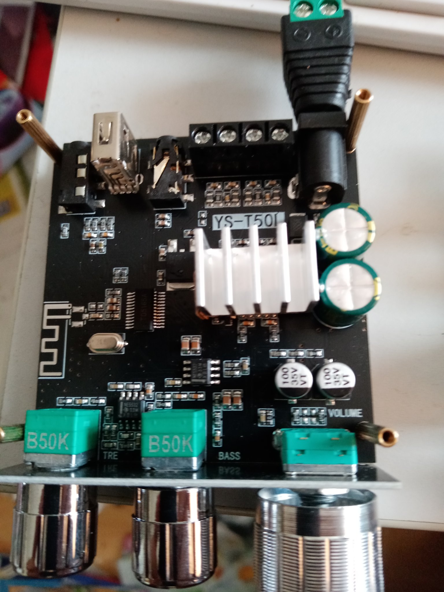

It has, different than ZK MT502 a volume rotary knob which only gives impulses and amp is turned on by pushing volume knob

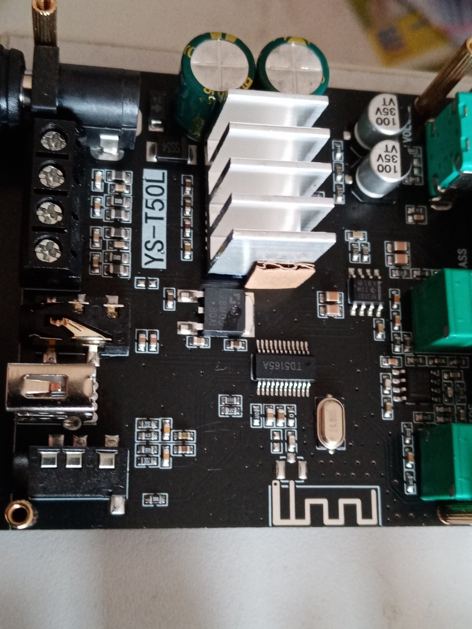

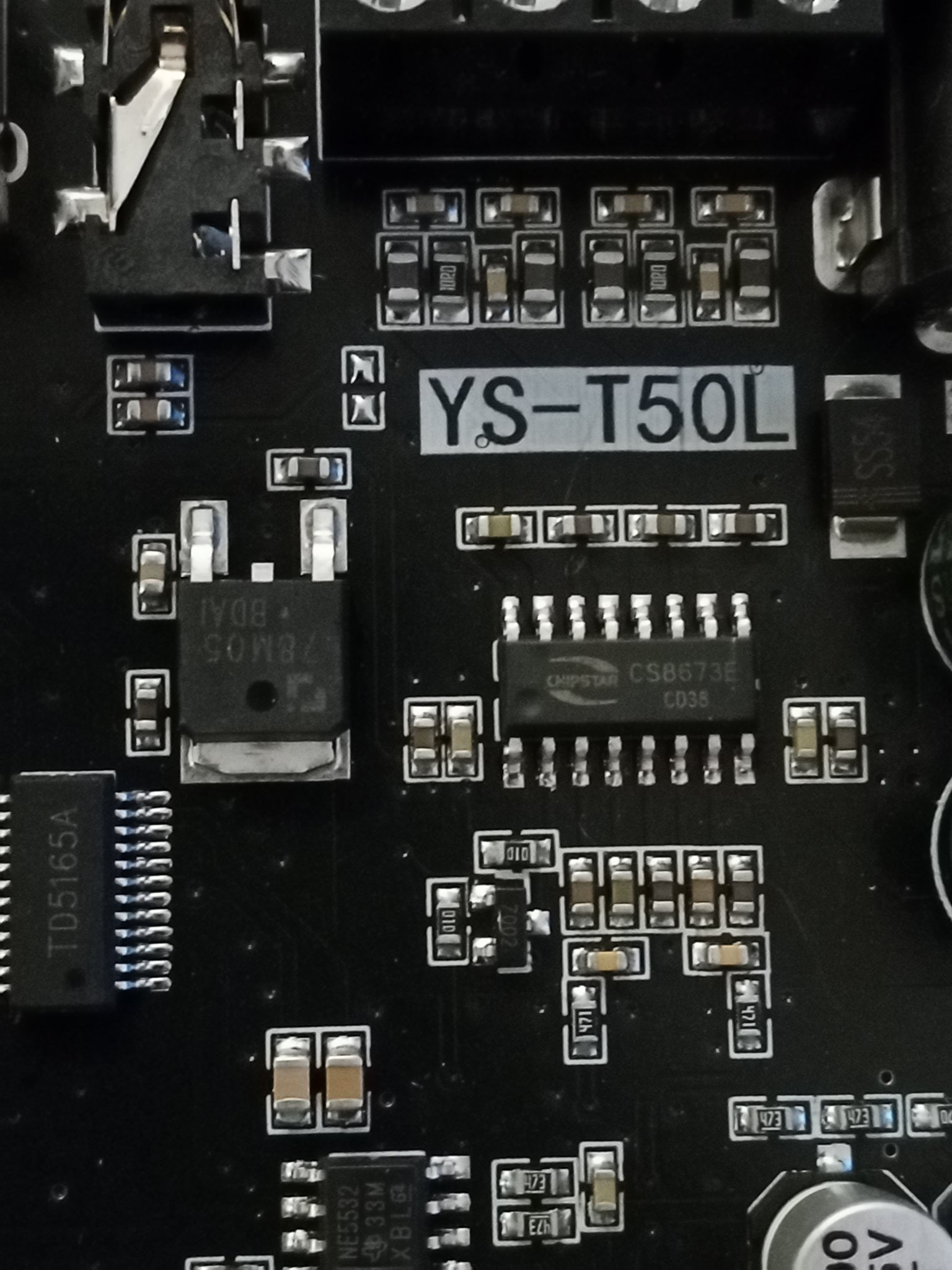

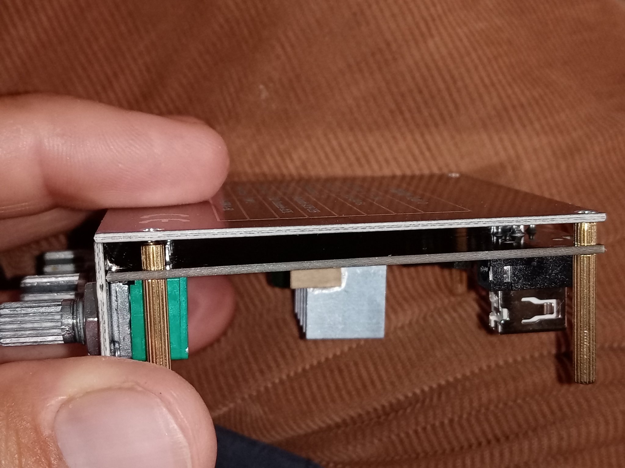

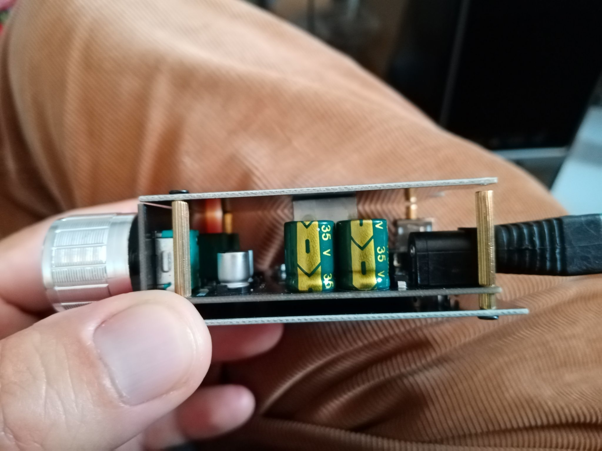

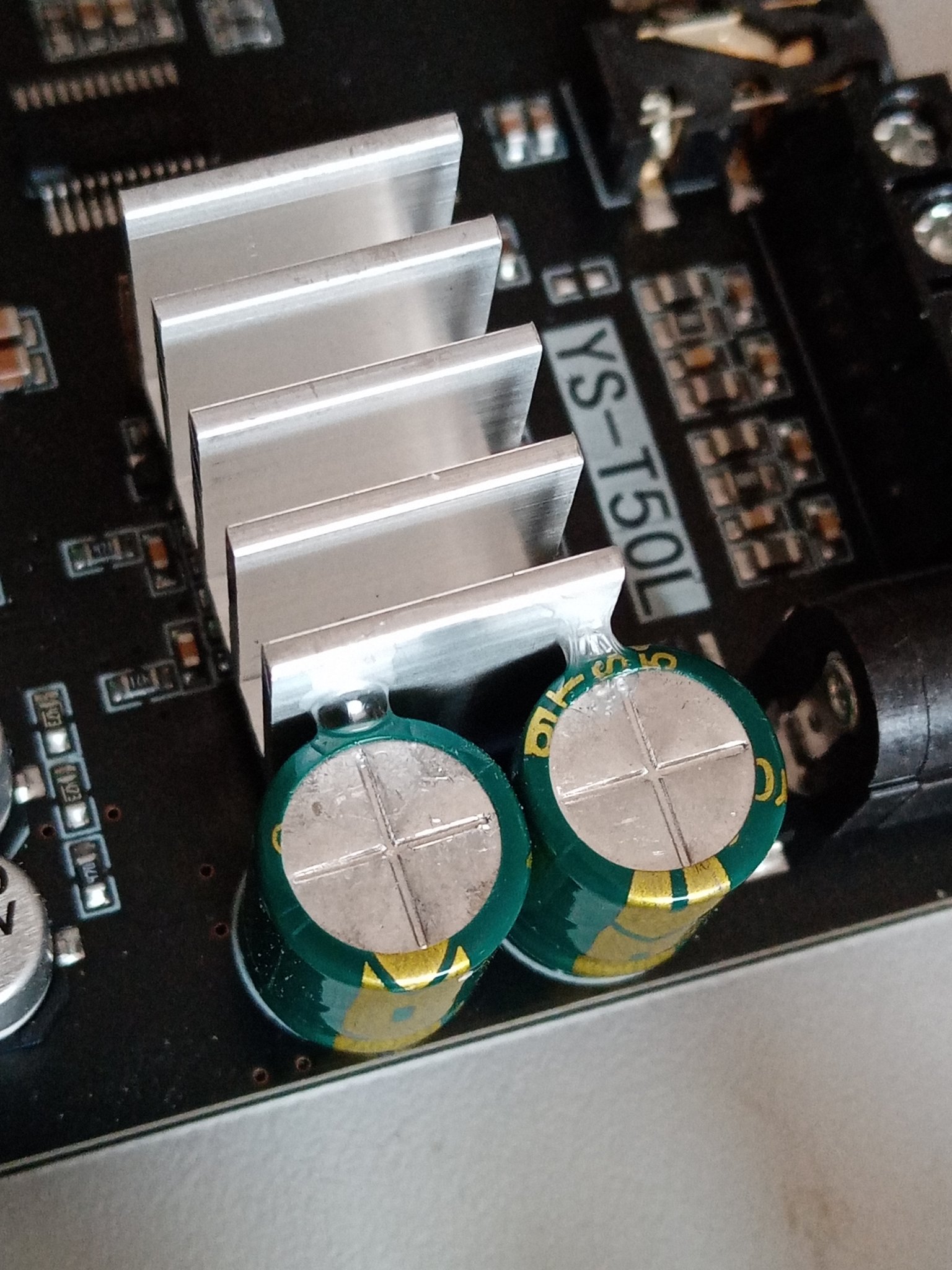

The cooling for the chipstar cs8673 is managed with a heat conducting self adhesive pad.
I fixed it with glue and a piece of cardboard so that it does not fall off.
As the self adhesive pad is thick and soft it looks like that extra glueing of the aluminium should be skipped and the upper metal sheet can be fixed with four screws pressing/fixing the cooling aluminium simply by assembling.
