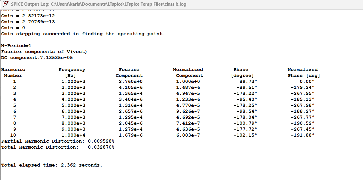

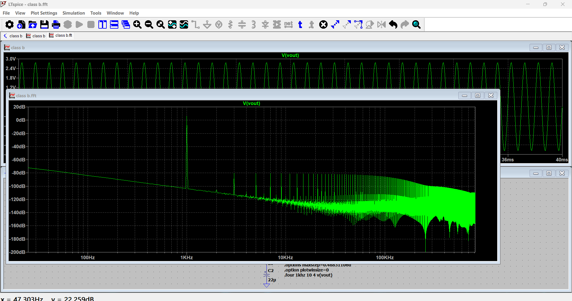

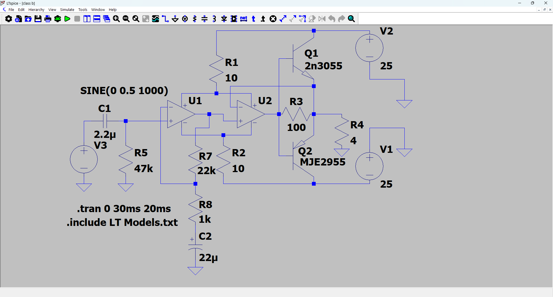

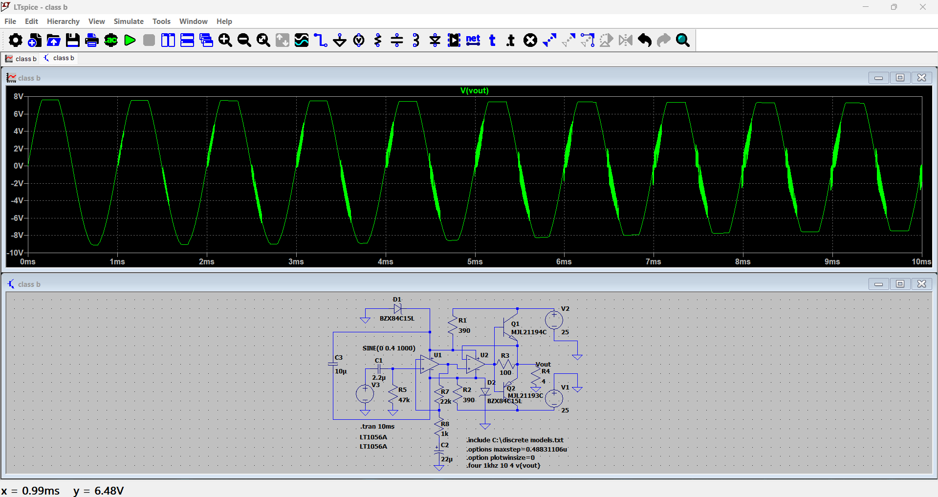

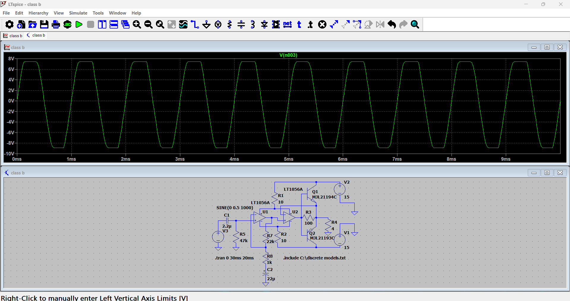

These are the base currents (right and scale) but the design is proving to have stability issues when the opamp is run at lower supply voltages. I suspect its 50:50 design and simulation artefacts tbh. This is the max voltage swing it can deliver into 4 ohm before the opamp limits..
