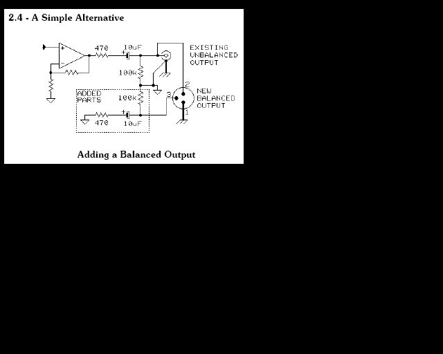

In my case I want to use a Threshold FET ten/hl to drive a Crown D-75A. The Threshold has RCA phono outputs and the Crown has XLR/phone inputs. I do not really want to use a transformer, or I should say I really do not want to use a transformer.
I intend to use a short RCA to XLR adapter cable. The question is how best to wire it. On the Crown XLR connector pin-1 is shield, pin-2 is signal plus, and pin-3 is signal minus. My inclination was to use two conductor shielded cable with the RCA pin connected to XLR pin-2, RCA frame connected to XLR pin-3, and cable shield connected to XLR pin-1 but unconnected at the RCA end.
However in the D-75A manual Crown shows to connect pins 1 and 3 together at the XLR connector. This seems wrong to me, or at least not as right as it could be. I wrote to Crown asking for clarification but had no response today.

Are there any other ground connections between the two apparatus? If not, I would connect the shield on both sides.

Connected together at the RCA side so ground currents flow through the shield, not the signal - wire.
Yes, that is what I meant.
Convert your source to pseudo balanced output impedance.
From Jensen AN003
I saw that Jensen app note but I hesitate to modify a vintage piece of Nelson Pass equipment. Likely the only one I'll ever have.
Besides, I've never yet figured out how to non-destructively remove the cover.
This is what Jensen suggests in their app note. Rane says to leave the shield open on the RCA side. Crown says to connect shield and ground at amplifier input. I am as confused as ever.

When you are mainly concerned about mains hum (as opposed to RF interference), you would normally want to have one and only one ground connection between the two apparatus. Without any ground connection at all you could get large common-mode hum levels on your input (because of mains filters or because of the equipment cases acting as electric aerials). Common-mode hum is suppressed to some extent but not perfectly. With two or more ground connections, you get ground loops and you have to ensure that the ground loop currents don't have any impedance in common with the signal path, which is basically impossible when there is unbalanced equipment anywhere.
So if there is already a ground connection, then connect the shield on only one side. If there is no ground connection, connect the shield as drawn by Godfrey. If you also have problems with radio-frequency interference, connect the shield as drawn by Godfrey.
Further refinements are possible by inserting an extra impedance in the negative line to improve common-mode rejection, as suggested by AndrewT, or by using a signal transformer after all, placed close to the unbalanced output and not in a strong magnetic field.
