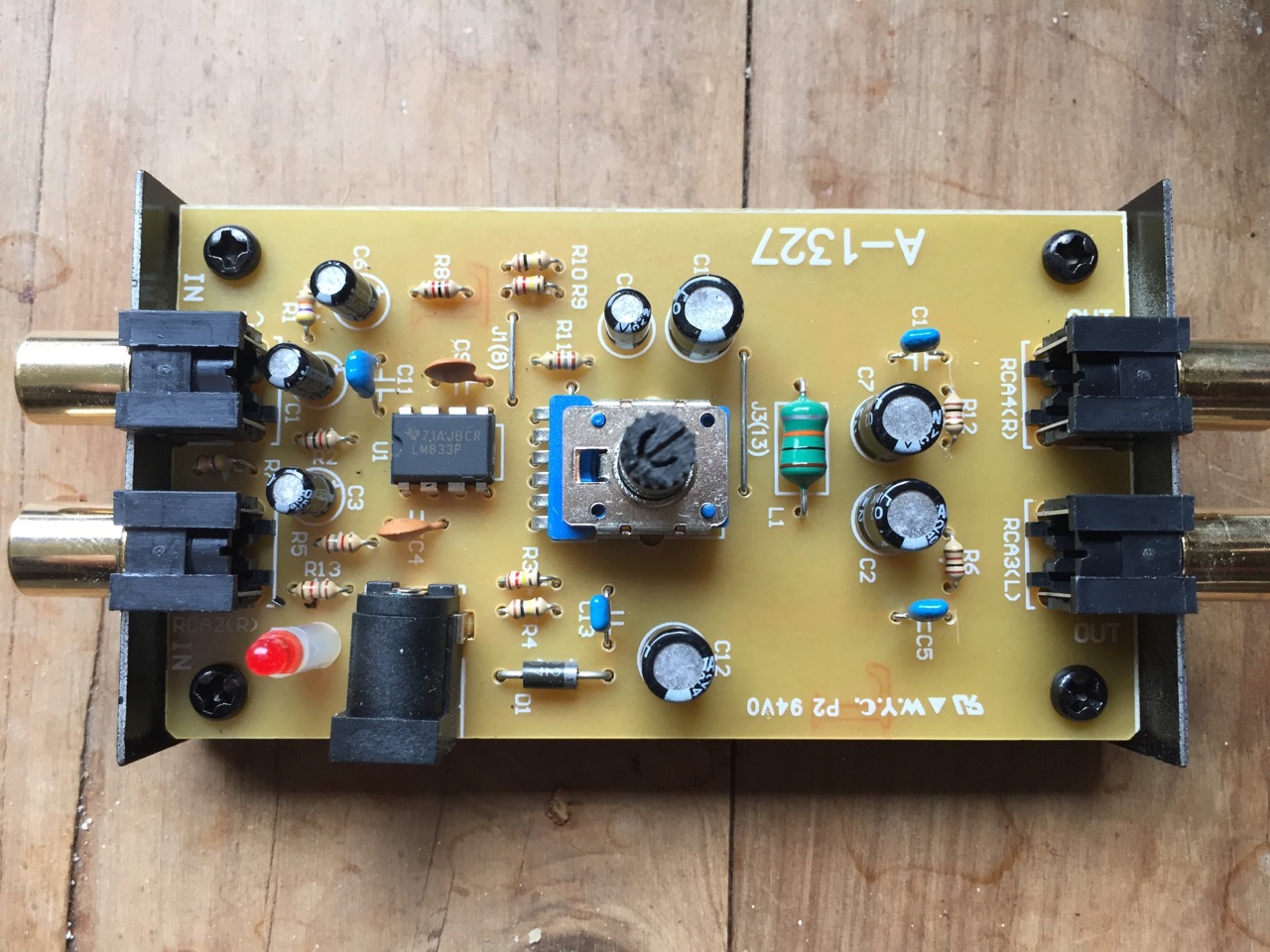

I solved a similar problem from my TV line out with an inexpensive stereo line preamp (booster) that runs on 12 volts single ended supply and has variable gain up to 15dB. It doesn't produce a balanced output, but that is not important for your setup, just wire the preamp output ground/shields to the (-) input terminal only as above. This is the one I used (price is $AU):
Pro1327 Stereo Audio Line Preamp with Gain Control 0-15Db | KG Electronic

I haven't measured the Pro1327 line preamp, but I'm fairly fussy when it comes to audio. I did think I when I got it I might upgrade the op amps and coupling caps inside, but when I opened it up they are pretty good audio wise anyway (or have fake labels!) so I didn't bother. In my system I have only noticed sound improvement from gain optimisation; no degradation from insertion in the signal chain that I can hear. I am using it to listen to broadcast TV and Blu-ray concert recordings from my Loewe Individual TV through my seriously good (IMHO) HiFi system and it is up to the application. I'm sure it's good for your application as well.
LM833 op amp and Jackcon caps. The unit isn't high end audiophile grade, but the circuit isn't rubbish and the application isn't high end either. I wish you hadn't asked this 'cos now I've got the upgrade bug again on something that was working perfectly. 😱

I do have a selection of a dozen or so different high end op amps and all the miniature WIMA MK4 film caps 100n up to 2.2µF in three different pin pitches, plus most values of Muse, Fine Gold, Tonerex, Silmic II and Cerafine capacitors in stock as I do a lot of hifi upgrades for clients. When I got the line preamp I inserted into my reference system and decided I couldn't hear any degradation, at least not during a casual listen. YMMV of course!
