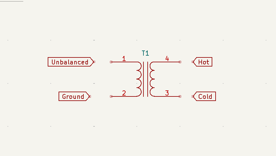

I am confused about what I need to do to go from an unbalanced line connector to a balanced XLR line connector.
I am not looking for ultra-pro audio performance, just the basics. I am trying to output 5.1 / 7.1 sound over XLR from a $32 StarTech USB converter box that only has 1/8" stereo output connectors.
This is for movie-like surround sound in a gymnasium using powered XLR speakers.
A direct wire is probably good enough if I keep the unbalanced part of the cable as short as possible, but it seems that an autotransformer is needed to properly center-tap the ground wire for the twisted pair XLR cable.
Is just a straight 1:1 ratio center-tap audio autotransformer / balun needed to properly balance the XLR output?
I am trying to find a part that I can look up on DigiKey / Newark, or hopefully a preassembled cable with the autotransformer already included.

Use an isolating transformer to reduce earth loop hum.
Something like; https://uk.rs-online.com/web/p/audio-transformers/8513686/
as an example. Cheap but good quality.

Thanks, and yes I see from the spec sheet, it's a straight 1:1 600 ohm center-tap isolation transformer.

Try first with the middle XLR pin (inverting input) connected to ground.
That should work fine with short cables.
If You hear buzzing when HDD spinning or mouse moving try a laptop with an ungrounded PSU.

Get a 1/8" plug, an XLR, and some clip-leads. About 9 out of 10 times there is a simple direct connection which works flawlessly. Because there are more than 3 possibilities, try-and-see is quicker than thinking.

Forgive the thread necromancy, I have a similar question.
It is unclear if this linked TX is center tapped? Also I'm not seeing any answers the OP's question, can you use a 1:1 CT tx to balance an unbalanced line?
IE PRI: Sig +/- and SEC: H/S/C (Hot Shield Cold, or Non-Inv/Shield/Inv with the shield (pin 1) only bridged to top connector ground only at one end of the XLR cable, then reverse at the other end to get a line level at the other end of this "closed system" run.
If you're trying to connect a single-ended source to a differential input, a pseudo-differential cable could be the ticket: https://neurochrome.com/pages/pseudo-differential-cable
