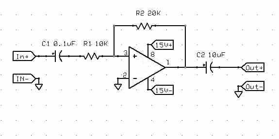

I was just thinking about this earlier, is it this simple to make an unbalanced line driver? This should result in a 2X increase in voltage (say an input of 2V resulting in 4V) right? Do I need any other parts except for the cap to prevent the op amp from oscillating? What would be good op amps to use here, the standard NE5532, NE5534, Burr Browns, etc.?

that won't work, as listed it isn't stable. a positive input voltage will create a positive output which is fedback. you need to attach to the negative terminal if you're going for an inverting amplifer.
Thanks, I'm still trying to remember all my physics. It's been a while. So I should basically swap the connections on pins 2 and 3 right?
No, the non-inverting configuration is different than the inverting.
try this link:
http://www.leapfrogsw.com/noninverting.php3
your gain changes slightly, it's now 1+R1/R2 so you'll actually want to make your Resistors the same value.

Thanks Azira, I was trying to make a non-inverting circuit, and the link you gave me helps me a lot. Thanks so much to everyone.

actually it's funny how if you use the simplification assumptions, it doesn't matter which terminal is + or - it still works out to be an inverting.
