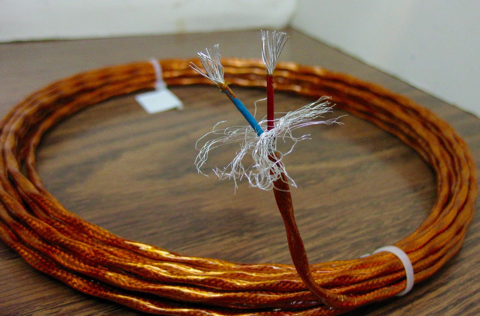

When Ive built interconnects using shielded twisted pair I've used one conductor for the center pin. The other conductor to the outer solder lug and the shield connected to the same lug at one end only. I'm not claiming I used ANY electrical smarts about doing that but it seemed to work OK.
The wire closely resembled this:

Shielded twisted pair is popular for unbalanced too. I am not sure why. It will work fine when one end (typically the source) is electrically floating e.g. MM cartridge. When both ends are grounded, as for a typical interconnect, then you really need a low resistance return conductor - which a shielded TP does not give you. Fortunately audio is uncritical about such things so the wrong cable will often work sufficiently well for some people to proclaim that it is better than the right cable.
Wouldn't noise in the shield be coupled to the "hot/flow" of the twisted pair?When Ive built interconnects using shielded twisted pair I've used one conductor for the center pin. The other conductor to the outer solder lug and the shield connected to the same lug at one end only.
