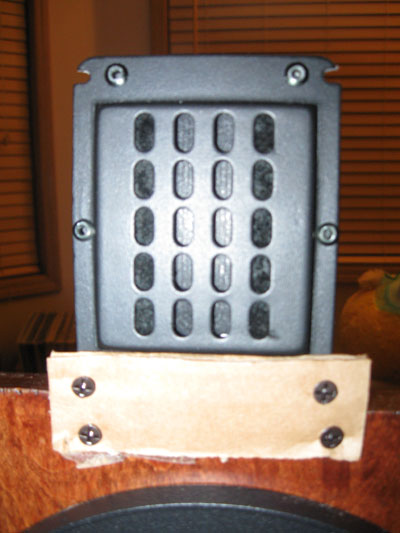

This is the normal Neo3 tweeter.
What lower frequencies do you mean? The main EQ's I did are notching of the Peak around 13 khz for the Neo, lifting its roll-off below 2.5 khz, a notch on the dipole peak of the AL170 (-13 dB at 1.5 khz) en 6 dB/oct lowpass on the woofers to equalize dipole-loss.
Thanks, what I meant was the "lifting its roll-off below 2.5 khz". Your description is excellent. It seems I have a pair of tweeters to purchase 😎
What is the physical difference between normal and PDR version anyway? Does the PDR use some form of phase shield?
I'm not sure about the difference between the two, but I think it is just that the PDR uses some sort of felt padding at the edges of the membrane as to make it acoustically narrower at higher frequencies, while the lower frequencies are affected to a lesser degree. There might be more, though.

The Neo3 PDRW has felt covering the outer 1/2 of the driver's radiating width, the idea being to have a narrower radiating area at higher frequencies. In the sims the Neo3 has better CD, but a narrower response at higher frequencies. Hopefully keyser will get to run direct measurements comparing the two. So far, he's been able to get better results with the Neo3 than I have with the PRDW 🙂

About the differences between Neo3 and Neo3PDR:
I've used the PDR without a baffle for some time, but around 7 kHz there was an interference dip on-axis and a peak at 45 degrees. The treble was very sensitive to changes in listening angle.
I've been using Neo3 without a baffle for about 6 months now, which has nearly perfectly solved the problem. The Neo3 is definitely the better choice, the difference is audible.
It also has a slightly higher sensitivity, which could alleviate thermal issues (which could be a problem according to Linkwitz).
I'm not sure if I still have comparable measurements... if I can find something I'll post it here.
