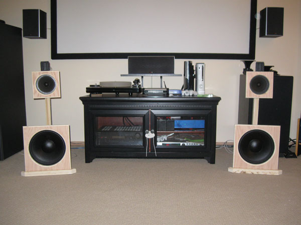

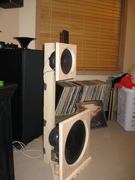

It's interesting to see these designs that are somewhat similar in concept 🙂 Here's what mine currently looks like:
attachment.php
attachment.php
I don't have saved measurements of the full system yet, and I'm still playing with the crossover. Drivers are B&G Neo3PDRW, Audax PR170M0, AE OB12, crossover is a DCX. The bare PDR has a diffraction null around 7kHz that I need to try and address with foam, and I also need to think about how to move the tweeter back to better align it with the midrange acoustic center.

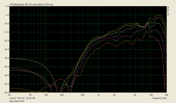

Actually, I have some measurements I can share:
'Nude' Neo3PDRW:
attachment.php

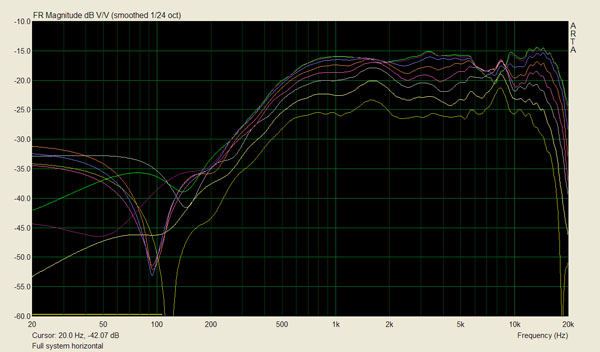

The full system polars from an earlier version. The bass drops off due to the gating. I didn't try to boost the 7kHz null, since that'll make the off-axis worse. I'll play with foam / felt and see what I can do. I think I ended up dropping the tweeter level 1-2dB after listening to this for a while.
attachment.php

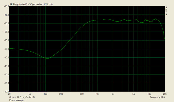

And the power average of the previous measurements:
attachment.php

Saurav,
Looking good! Your plots show a small off-axis bump between 1 and 2 khz. The tweeter seems to be at blame. All in all you've been able to maintain CD from midrange to tweeter very well, though! Counting the number of curves in each plot I haven't been able to make sure which curve represents which angle. Would you please clarify?
