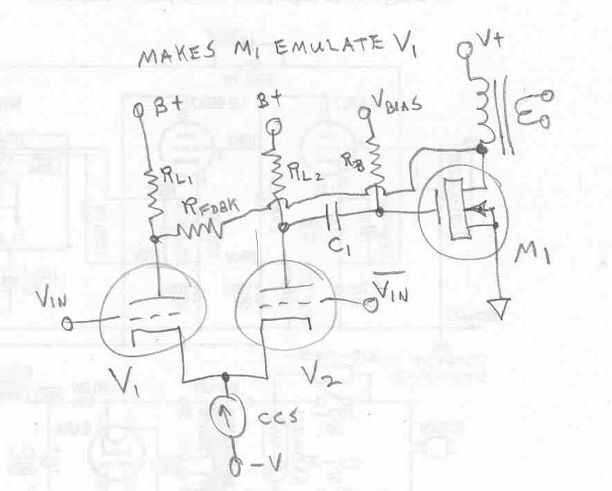

Instead of trying to find some power tube with good and use-able triode curves, you can just use emulation as below. The device M1 can be a power tube (Mosfet shown), and the _LW6 tube would be a good one there. The resulting triode curves however will be matching up to those of tube V1.
It's a simple N Fdbk loop that insures that the final output looks like the Mu of V1 (times the input signal) or else the N Fdbk fixes it. Having a tube with already good triode characteristics for the output just makes the job easy for the N Fdbk. The output tube doesn't even have to be in triode mode, since it is the relaxed spacing between grid1 and cathode that gives the tube its good transfer characteristics for either triode or pentode mode.
Tube V2 would best be a high gain tube for high loop gain for the N Fdbk, and could be either a triode or pentode. More loop gain being helpful if the output device is not reasonably matching the "emulant" tube V1. Especially if M1 were a Mosfet. The higher loop gain will also greatly reduce the final output impedance for a better damping factor.
The whole scheme can be extended for P-P use as well, just use the same setup for each P-P side, with a splitter ahead of the V1 tubes then. The inverted Vin to tube V2 being optional, just DC bias.
With some socket flexibility for the V1 tubes, one could bring tube "rolling" to a whole new level. A variable CCS tail knob adjustment and an oversized V2 tube (like a 10 Watt 12HL7, 21000 gm) would allow the "emulant" tube operating point to be selected for small to big tubes. (possibly needing Gyrators for the V1 and V2 plate loads, or else adjustable RL1 and RL2 loads)

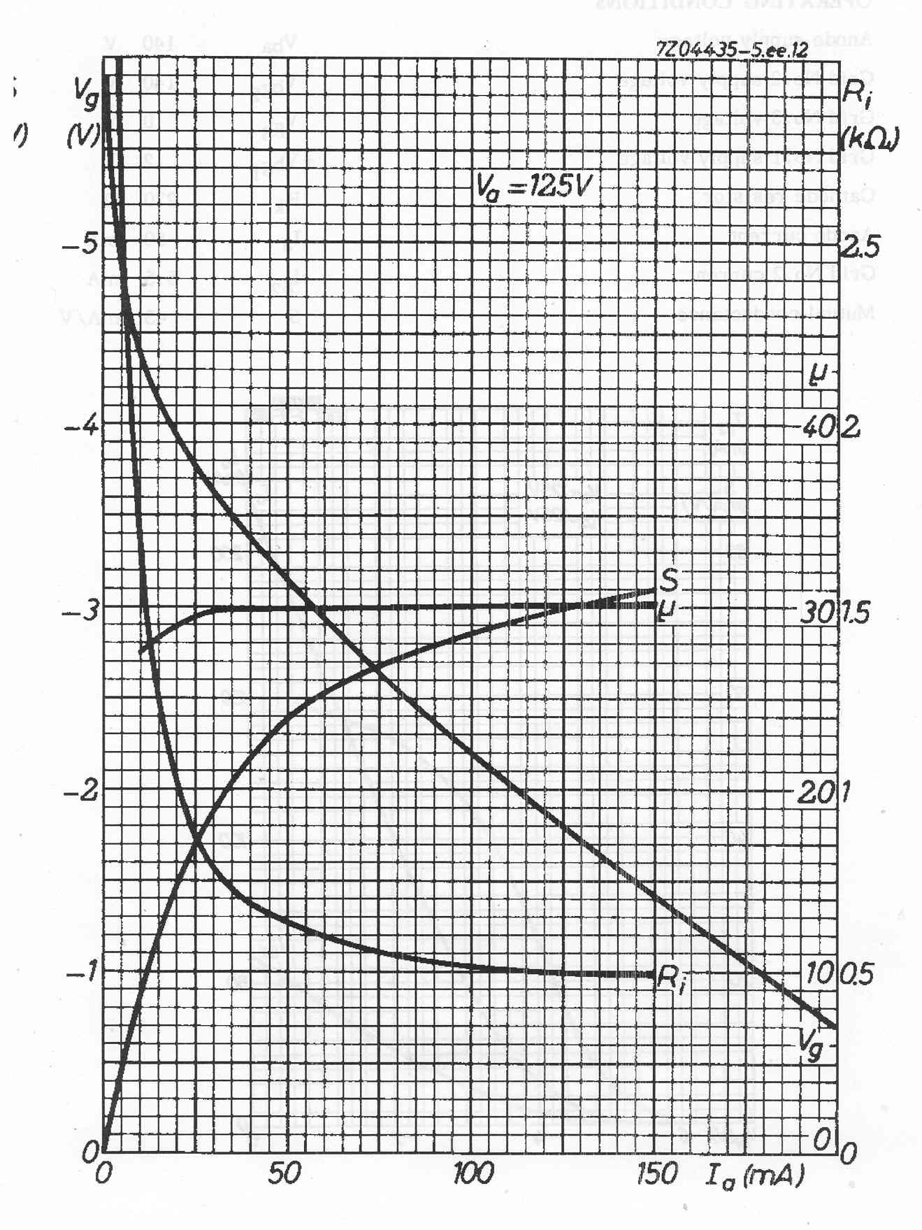

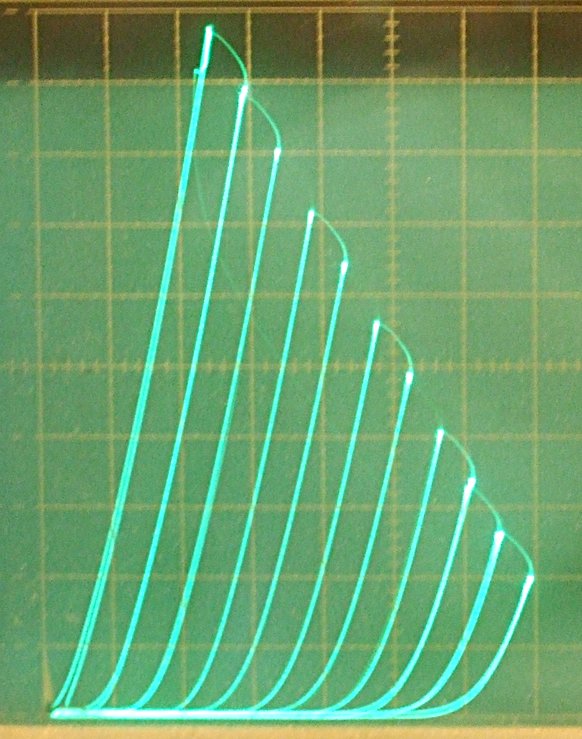

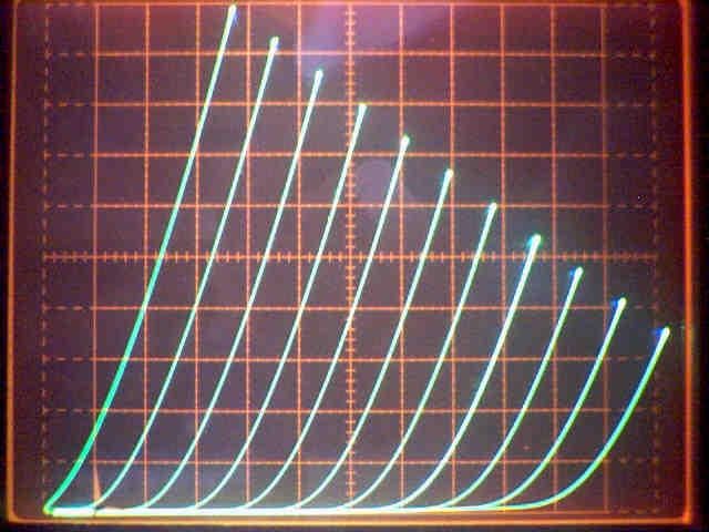

Some cheap emulant tube candidates (pic 2: 1E7G and pic 3: 12HL7):
Well 300B could be used too, but why bother.
Of course, if you already just happen to have two 300B tubes on the shelf, they could be used for the M1 finals. But they require fairly excessive grid drive levels.

Sorry for being a little off topic. The emulation scheme has been mentioned many times before in the past, not sure if any were in a thread strictly about it. It just solves so many problems that always come to the fore when power pentodes in triode mode are discussed.

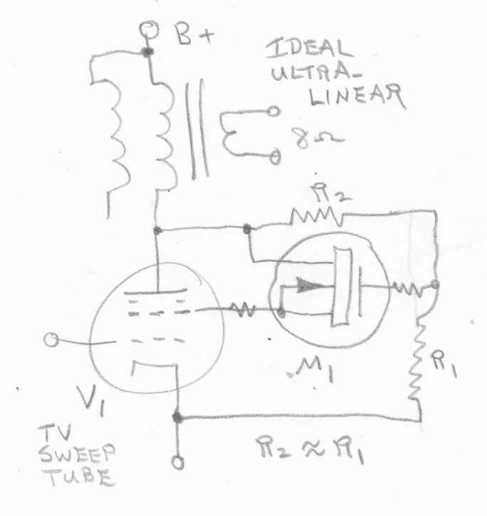

Another approach for using the _LW6 in "triode" mode (triode curves resulting) would be to use a reduced voltage UL scheme. Just an R divider network from plate to cathode, driving a Mosfet (or tube ) follower, which then drives the screen grid. So a UL mode resulting, but with the screen V always below the plate V. (for tube health)
Could also use the UL taps on the OT for the source V's for the R divider networks (P-P).
If, say, 50% of the plate V appears on the screen, then the tube's internal Mu will be doubled effectively. (and the output Z doubled)

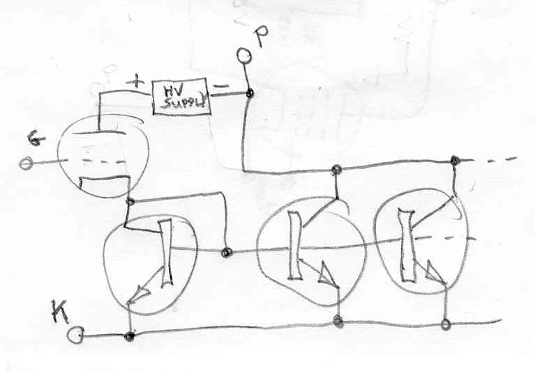

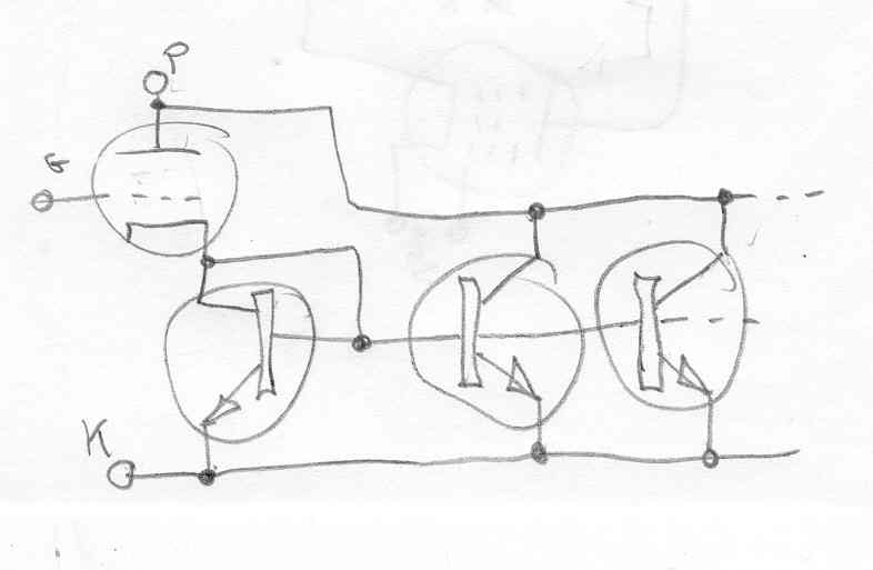

Here's another one:
The Tube Mirror.
Make a small tube into a BIG one, triodes too. Good for OTL.
Provides N x the current output of the original tube.
And a somewhat similar scheme, using a pentode to increase the current output of a triode. Requires getting the current start-up states equalized via bias and screen V selection (for similar current tracking).

The Tube Mirror.
Take that one one step further. I used Mosfets for the mirror because I had some.
Use a suitable "ideal" triode for the input tube. Load it's plate with a suitable load for the tube being used used. I used the big side of a 6EM7 with a small 5K OPT with a resistor across its secondary. Apply the usual fixed bias to its grid.....I used a mosfet follower PowerDrive style. Ground the mosfet sources. Tie all of the mosfet gates together with the drain of the input mosfet as in a typical current mirror. Tie the drains of the "mirror" fets together and connect them to the cathode of a suitable BAST, then apply a fixed negative voltage to G1 of the BAST a suitable positive voltage to G2, and connect your real OPT to its plate. The OPT can be fed by a much higher B+ than the little input triode.
Note I had this working with the large side of a 6EA7 triode and a 6GF5 pentode. The mirror was made from 5 identical mosfets so that the 6GF5's plate current "mirrored" the 6EM7's plate current except multiplied by 4. I used these tubes because I had a bunch and didn't care if I blew any up. It worked good.
I tried to scale it up to a 45 triode and a 6HJ5 (6DQ5) pentode with disastrous results. Mosfets and tubes exploded. I put it all on the shelf and gave up.
Later experiments with a totally different experiment followed the same path.....worked good on small tubes, blew up on big tubes. That's when I discovered that some of my 10 ohm sense resistors were really 1 ohm.
I'll get back to these experiments sooner or later.

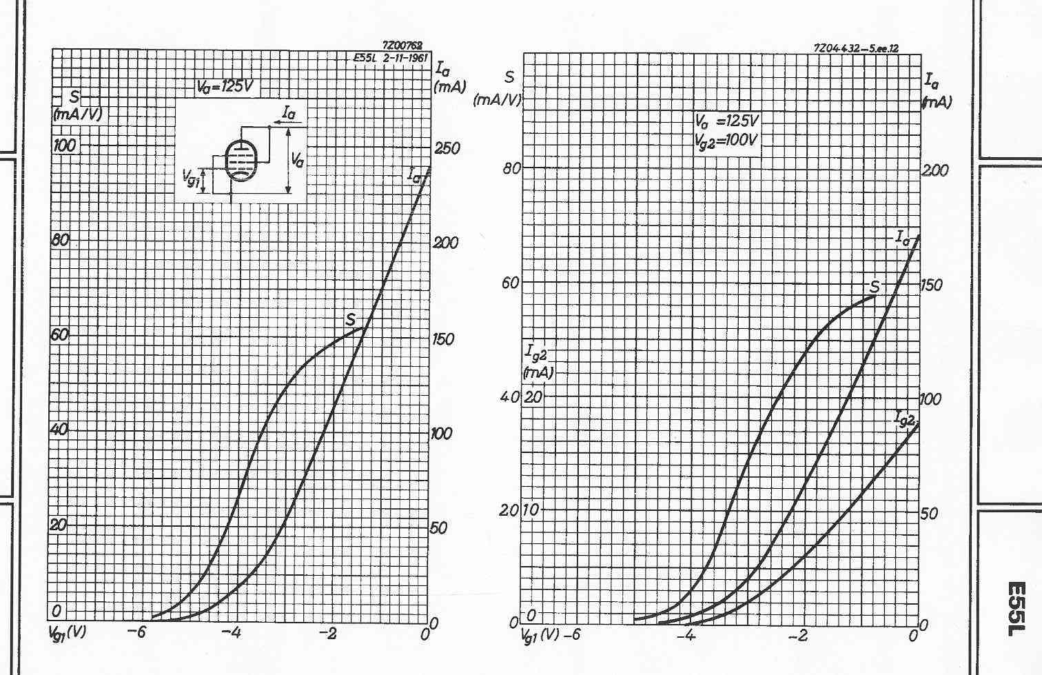

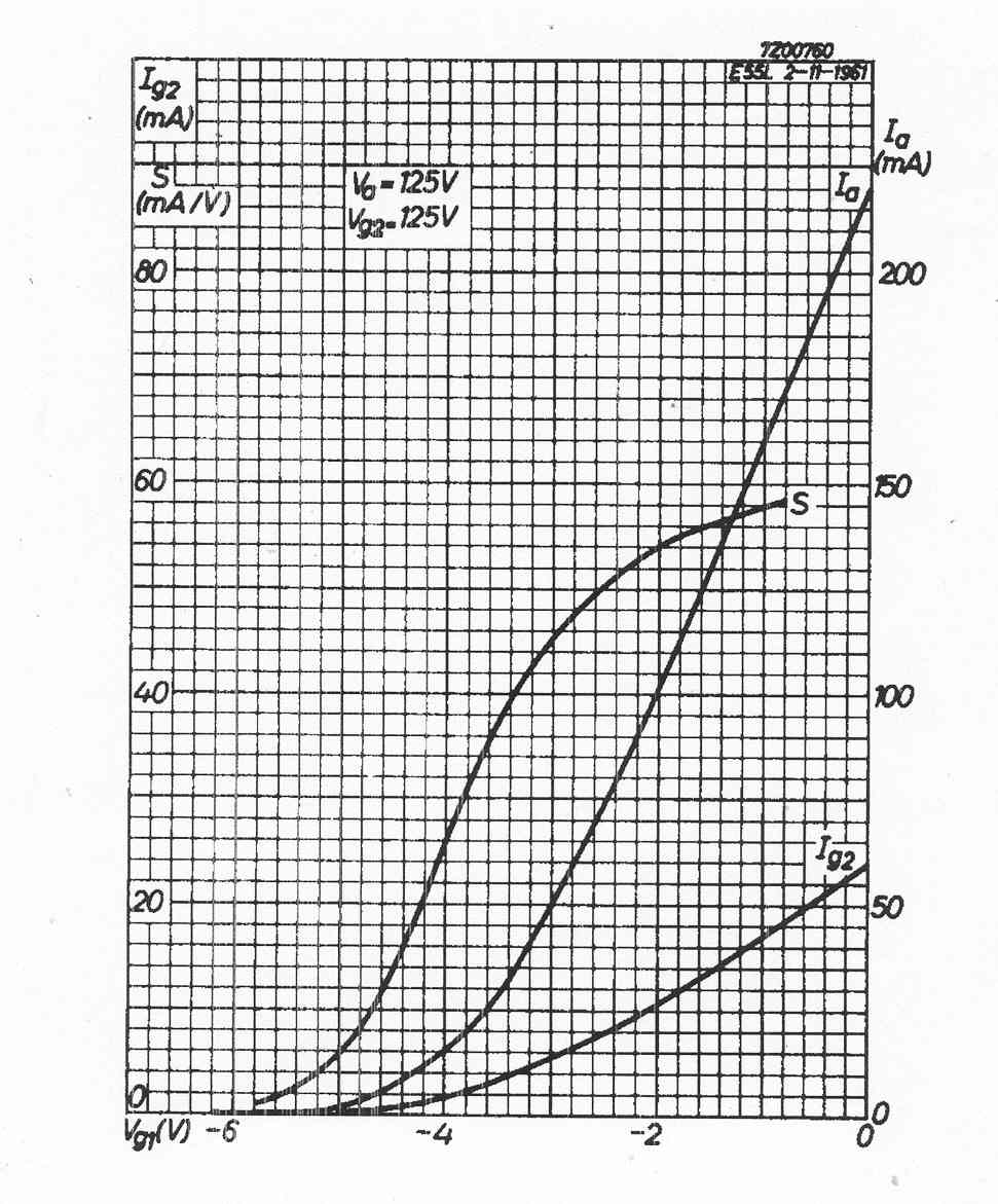

Actually, it's not that easy to find ANY tube (pentode or triode) that is all that "linear" due to gm being optimized (maximized) for most of the later tubes. To get a "linear" triode, the grid 1 needs to follow a 3/2 power law (V to I) like the plate (so tracking). But most tubes have the grid 1 positioned closer to the cathode to get maximum gm, which causes grid wire proximity effects, or "island effect". (inselbildung) That causes grid 1 to have a mostly 2.0 power law, which mis-tracks with the 3/2 power plate or grid 2 internal N FDbk, causing Mu to change with current.
The gm curves given for some tubes gives a good illustration (below, the S labeled curve). Gm being the first derivative of current (versus grid voltage), a 2.0 power law tube will have a linear ramping gm curve (versus grid 1 voltage). What you usually see is a stretched out S shaped gm curve. Indicating higher than 2.0 power law at low currents, near 2.0 power through the mid range, and less than 2.0 power law at high currents, where the cathode is saturating.
The frame grid E55L seems to get excellent grid 1 and grid 2 tracking somehow (constant Mu), and still have a 2.0 power law in the mid range. If grid 2 is spaced (wire pitch) correctly, I guess, one can equalize the "island effect" for both grids.

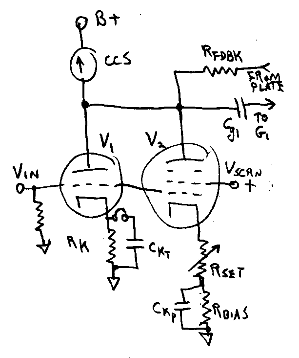

On a side note, I once observed the power law for the various grids of some Sweep tubes (measured the curves and then did calcs.), and noticed that grid 2 sometimes had a V to I power law -below- 1.5 !! This seemed odd at first, but then I realized that aligned grids meant that grid 1 wires actually could produce an inverse "Island Effect" by shielding the grid 2 wires where they are closest to the cathode surface.
This actually makes the internal triode mode Mu vary even worse than expected than grid 1 wire proximity effects alone would lead one to expect. Getting a 2.0 versus 1.3 power law mis-tracking. Which may explain why beam pentodes (tetrodes) often get a reputation for having poorer triode (mode) characteristics than real triodes. ( A frame grid 1 and normal grid 2 should eliminate this deleterious alignment effect)
Taking a que from Crazy/Twin drive, is there some way to put this weird effect to better use? (using 2 grids at once, in some way)
1) For grid 2 drive, we might be able drop the grid 2 power law fully down to unity if the grid 1 shielding "anti Island Effect" could be enhanced further. So maybe put a small anti phase V drive to grid 1, while mostly high V driving grid 2. This will however require higher grid 2 drive to get to full power. Not real good.
2) Or, using a sweep tube with a low Rp plate for triode, we might try some in phase drive on grid 2, while mainly driving grid1, to bring the effective ( [1.3 + 2.0] /2) power law of the combined grids down to near 1.5 power law to match the plate's law.

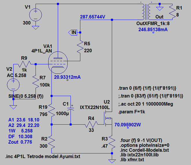

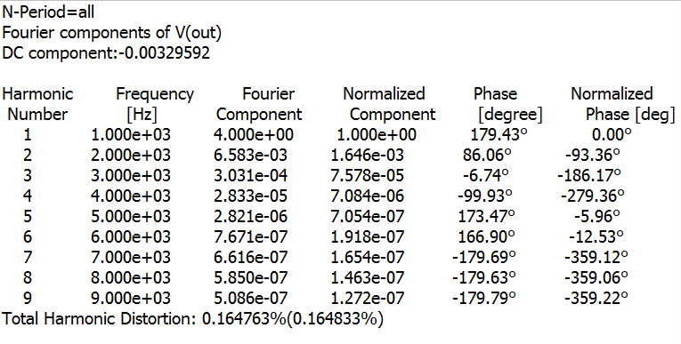

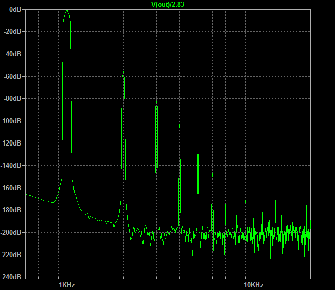

Availability of 1000V+ SOT227 devices with max. dissipation of 500W+ with reasonable gm opens opportunity such as Hybrid STC. Confirmed in spice, 20W of A1, 30W before clipping at A2, DF 10+ and Zout < 0.8 ohm at 0.164% THD (1 kHz 1W), 70W Mosfet dissipation.
Expensive, big, hot, heavy, tiny glow and no big bottle appeal. Un-Holy enough? 🙂
I may try more friendly 10-15W version but this one is Tubelab's territory.
