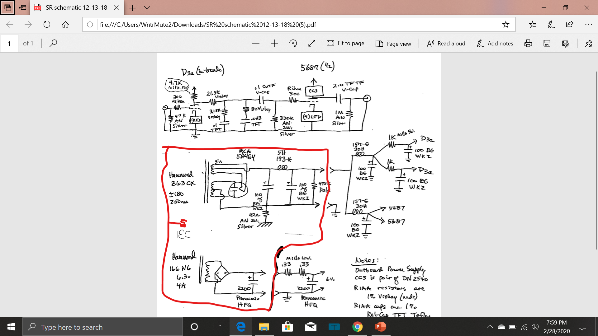

I'm almost ready to wire the two chassis together but I am realizing I don't see a way of safety grounding the two chassis together without a ground loop being created. The schematic shows the power supply outlined in red. I tried to indicate that there is an IEC connector with the safety ground next to it. Everything else is in the signal chassis. I will have two separate umbilicals with 4 conductors in each one (Canare 4S11 star-quad). All of the triangular ground symbols are to the ground bus and the flat-topped ground is to the chassis in the power supply.
The bus in the signal chassis will end up grounding to the turntable ground at the inputs.
Suggestions as how to tie the two chassis together would be appreciated.
