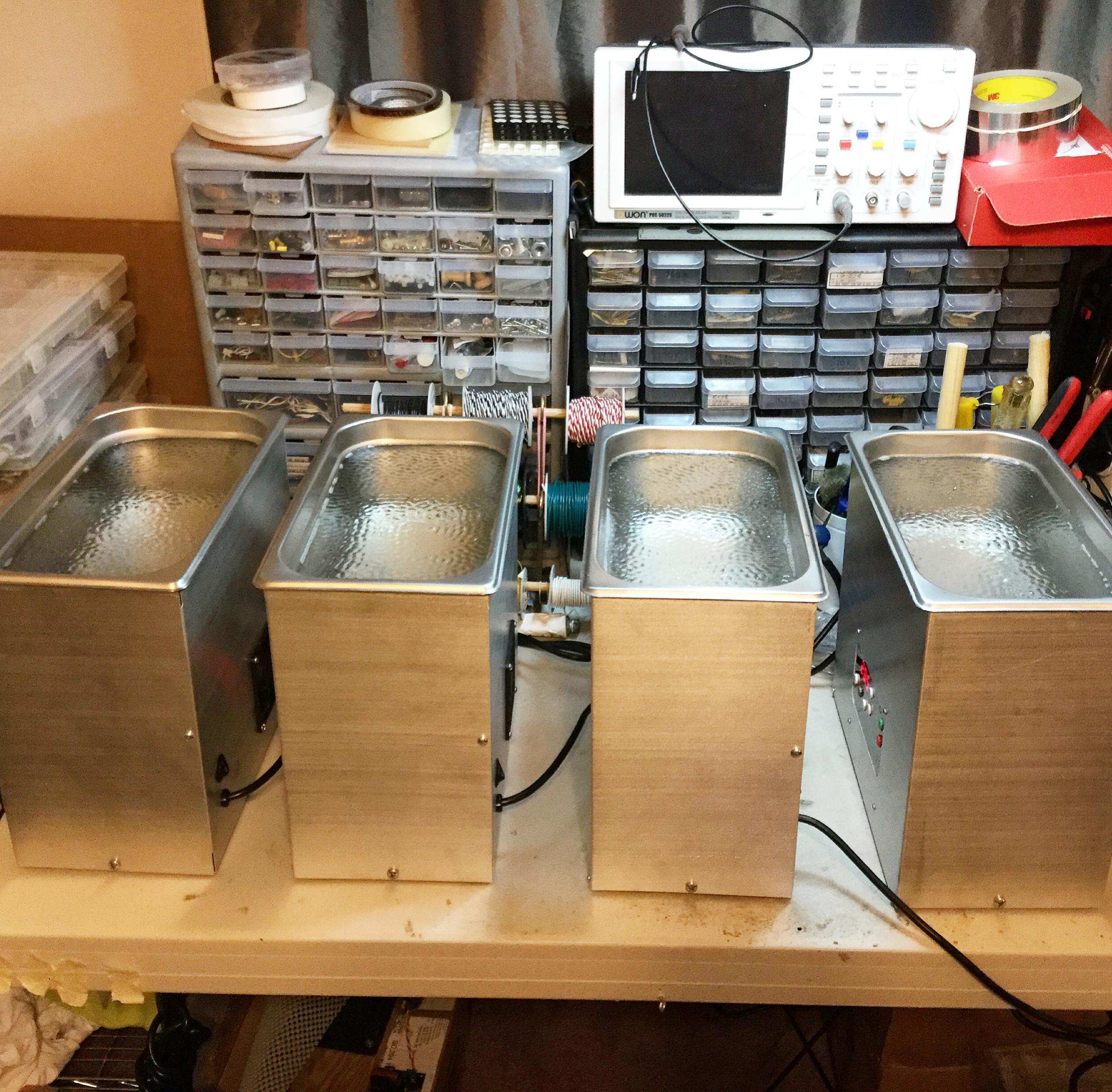

Also, I should have four 80khz ultrasonic cleaners completed by the end of this week (Feb 3, 2017).

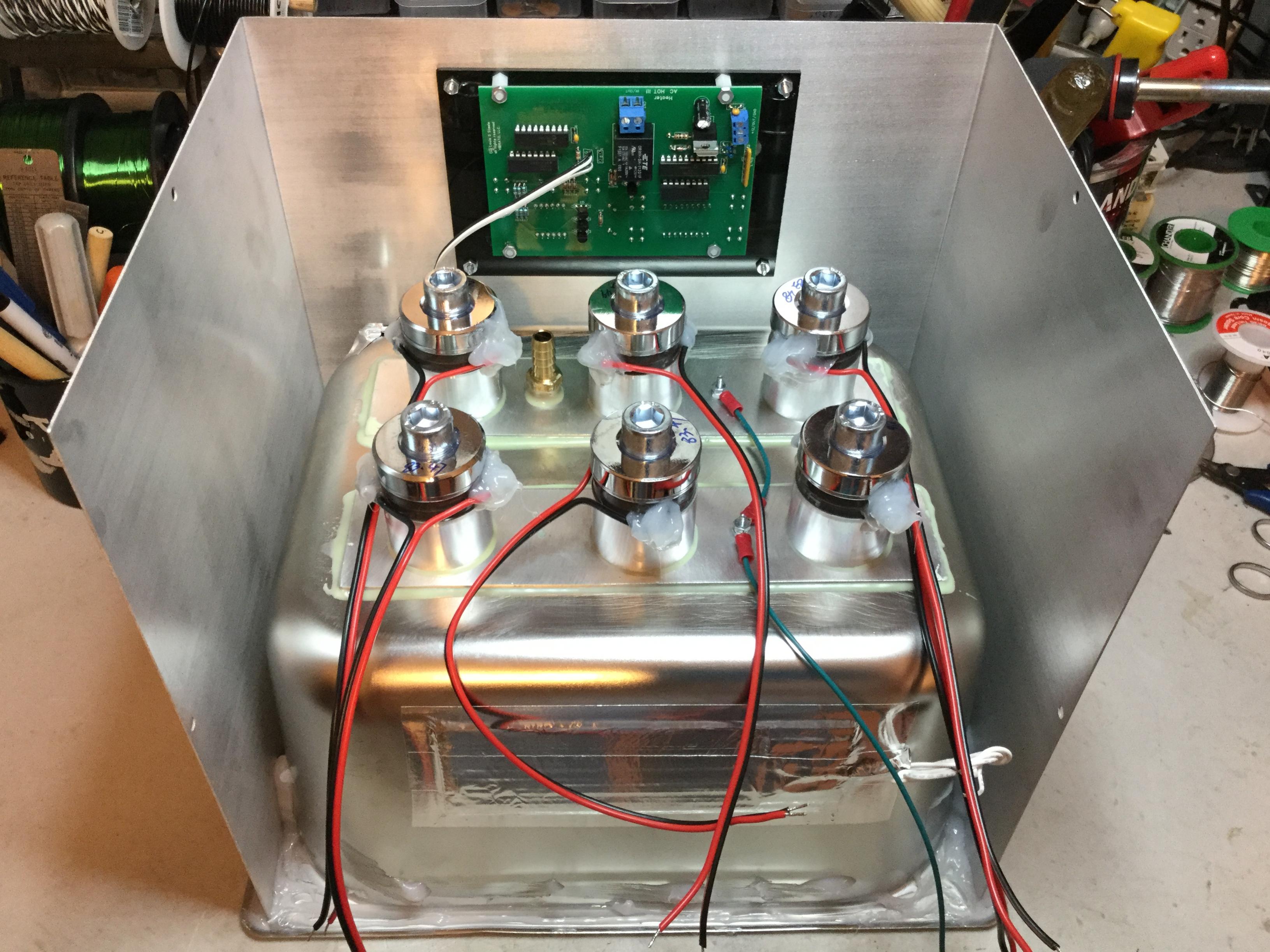

Last month I received an email asking if it was possible to modify one of the inexpensive Chinese-built Ultrasonic Cleaners to work at a higher frequency.
To give an informed answer, I bought a 6 Quart 40khz Ultrasonic Cleaner from AliExpress for $124.00 US.
Upon arrival, I heard noise from inside. As the photo I attached shows, one of the Transducers had been knocked off during shipping. I contacted AliExpress and was offered the options to either return the the unit and receive a full refund, or keep the unit for a partial refund. I opted for the partial refund ($24.00).
I was able to epoxy the transducer to the tank and it is now functional.
As evident from the photo also, is that the Transducers are welded to the tank by a retaining screw, which means it would be impossible to exchange the 40khz Transducers for higher frequency transducers without damaging the stainless-steel tank !
Also, it would require much experimentation / trial-and-error to modify the circuit to run the 40khz Transducers at a higher, harmonic frequency, because the output transducers are driven by a "feedback/current" toroidal transformer. This would require taking off/adding wire turns of the primary and dual secondaries of the transformer. (Note: Running a transducer at a harmonic frequency will also cause the Ultrasonic Driver board to run very Hot!).
So my conclusion is that it can not be done with acceptable results.
The Chinese Ultrasonic I bought was also heated, however, upon testing the unit I noticed the temperature only rose 0.2 degrees Celsius after an hour !
If you look at the photo again at the bottom right-hand side, you will see a small rectangular object under aluminum tape. That is the heating element ! About 1 inch X 2 inches ! Far too small to heat a tank this size !

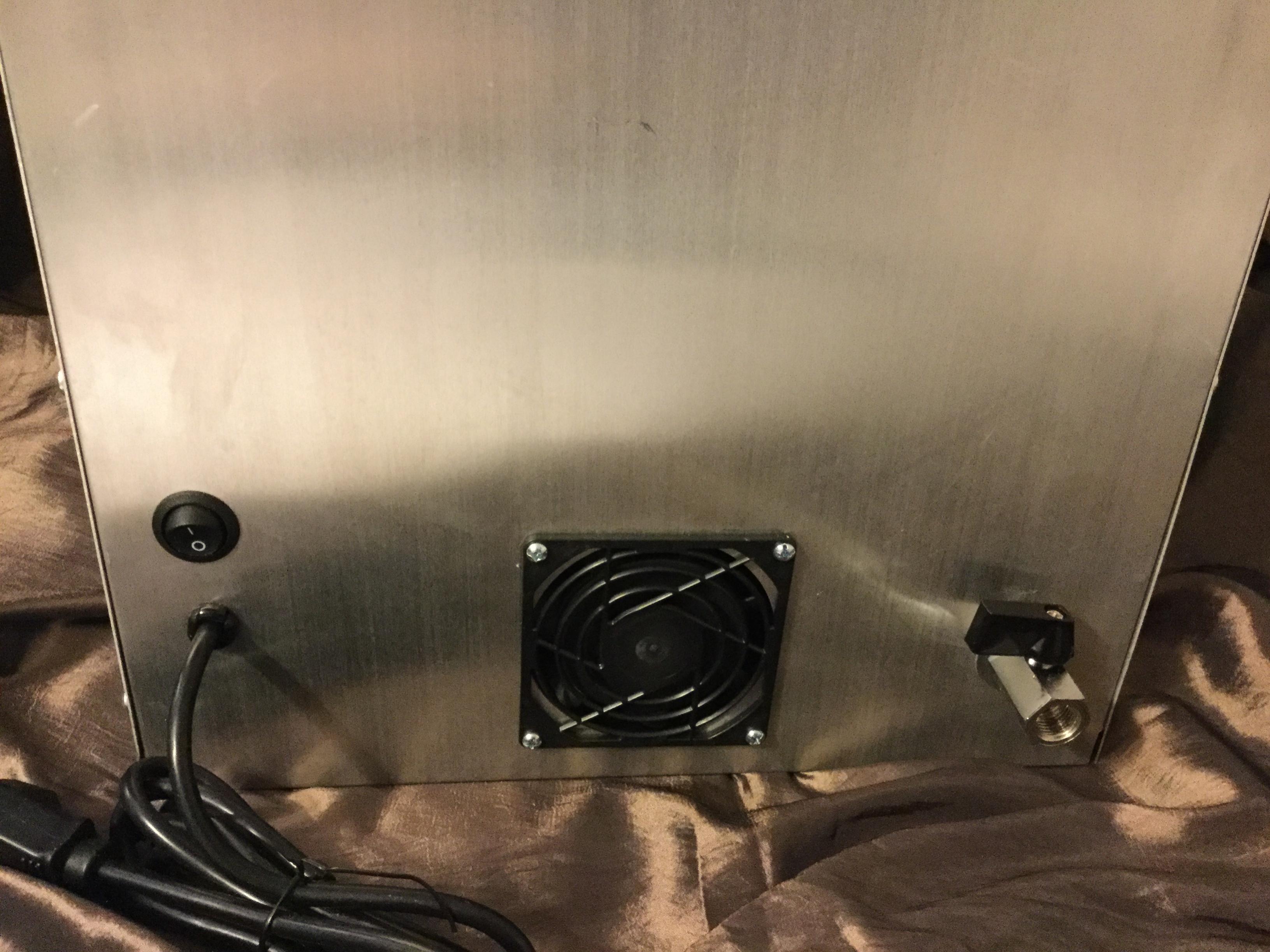

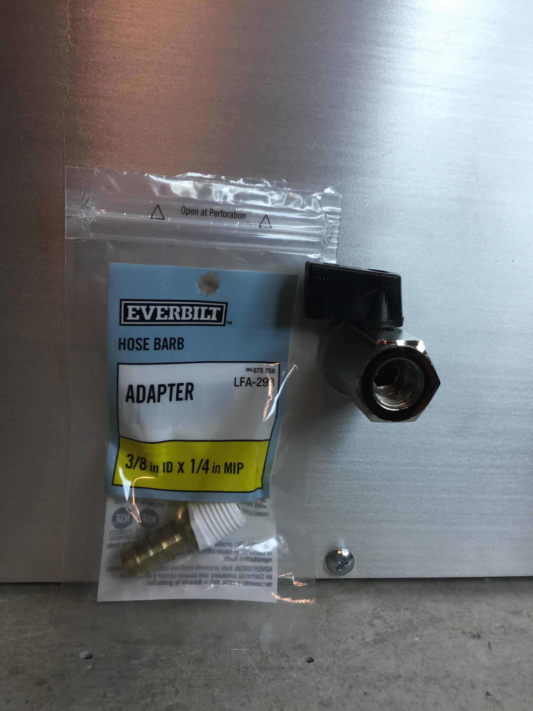

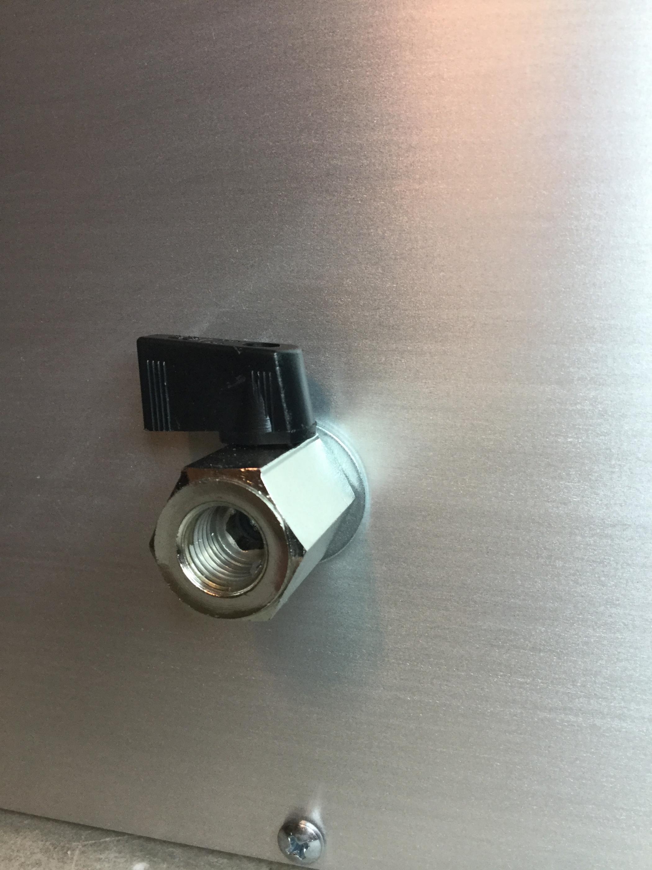

All of our Vibrato Ultrasonic Cleaners are now shipping with a Manual Drain to facilitate our customers needs for adding water pumps and filters !

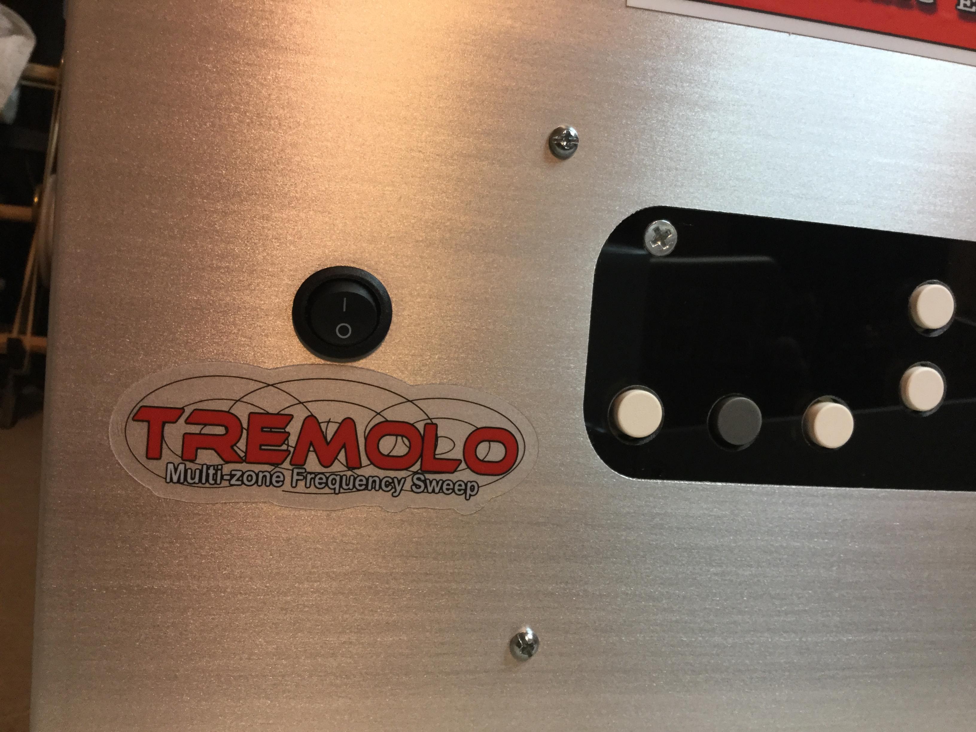

Also, our Vibrato 40Khz, 60Khz and 80Khz Vibrato Ultrasonic Cleaners are now shipping with our proprietary TREMOLO MultiZone Frequency Sweep circuit as a standard feature !

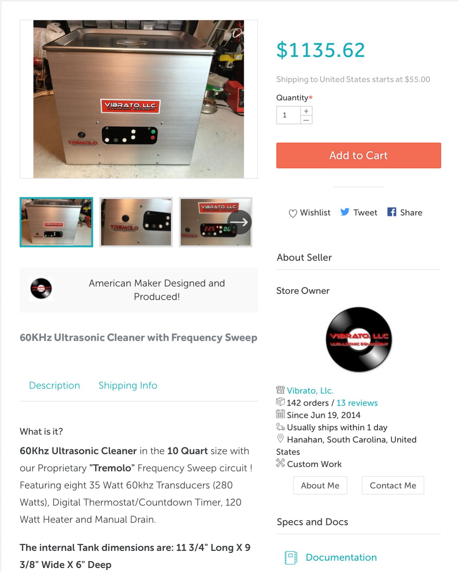

We have added a 135Khz Vibrato Ultrasonic Cleaner to our lineup on our Tindie Web Store.
Be sure to visit the link above and Thank You for your continued support!
