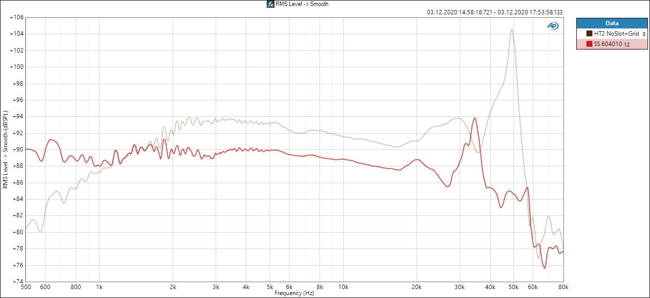

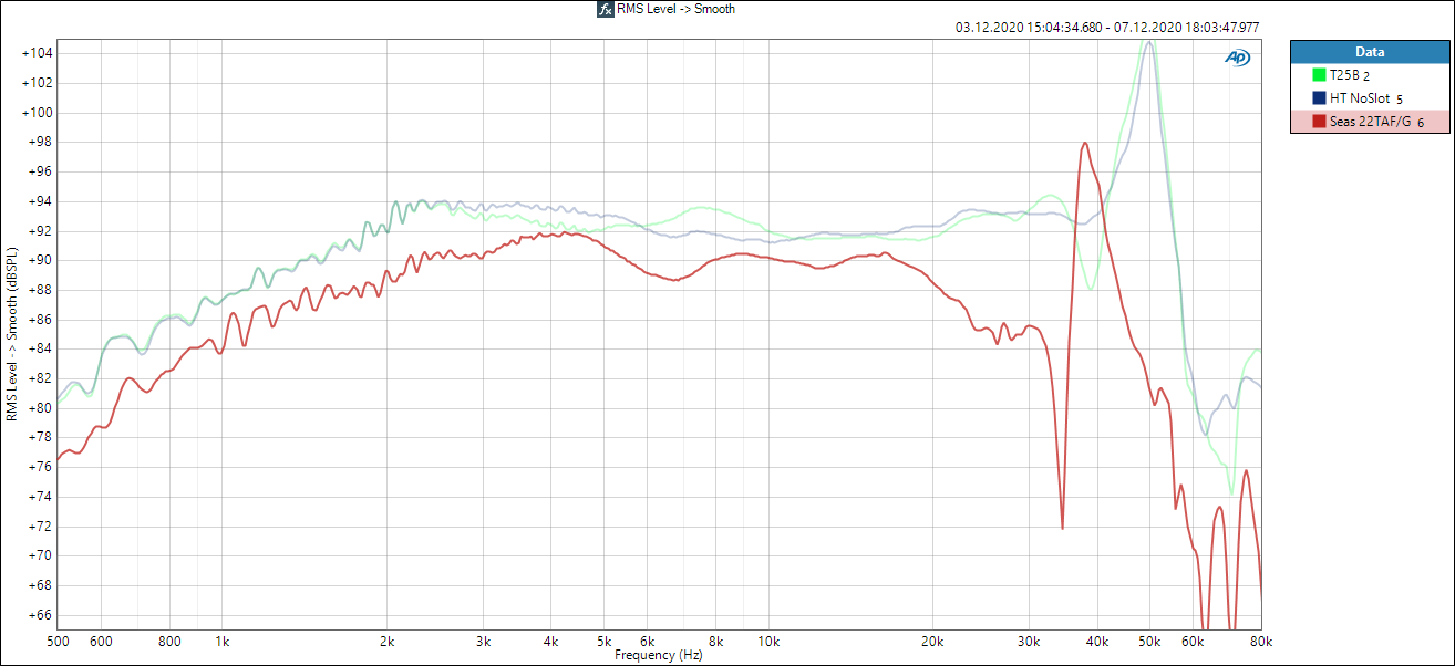

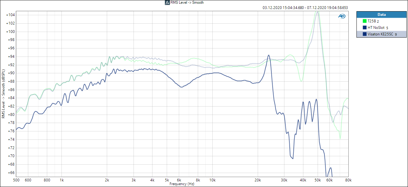

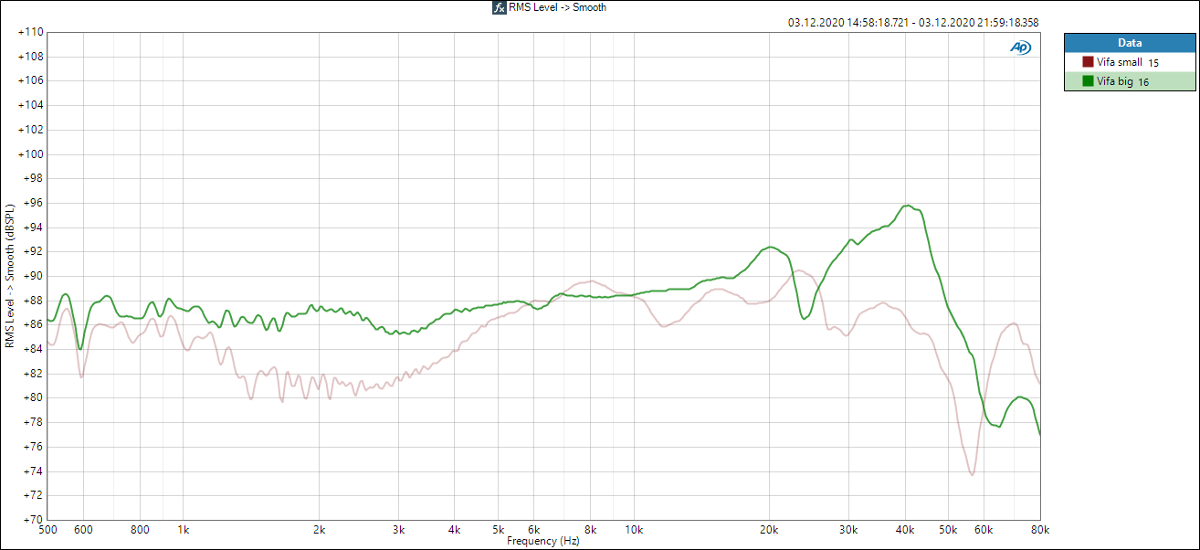

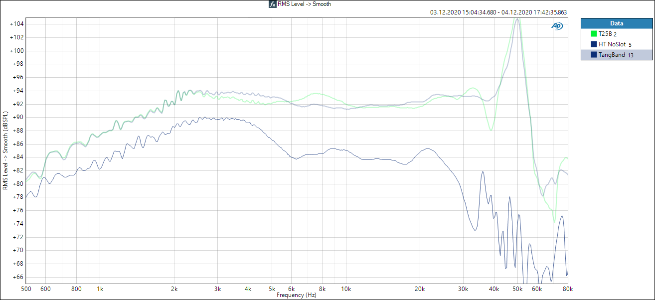

And some HF measurements from tweeters. Some designs do well at very high frequencies like ring radiators but level drops significant.
The graphs are labled which tweeters are measured, hope this is good to read...
600uV vs. 2,83V used here ... that's 73dB less as seen in this graph.
Sorry different scale:
